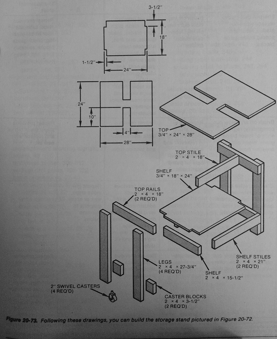

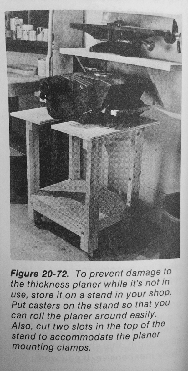

Just in case it's of use: as promised, the plans for the stand (guess it already includes casters!) for the Shopsmith-mounted planer. It talks about mounting clamps, but I'm not so sure mine had those when I got it...

reubenjames wrote:Just in case it's of use: as promised, the plans for the stand (guess it already includes casters!) for the Shopsmith-mounted planer. It talks about mounting clamps, but I'm not so sure mine had those when I got it...
How do you secure it to the SS? Same clamps.

Easy to make = screw and a wooden cross member with dish outs for the way tubes.(2x)

Ah yes, I've got that in my shopsmith book. ;) A simple little table for it. I would definitely be able to make that in a jiffy. I like the little cutouts for the underside clamps so you don't misplace them.

For what it's worth. I bought a Shopsmith mounted planer in the early 80's.
I built the stand you have mentioned here to store it on. The stand makes it much easier to roll to the shop smith to be mounted on it. The height is good and it has a shelf under for storage.Not a bad way to go. Just be sure to put good casters on it. I put cheap ones on mine and it is a little bit of a pain to push it around. As far as the clamps go, they came with the planer. After mounting the planer the clamps just screw into the bottom of the planer from beneath the tubes to secure it. They work well.The slots in the top of the cart are only used if you want to clamp the planer down to it.

The book mentions the slots are there not only to accommodate the clamps but also so you don't rest the unit directly on the clamps, which it advises against.
