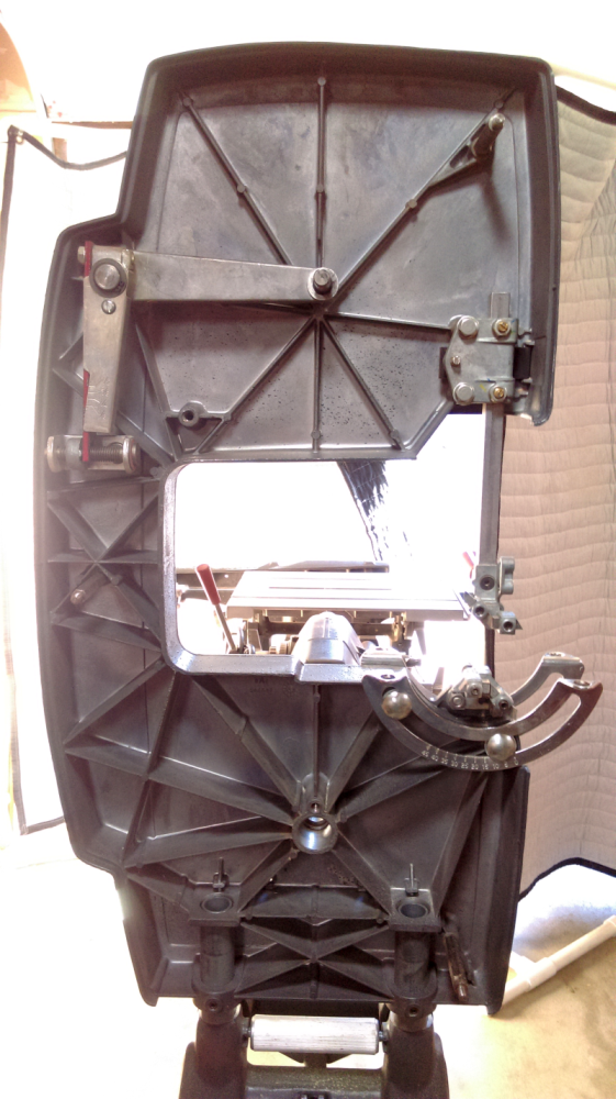

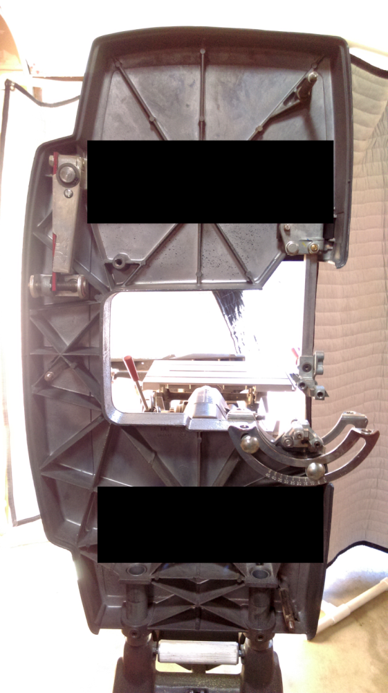

Thanks for your patience. I was able to get into the shop and take some pictures and make a few videos. Here are a few pictures I thought might interest you guys...
First, the 'naked' Bandsaw
Censored Naked Bandsaw.png (574.66 KiB) Viewed 1865 times
Sorry, couldn't resist.. here is the actually wheeless bandsaw, though I'm sure you all know what it looks like...

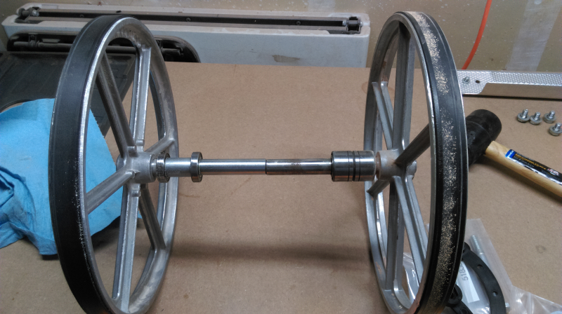

I noticed the difference in the axle types when I first got the new wheels, but in case you haven't seen them. The old type is on the right.
Two Axle Types.png (540.95 KiB) Viewed 1865 times

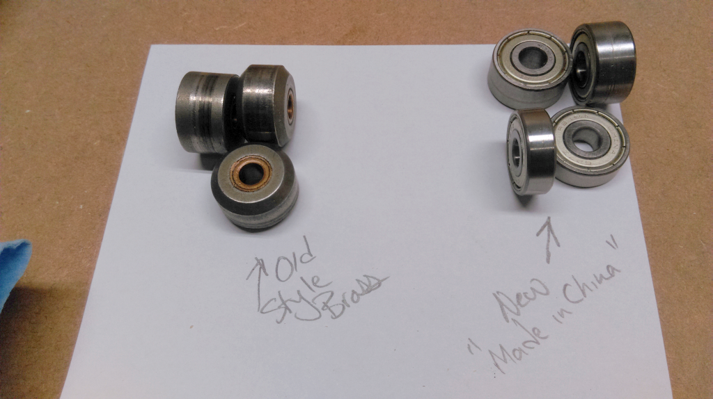

Also, here is a quick image of the bearings. To switch things up, the new ones are on the right.

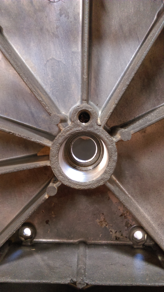

Now, before moving onto the vids, I just wanted to make sure that you guys saw the bottom tires 'slot'. I don't see any issue here...
Axle Opening Closeup.png (874.28 KiB) Viewed 1865 times
