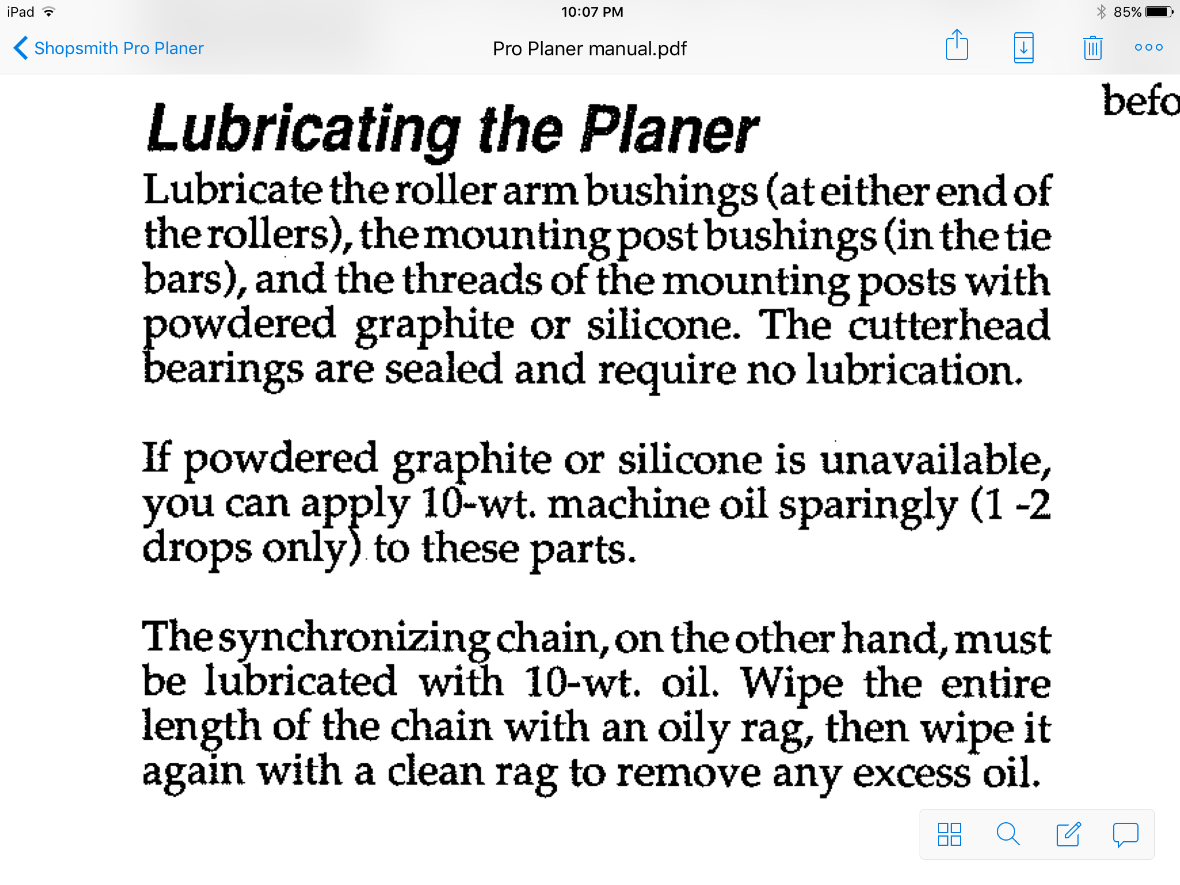

By the way, I have found 10w non-detergent oil a little hard to find locally. The only place I was able to source it was from an O'Reilly Auto Parts store, and they had to get it sent in from another store in the next town over.
Hopefully a helpful suggestion, if anyone else is looking for the stuff. The old Magna jig saw requires it, too, for the crankcase. I have some in a small oil can and I find a lot of other good uses for it around the garage and farm.
Re: Pro Planer Table creep
reubenjames wrote:By the way, I have found 10w non-detergent oil a little hard to find locally. The only place I was able to source it was from an O'Reilly Auto Parts store, and they had to get it sent in from another store in the next town over.
Do not get hung up on the #10 oil. Sewing machine, turbine, 3 in one, zoom spout, electric motor oil - it is all #10.
Oh and compressor oil for the jig saw crankcase.

JPG wrote:Do not get hung up on the #10 oil. Sewing machine, turbine, 3 in one, zoom spout, electric motor oil - it is all #10.
That probably would have been helpful for me to know a couple years back when I was going crazy searching for it. Why don't they publish *that* kind of info somewhere on the packaging? I guess then everyone would realize they are overpaying for it. To that end, I still think the 10w non-detergent is a good deal, for the volume to price ratio, if nothing else.
I left out one detail. MACHINE OIL, not MOTOR OIL. However non-detergent motor oil is close.IIUC

Post by reubenjames »
You are probably right. I thought I had read, maybe in older literature about the jigsaw, that a 10w non detergent motor oil was ok. I could be remembering wrong and the difference between motor and machine oil back then also could have been nominal compared to now. I would think a motor oil would be more stable under higher temps, if anything, but I can't think of any drawbacks, unless purity is less of a concern in motor oil production. Just speculating here.

reubenjames wrote:You are probably right. I thought I had read, maybe in older literature about the jigsaw, that a 10w non detergent motor oil was ok. I could be remembering wrong and the difference between motor and machine oil back then also could have been nominal compared to now. I would think a motor oil would be more stable under higher temps, if anything, but I can't think of any drawbacks, unless purity is less of a concern in motor oil production. Just speculating here.
Motor oil has additives(I donno what) and detergent was the major one. In any event you want 'slick'.

I guess anti corrosives and anti foaming agents, etc are probably still in the mix. Wonder how that's affecting my jigsaw.

As I said after brushing and cleaning off the graphite I have no more downward creep of the table. I think the combination of age, heavy weight of the cast iron table and the vibration of the machine contributed to the creep. The parts probably have some wear after a lot of use, don't forget how old this planer is. I don't know how much wood went through it as I bought it used. I do know that the out feed roller was worn badly and had to be replaced. Luckily I had one on hand from an earlier repair of my Shopsmith mounted planer as stated in an earlier post.
Thanks all for your opinions and advice.
