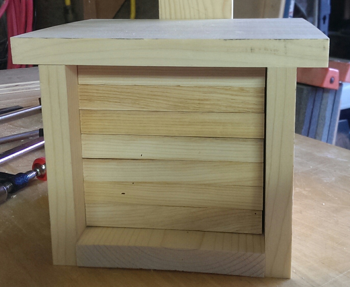

Coincidently I started building a mason bee house myself this last weekend after not getting to it for several years. :o
Still a work in progress.
Here are a couple of photos

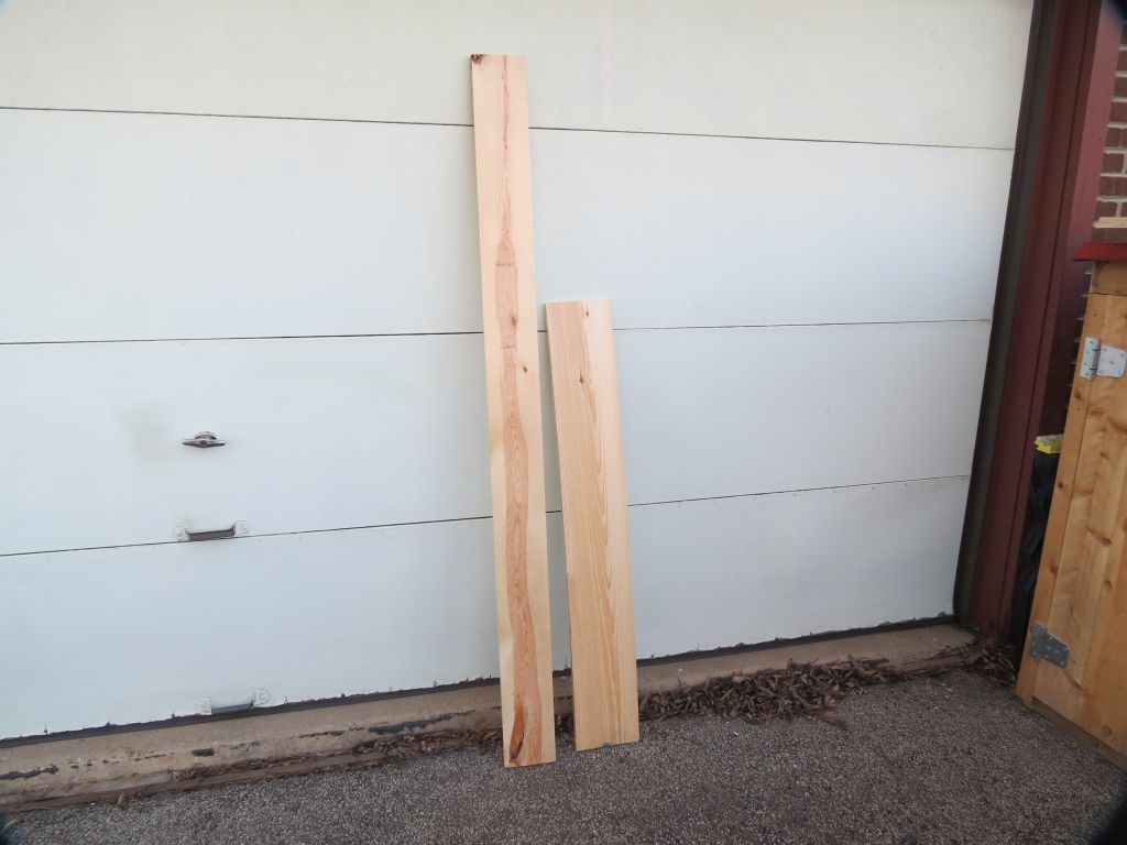

Have you gotten your wood for the project yet? I have, and this is the two pieces sitting against the garage door this afternoon. You know the rule here, no picture then it didn't happen.
The taller board, the 1 x 6 x 6' was $2.99. It is what they call #3 standard board. The pile of 1 x 8 x 4' of this quality was down to just 3 boards and they were pretty ruff looking. So I had to go to the #2 quality boards to get one, and the price jumped to $7.79 which turned out to be the price of a 1 x 8 x 10' board on the sales receipt so I have to go back tomorrow and get this corrected.......... I'll let you know when I have a real price for that piece but as you can see this is not an expensive project.

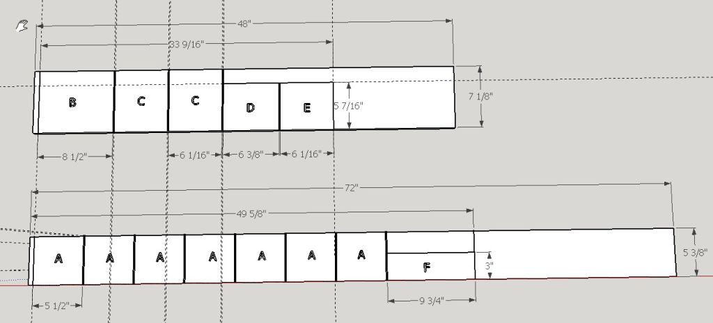

First things first. I measured the wood I just got and they are undersized in width from the numbers I used. So I went back in and redid the drawing. I'll post that in just a bit.

As I mentioned this is the latest and greatest drawing.
ScreenHunter_118 Mar. 12 16.09.jpg (38.66 KiB) Viewed 12897 times
The main change is to the width of the stock and the resulting changes due to that change.
