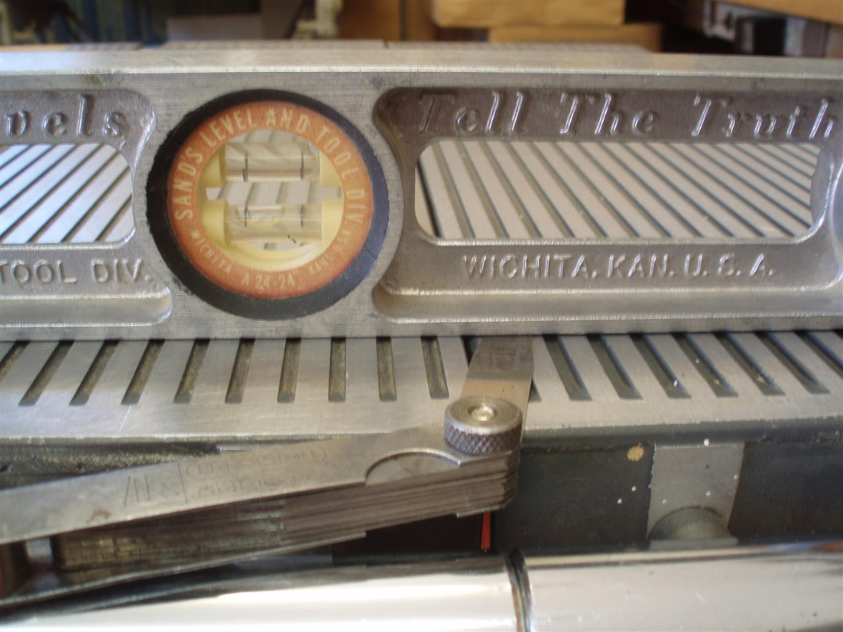

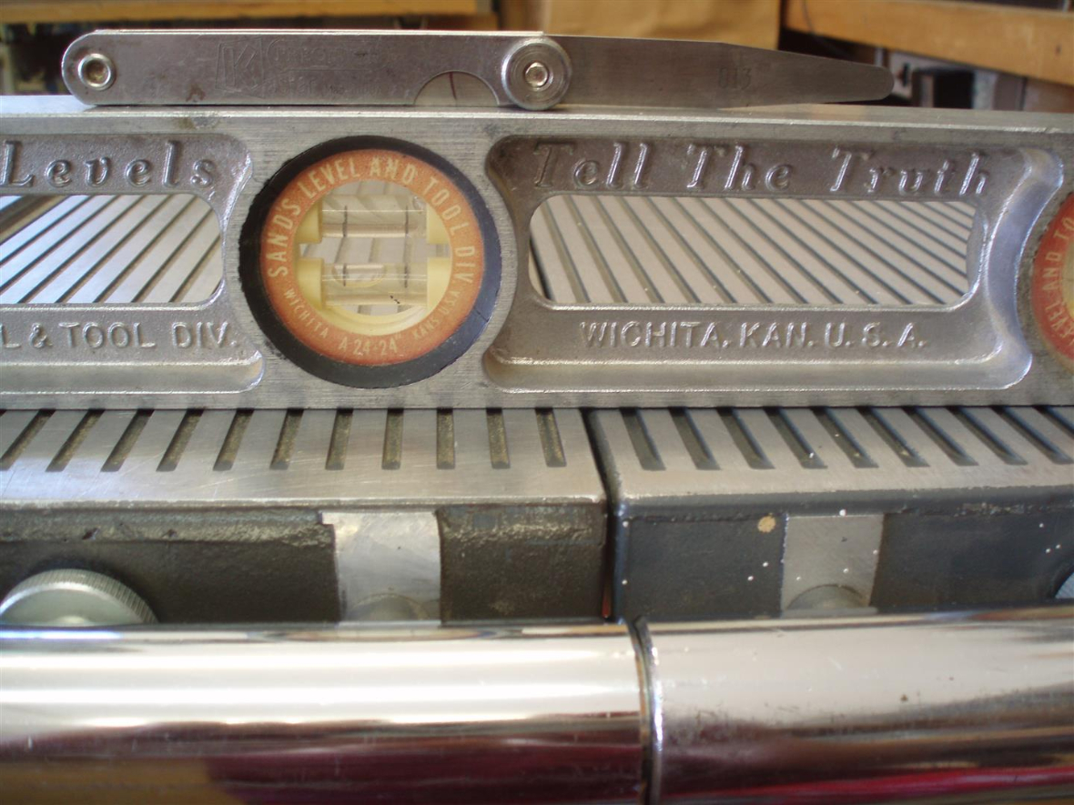

I will never comprehend the problem that is being described here. With the thumb screw loose, the connector tubes lay on the bottom of the table rail. As the thumb screw is tightened, the connector tube is pushed back (not up, down or any where else); it is pushed back. How far back. Well that depends on how tight you make the thumbscrew but the maximum would be <3/32" (.094"). Is this a repeatable condition and is the error (.094") enough to present a problem?
I am sorry, Ed but I just do not see this happening and I have checked just about every time you have posted anything here on the forum about those "rails and tubes". Every time I have checked, the thumbscrew pushed the extension tube to the back of the rail. In so doing, the extension tube climbs the inside wall of the rail until it can go no further. This leaves a gap of <3/32" between the rail and tube on the side opposite the thumbscrew.
Bottom Line: I find the Mark V Model 510 to be every bit as accurate as the Mark V Model 520 (with the Pro Fence).
With just the main table two connector tubes and a floating table can you lift up on the floating table and tighten the fence rail jack screws on both the main and floating table and have the table higher than the main table? If you can then you see the problem. If you can't then you have one in a million Shopsmith's.
With the 510 I always had to lift or push down on the floating table to have it level with the main table. On the 520 I simply have to mount it and it is perfectly level.
The leveling became more complicated when I had a main table, two floating table and an aux table in the mix with all tables on one side of the main. I was pulling up pushing down,
Checking with a straight edge and running around to the back of the maching to push up or pull down. It looked like a voodoo ritual with me dancing around the machine
Now with a 520 I set my main table to the height I want. Using a straight edge raise my aux table to the same height and then slid in connector tubes with floating tables on them and all is automatically level when I tighten the fence rail jack screws on all tables
Nope, I don't have that one in a million. When I install a floating table along side the Main Table they do not line up at the same height. I have included a couple images to document that. There is room under a straight edge that spans across the main and floating tables to insert a .013" feeler gauge.
Now, I MIGHT be able to improve upon that but why. How perfectly close to coplanar does one need for a floating table. Furthermore, if anyone gets a 520 floating table closer than that it is because they meticulously aligned the table/rail to achieve that.
LATE COMMENT: When I assemble a multi table configuration, I lay all the tables out on a work bench (face down) and insert the extension tubes through all of them. I then loosen all of the rails (front and back---510 or 520) from the tables and I then secure the rails to the tubes. After doing that, I secure the rails to the tables.
