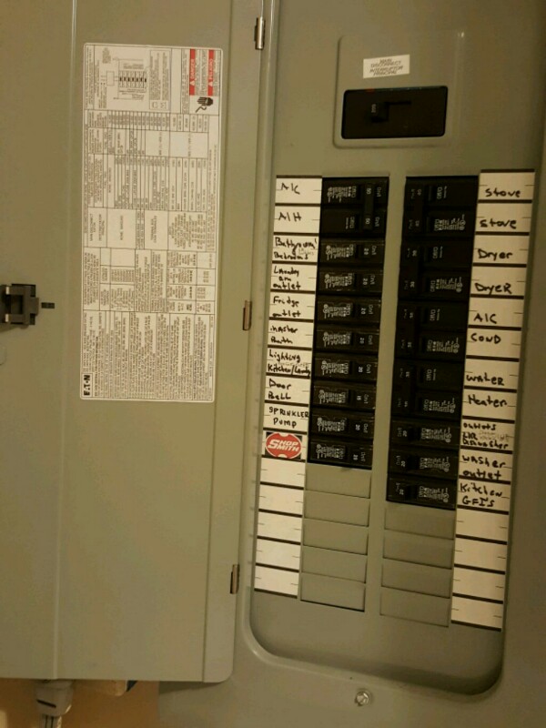

Today I installed a completely new 20 amp circuit.
Can you spot the new circuit?
New circuit
New circuit
This did nothing to improve my problem.
It's looking more like a bad motor.
