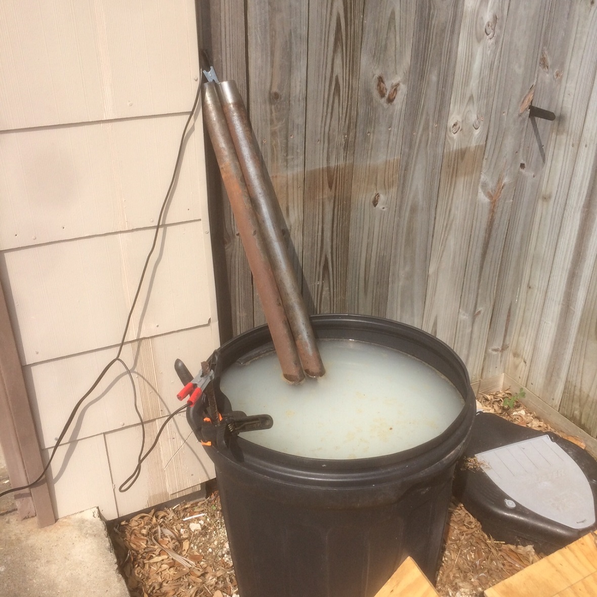

Progress today. "Cooking" the way tubes! Thanks for all of the electrolysis info on other threads. This is so much easier than using abrasives.
electrolysis of the way tubes

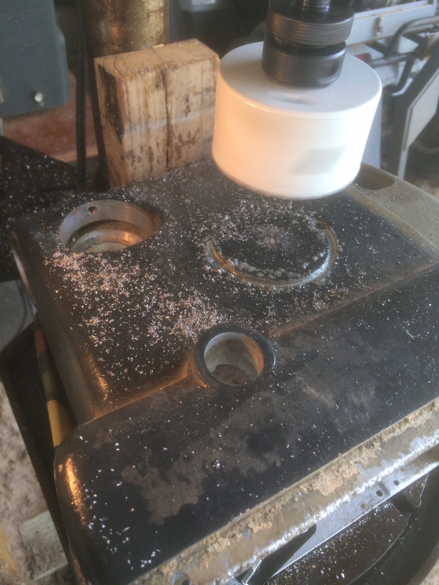

Added an inspection port to the casting. Bi-metal hole saw followed by filing with a fine file. Cleaned up pretty well. Happy to have access to the internals!
new inspection hole
new inspection hole

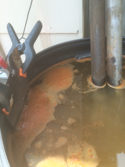

On the electrolysis, I exchanged the rebar I was using for an old saw I picked up at an estate sale for $1. The reaction took off. I'm assuming the extra (10x) surface area does a lot for the process. Looking forward to the results.
updated electrolysis

Re: '55 Surprise...Starting Restoration
not2shabby wrote:I'll try some penetrant (probably PB Blaster, unless that's frowned upon...it's what I have on hand) and the gear puller.
Is the spacer between the sheave and the motor housing? What am I looking for exactly?
Proximity also helps!
