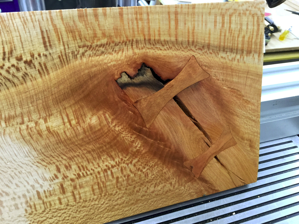

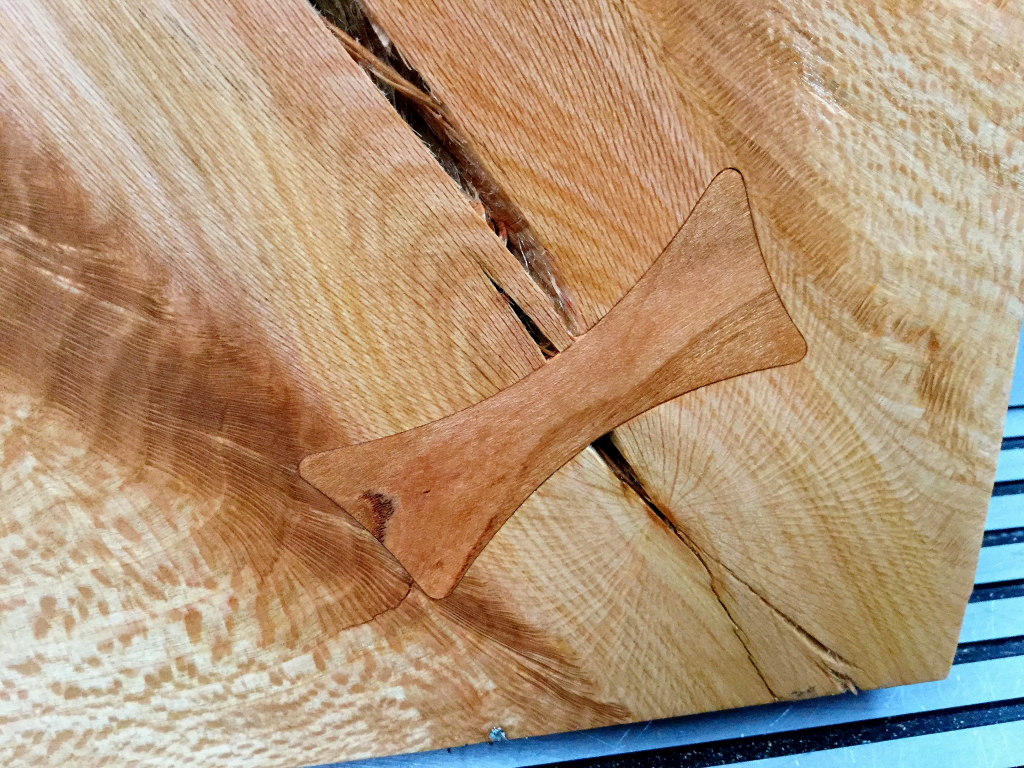

Is something like this what you had in mind, Ed? This one is just a test on a piece of cutoff scrap. 3/8" cherry butterfly inlaid in 3/4" quarter-sawn sycamore.
Butterfly inlay test.JPG (935.02 KiB) Viewed 10605 times
I milled the template and inlay on my OPR. I can mill the pocket either with my OPR or my new compact plunge router. Based on few test cuts, I like the OPR better for small workpieces, and the plunge router better for big ones -- like the paneling boards that got me started down this rabbit-hole in the first place. :rolleyes:
But I'm finally ready to start on the actual paneling-board inlays. :) I'm going to use a couple of different sizes of butterflies, with the larger ones near the center of the split, and a smaller one near each end.

Can't tell by the one picture but watch to make sure it's not wood shake.

BuckeyeDennis wrote: Is something like this what you had in mind, Ed? This one is just a test on a piece of cutoff scrap. 3/8" cherry butterfly inlaid in 3/4" quarter-sawn sycamore.
Looks great to me, nice job on the asymmetric butterflies, I may make myself a template like that!
