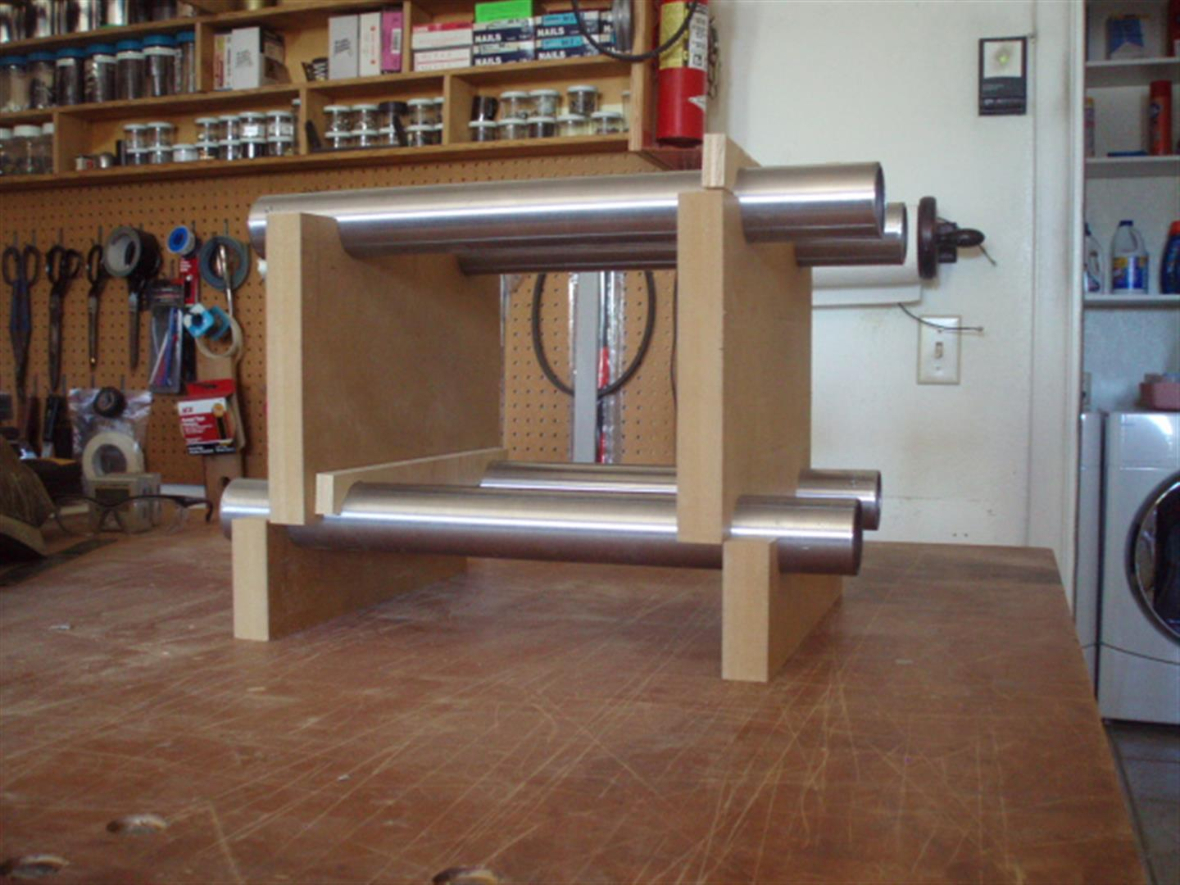

I very carefully laid out one of those jigs, made a pattern and then produced one. Now I am at a loss. No really what I have to do is wait for the kit to arrive and install it into my machine.
I am at a loss because my carefully crafted jig indicates to me that the Bench Tubes are not parallel to one another and maybe not coplanar. If I find that the tubes are not straight, then I'll know why. That won't happen until sometime after the kit (currently on backorder) arrives. This bugs me and like I said "I am at a lose".
If Shopsmith had given me the numbers (design detail) I would know where the issue is but that did not happen. I created the numbers by measuring the machines and the various parts that I have. It may be my own assembly errors that now have me chasing my tail.
POST SCRIPT: The Way Tubes checkout perfectly but that may be due to the tie bar, carriage and headrest keeping them in check. I used the dimensions for a tie bar to create that portion of my jig. With the oversized holes in the castings, the correct bench tube spacing is a bit more difficult to ascertain.
The dimension for my jig are detailed elsewhere in this thread.

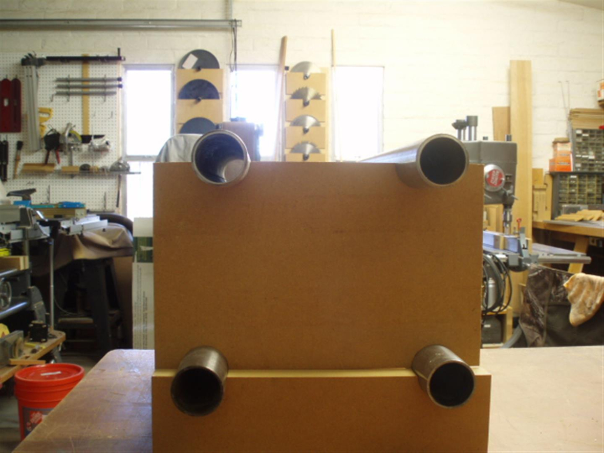

OKAY, I am ready. Bring it on. The Double Tilt Kit that is!
I believe that I am probably going to break mine down into its many pieces and build it back up as a Double Tilt. It is my theory that this will be the way that I will get the alignment that I want. There is no way, in my mind, that a properly built and aligned Mark V can exhibit the extension table alignment issues that we all have (to some degree or other).
The jig, as simple and fundamental as it is, will allow me to do this in a very controlled manner.
Ignore the small plywood pieces that are atop the Way and Bench Tubes. Those are cutoffs from the pattern I made. Not part of the Jig.

1" MDF?
Re: Preping for the Double Tilt
Yes, 1" MDF. Left over from a bench top built long ago.
There is only one thing wrong, in my opinion, with using MDF and that is the dust. Goodness does the router ever kick up a dust storm.
No, there is another. The weight.
