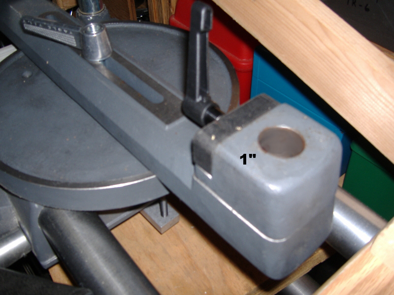

Hi,
I saw a post either here or at another shopsmith site that sure opened my eyes to another interesting way to adapt the universal tool rest.
First let me say I've looked but can't seem to find the post.... other wise I would have added the thanks there........ THANKS
Now it was clear that one could use 3/4" tool post holders but I did not even think about the option of using 1" items. The key to this is the fact that the support base assembly has a 1" hole! (item #6 in the parts list).
Since these part name may not ring any bells I've attached a couple of pictures.
[ATTACH]48[/ATTACH]
[ATTACH]49[/ATTACH]

What is the advantage of 1" over 3/4".
deanthom
Posts: 68
Joined: Thu Dec 14, 2006 12:34 am
Location: Missouri
Post by deanthom »
Three advantages:
Stability. The fatter the post, the more stable the rest.
Availability. If you have certain other tools/lathes, you may already own a couple of nice, fat posted toolrests.
Adaptability. Some extras or accessories on other lathes might just work with your machine where they never would before. Like the coring systems (McNaughton, specifically).
