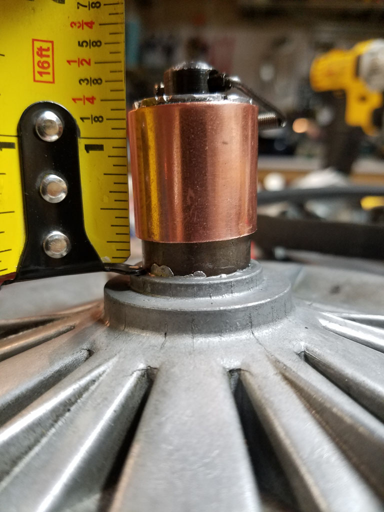

Your idea of making the 'snout' longer by using the copper sleeve is brilliant! That actually could be the final touch to make the conversion work.
One way we might be able to find the correct length the 'snout' should be is to measure on a Mark V the distance from where the snout abuts on the control sheave to where it meets the quadrant assembly at a known location (HIGH or LOW). It would be easier to make the measurement with the belt off, so we know the sheaves are fully closed.
Unfortunately, I already put the sleeve on my control sheave. I might be able to carefully use the dremel tool to cut it off. However, even if I did that I don't have the proper tools, or knowhow, to secure the bearing at the end of the new snout. That would take someone with some metal working experience to do that. That's out of my wheelhouse.
I'm now torn on what to do. I believe your idea on how to lengthen the snout is a viable one, and it could work. However, I'm also thinking that converting back to a Mark VII speed control would for sure solve my issues.
I almost forgot, you asked about my control sheave. The snout measured 1.25" tall without the button, and 1.5" with the button.

That IS a MV control sheave. The MVII is 1/4" shorter.
BTW the MV key is about 1/4" shorter than the shaft.

That's good to know. The next step would be to find on a Mark V the correct distance from the Mark V control sheave fully pressed against the idler sheave (without belt) to a known position on the quadrant assembly. I could then adjust my control sheave's snout length to get that same distance (assuming I could find a way to lengthen the snout).

I did think of one way I might be able to extend the snout on a MV control sheave. Using JPG's idea on the sleeve, what if I took a MV control sheave and cut the 'snout' off in the middle with a hacksaw. I could then use a 3/4" copper pipe as a fill in to extend it to the proper distance (still an unknown), and a 3/4" copper coupler to connect it all together. I believe the extension will only be somewhere between 1/4"-3/4", so the copper pipe/coupler wouldn't have to support a long distance. Any thoughts on this idea?

I believe extending the 'snout' on the MV control sheave is actually not too difficult to do. I believe JPG is right in that using the sleeve it's possible to do. My thought is cutting half of the 'snout' off. Then use a 3/4" copper pipe as the extension, and a 3/4" copper coupler as the connection/sleeve. The pipe with the coupler will help strengthen the extension.
That being said I believe that only fixes half of the problem. I believe the quadrant assembly is too short. Even if the 'snout' is longer the button rides on the end of the quadrant assembly. Maybe that isn't really an issue, but it seems like it puts lateral pressure on the control sheave right now. I think that is why it is prone to binding up. This could be fixed by someone with a CNC machine. They could recreate the assembly, but make it 1/2"-3/4" longer. I think that would be the final piece to the puzzle.
