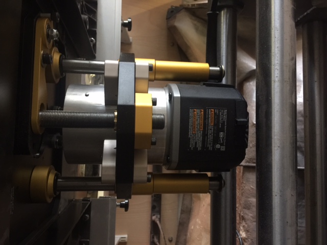

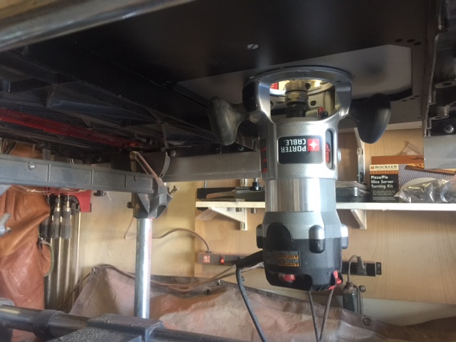

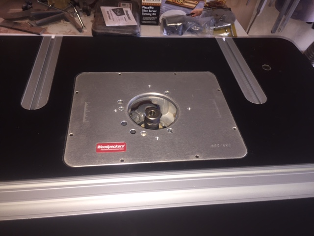

Well I have finally finished my project for mounting a very good routing table and lift to my SS. I decided to use a Incra Masr-R Lift ( http://www.incra.com/router_system_acce ... ft-ii.html )
and the Woodpecker phenolic table and super fence http://www.woodpeck.com/superfence.html. For the router I went with the Ported Cable 7518.
SS mouinted router table.JPG (111.23 KiB) Viewed 12503 times
SS Mounted router table 2.JPG (81.91 KiB) Viewed 12503 times

Thank you. I spent a fair amount of time learning about many different components of a really good/functional router table/system. My shop is space limited so I could not just put in a stand alone router table/system. Living in Texas I wanted a table that would not be affected by the weather so I look at all materials, eliminated iron top because of weight, eliminated MDF because of thickness/sustainability (sag) and decided on phenolic top-being 3/4" thick also help with expansion options if needed. I selected Woodpeckers because of its design. Look at both Jessem and Incra lifts-very similar (both manufactured by Jessem)-selected Incra because of equivalent price but I like the magnetic table inserts. Picked the fence to work seamlessly with table. Finally picked PC 7518 as overwhelming most highly rated 3+ HP router. In the end I am very please with all the pieces. Finally have a router table that leverages space of the SS, but easy to dismantle for storage.
