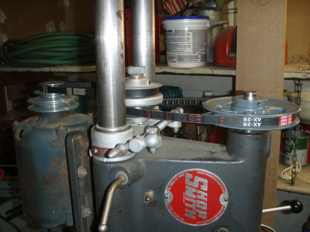

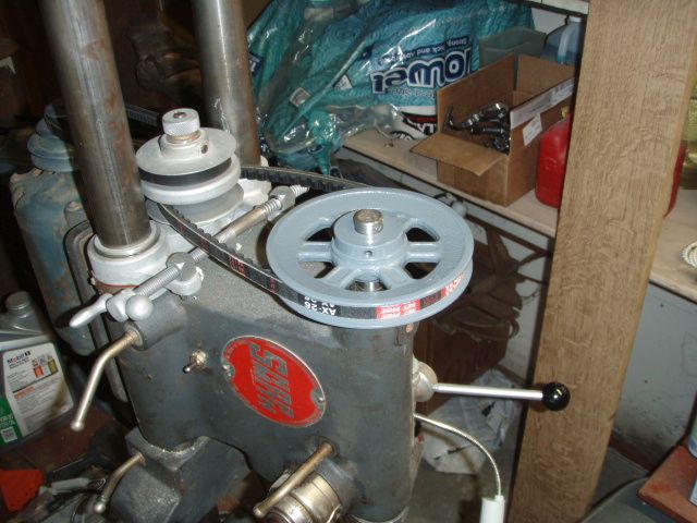

ERLover
- Posts: 3914
Re: ER low speeed RPMs
It is a finished project.
322 rpm @ 0 setting.
1090 rpm @ 5 setting.
29" belt was too big, no 28.5", 28" is just fine.
Thanks all here fore your help.
