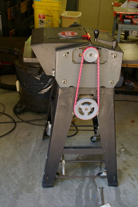

Update:
I have replaced the original cast aluminum pulleys with cast iron pulleys. The upper pulley is 3.05", the lower pulley is 5.4" which increased the cutter to RPM 6149, instead of 5750 RPM or an increase of 399 RPM. Since the original belt was too short replaced it with a Grizzley link belt. Both pulleys now run perfectly true and there is absolutely no vibration. Also runs much quieter. I haven't planned a board yet, but wonder if the increase in speed will try to bog the motor down. I have some 10 1/2" wide Pecan and 10" Black Walnut to see how it will respond. I want to dress the blades first and will post the results.
Don G

John

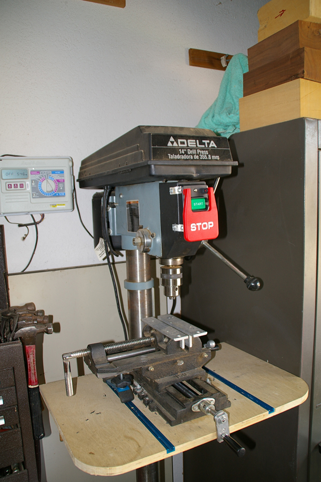

As I stated earlier, the SS 3" pulley was basically junk. The bore was wallowed out and wobbled a lot. I found the 3.03" at a very good price as well as the 5.4. Not trying to invent something, just trying to get this "Old Girl" working as it should without it sounding like a jet taking off. Seems like the issues keep coming, just had another one crop up. Will post the remedy later. Been busy all afternoon putting a "Panic" off switch on my Delta Drill Press.

dgreen810 wrote:John
Don G
I Love those switches, cant find them anywhere but Rockler or Amazon via Rockler, I mount them just above left knee height, just a tap with the knee, OFF!!!!
