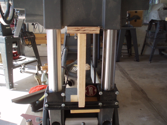

Well, I gave up on the jack idea! Just didn't fit my bill. I am using wood a block(s) for support of the carriage. As long as the way tubes stay well waxed, I can lift the headstock fairly easily. Couldn't continue to think about additional metal gadgets that would just serve to complicate a setup.

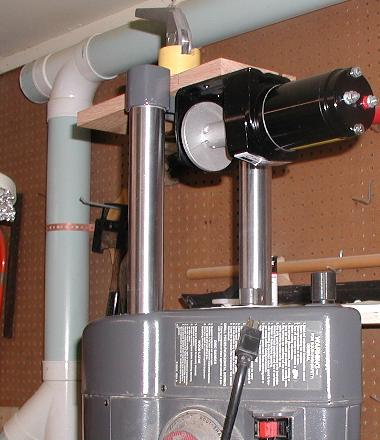

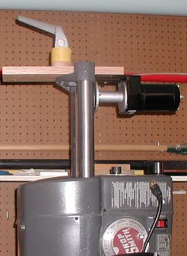

Winch
Maybe someone can go with this idea. I toyed with using a removable winch attached to the SS tiebar but have never come up with a good way to attach the lift cable to the headstock. I may get back to the idea.
[ATTACH]3168[/ATTACH]
[ATTACH]3169[/ATTACH]
Thanks,
John

I have toyed with the idea of a bottle jack or a "small" screw jack but after giving it some thought and doing a little bit of experimenting - "it seems like overkill".
I agree that from time to time there is a need for additional support for the main table (when in the drill press mode"). But, I think that support can easily be provided using cutoffs.
If an adjustable support is needed, well, that will take more thought.
[ATTACH]5853[/ATTACH]
Quick and Dirty
Quick and Dirty
