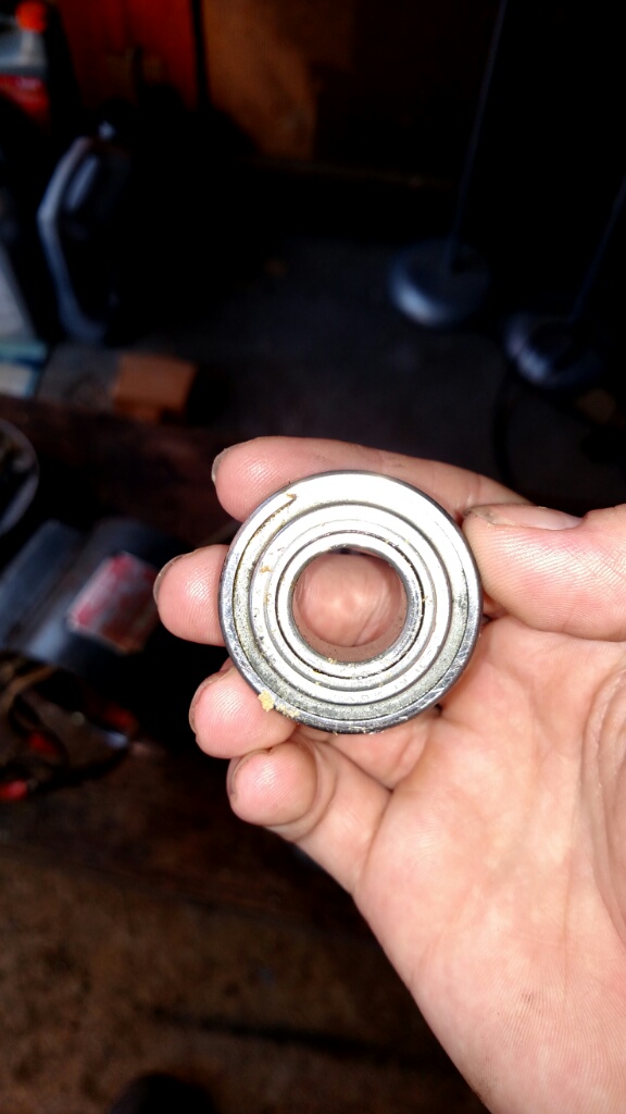

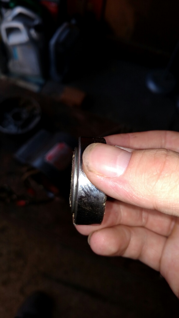

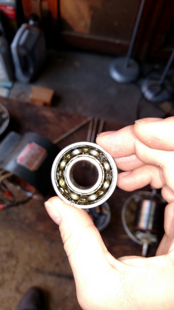

Question about the bearings that came out of my Powr-Kraft 1/2hp motor on the 10ER. I think it was the "front" one, on the spindle, was a Fafnir 203KTT. Easy enough to search on line and look up the size and prices from other brands. But the "rear" one, in the back housing was a weird one. It's a Federal FS8503. I couldn't find a definitive size or match online to look up other brands. All I came up with was the number 8503 but it seems to very alot. I don't have any calipers so I can't accurately measure it. Does anyone have any info on the bearing? Or should I buy some calipers to get the exact measurements and then look that way.
Re: My 10ER aka Jane Doe
Is this it? Scroll to the bottom. https://nationalstocknumber.info/part-n ... _001563493
Id have to say yes. Without exact measurements I can't say 100%. But The size of the bearing does look like it matches the sizes listed. Very cool! I must not have been looking right if you found it that quick..
The dimensions listed have me confused. Width having more than one dimension. Is the bearing flanged?

Red, I forgot to take a pic of my bearing but here is a pic of a Fafnir 203KL, which is on the list Skizzity posted as a replacement for the FS8503. If I recall correctly (at work), this bearing looks the same as mine. I was confused also with the 3 different width measurements. The site posted is in Inches for the width's, but other sites when searched for the bearing had Metric measurements. Also different sites would have a different width measurement. Say one site would have the overall width listed, a different one would list just the "outer or inner" width. Very confusing.
'Typically' the inner race has a slightly smaller 'width' than the outer race. An additional width dimension is what I do not understand.

Here are some pics of the bearing that has the extra width measurement. Figured I would post them just so there was a good example on here.
- rps20161020_164858.jpg (89.88 KiB) Viewed 2654 times
- rps20161020_164929.jpg (121.96 KiB) Viewed 2654 times
- rps20161020_164948.jpg (132.34 KiB) Viewed 2654 times
