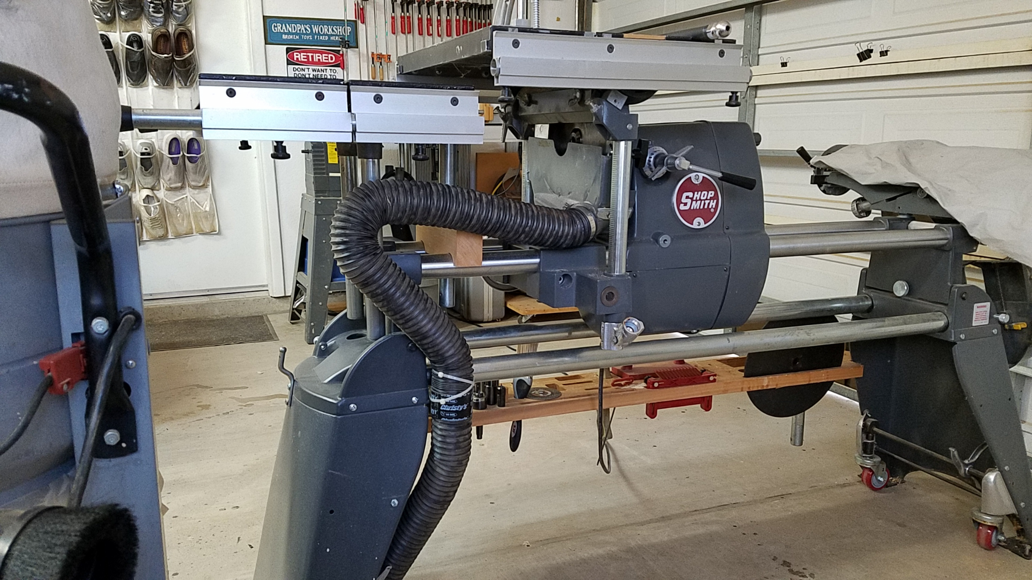

Here is how this ended (for the time being). I have real work to do in the RV. It is scheduled for a road trip within months.
Dust Collector r4 008.jpg (2.01 MiB) Viewed 28602 times
Dust Collector r4 009.jpg (1.94 MiB) Viewed 28602 times
Dust Collector r4 010.jpg (1.93 MiB) Viewed 28602 times
In the last picture, this is what happens to the flexible hose when the carriage and headstock are brought together into the saw mode.

Did the elbow at the dust chute disappear in this version?
Re: Mark V Dust Collection - Is There a Better Way??
algale wrote:Did the elbow at the dust chute disappear in this version?
The elbow, as seen in this last shot, will disappear but only if you help it to do so. The flexible hose is quite stiff and once straight it tends to stay that way. Just a little bit of pressure, at the elbow, and it straightens right out.
In normal operation, for me, it is seldom that the carriage and headstock will be far apart. I did this just to ascertain that the hose would expand far enough. I am not sure that I could move the carriage to its extreme in the opposite direction but I don't believe I would be likely to do that anyhow.
Now I have to get to work making sawdust and see if it really works.
