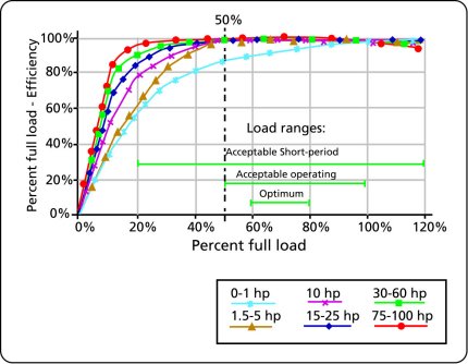

Θ = V/I phase shift? Would that not vary between motors?
Posts: 3812
Re: DC3300 - suggestions, upgrades, etc??
Correct. The cos(theta) term is called "power factor". It varys, but generally not a whole lot for induction motors of a similar size. The NEC, for example, specifies conductor sizing based on motor continuous-power rating alone. And we're just looking for a rough-but-honest way to compare woodworking-machine motors.
