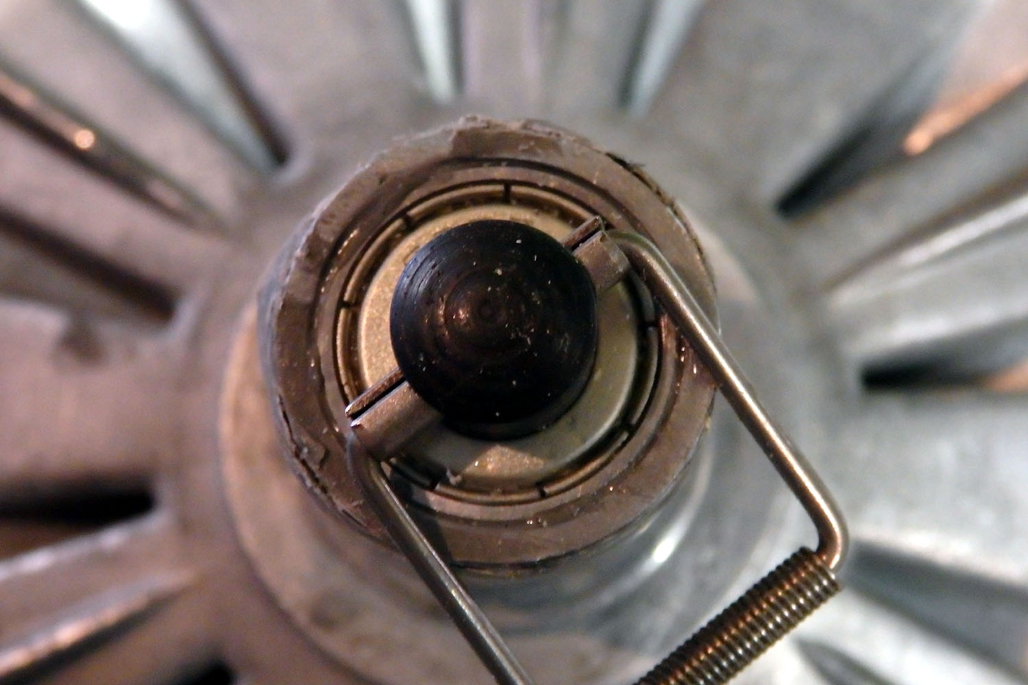

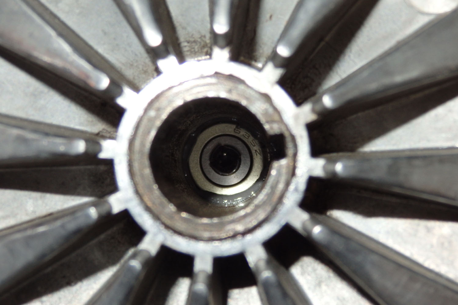

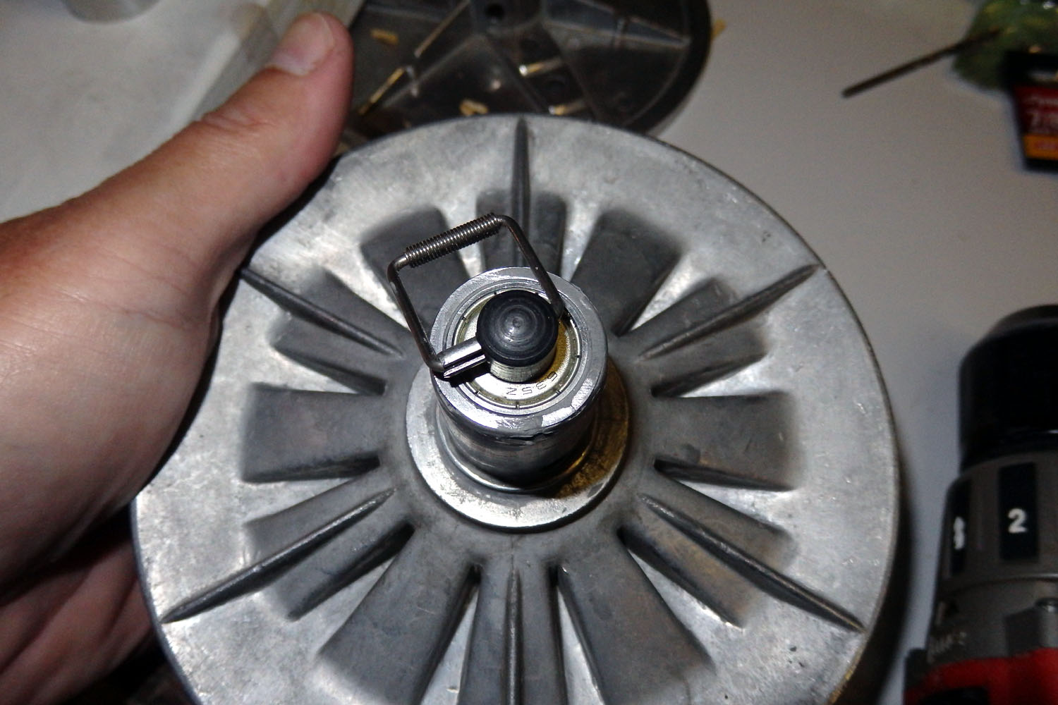

Right! I guess I was thinking that the speed control dial usually turns much easier when increasing speed, but you're correct, that is when the porkchop would actually be pulling on the loop and therefore the bearing. The spring at the floating sheave at the motor is being allowed to expand, and if that is well oiled, then it slides easily and therefore less pulling is required on the control sheave to get it to open.

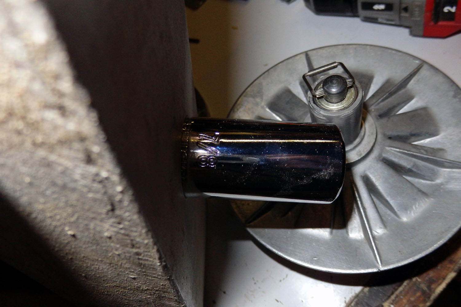

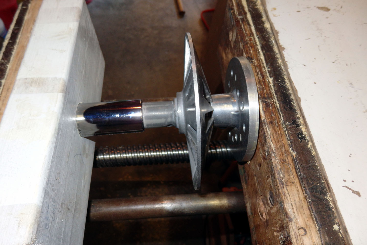

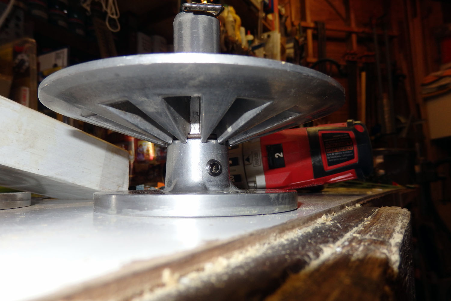

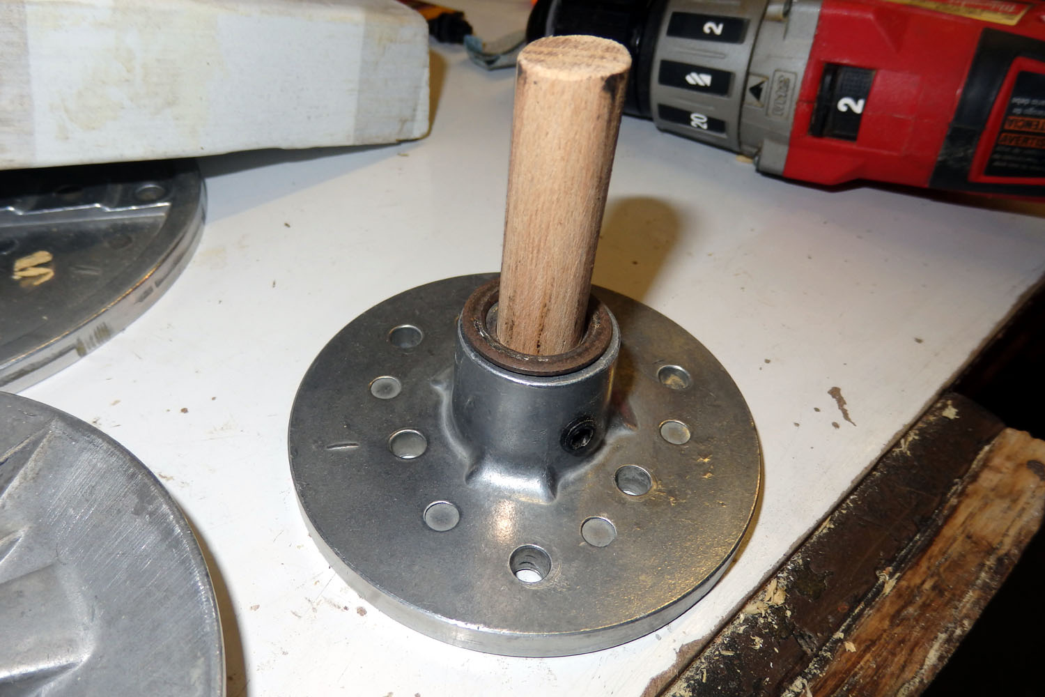

I worked up the courage to try putting the bearing in. Went and got a 7/8" deep well socket, drilled a 1-1/8" hole in a 2x4 to set it part way in to hold it perpendicular to the 2x4. Smoothed down a 5/8" wood dowel and used it in conjunction with small faceplate and a washer to provide bearing surface when put in woodworking vice to squeeze the "snount" tight around bearing. Tested it dry first, and it seemed to tighten up fit a little, so I went for it.
small faceplate, washer & 5/8" dowel
washer keeps sheave vanes from hitting faceplate

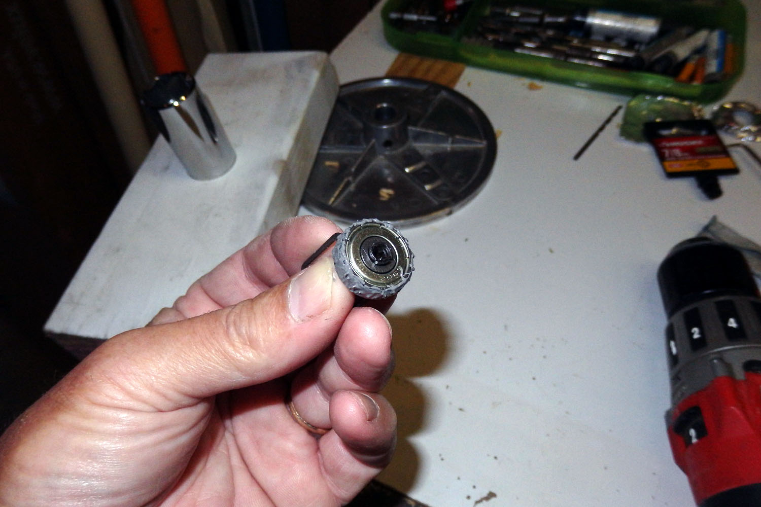

7/8" deep well 6 point socket, set 1/2" into 2x4. Deep well allows retaining loop and roll pin to remain installed thru hole in button while squeezing it all together

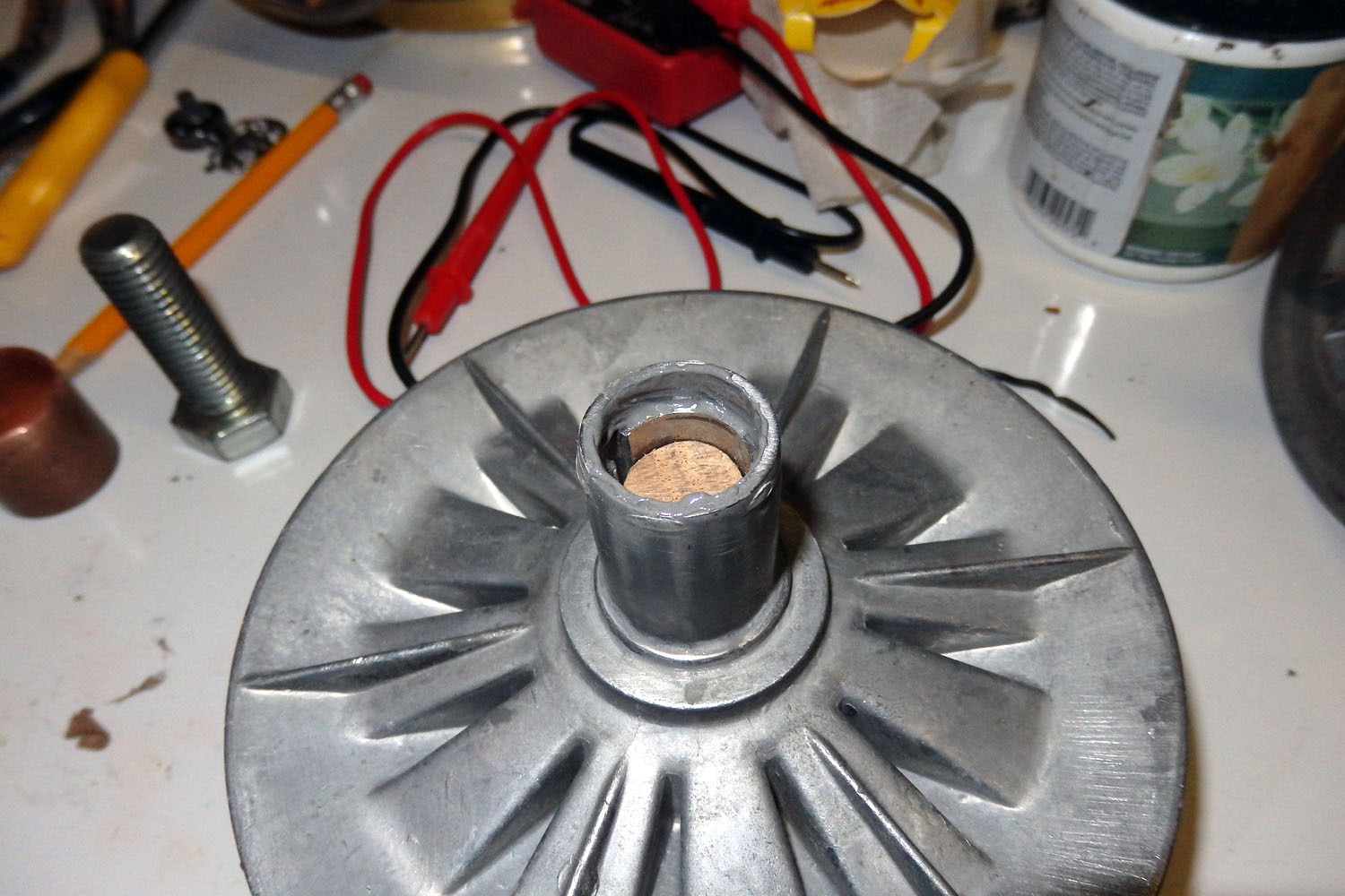

small amount of JBWeld inside snout
small amount of JBWeld on outside edge of bearing
bearing placed in snout, not much JBWeld squeeze out
squeeze some, squeeze some more, but not too much
after squeezing all that I dared
after sqeezing
after sqeezing
not too much squeeze out on back side of bearing. Now leave it alone for 24 hours.

Well, bearing seemed to be firmly in place after 24 hours when I tried to pull it out using hand force only, so I re-assembled everything (with no parts left over) and it now runs and sounds smoother and quieter than I remember.
Many thanks to all who offered advice and suggestions. Hopefully this repair will keep me going for many years to come.
