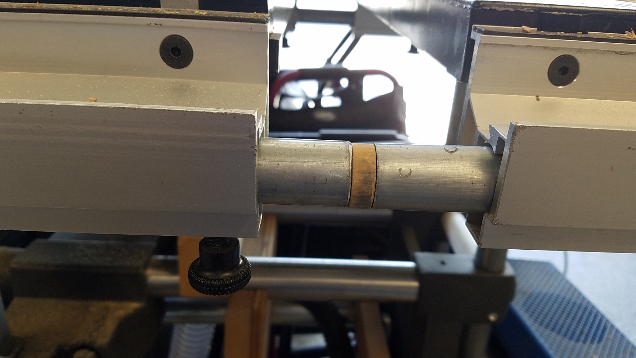

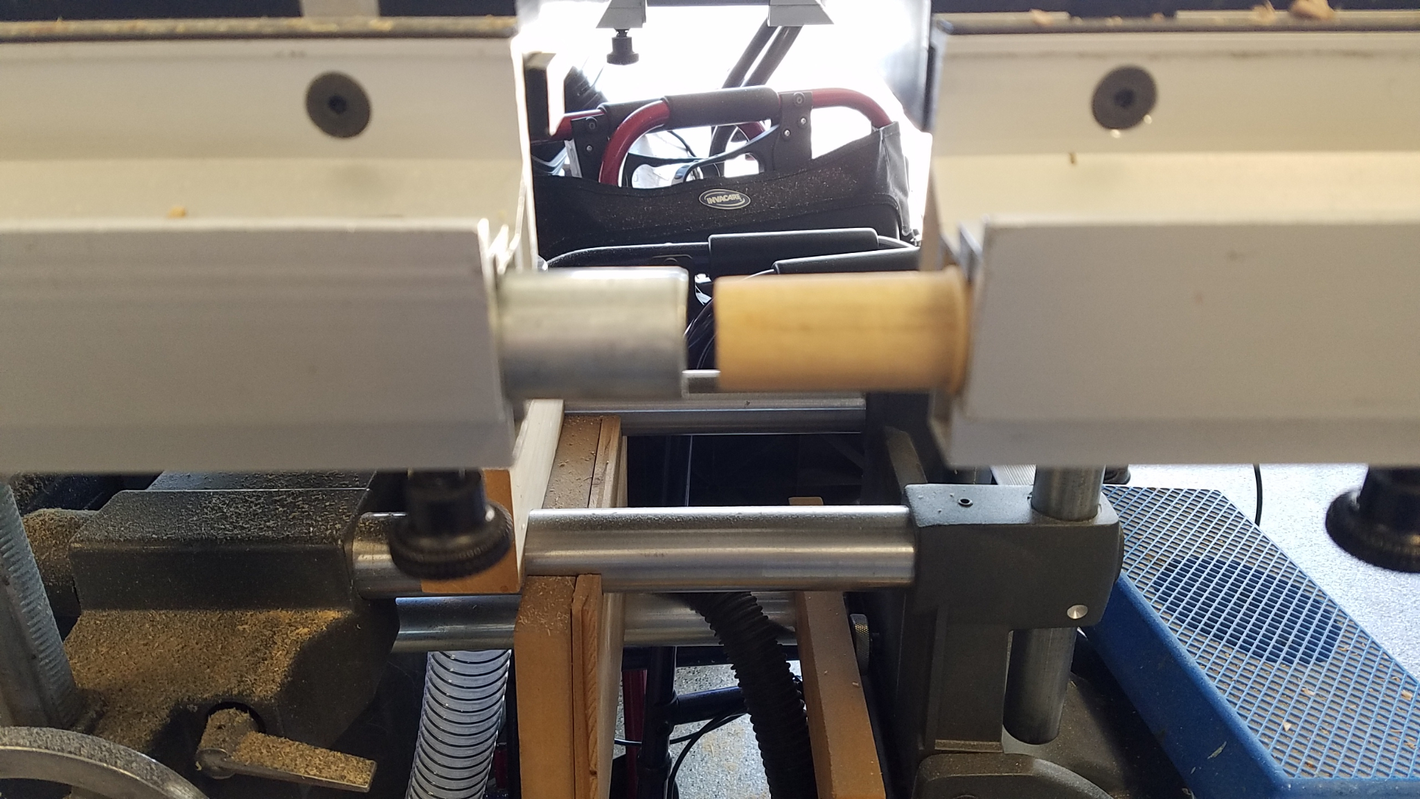

I can not speak for Dan but I DO NOT even attempt to raise or lower my Main Table with the Extension Table attached. I do. however, raise and lower the Main Table with my Outfeed Table and/or Sliding Cross Cut Table mounted.
I made a pair of wooden couplers for the Table Tubes to join (between the Main Table and the Extension Table). Thia allows me to disengage the Extension Table from the Main Table without pulling the tubes all the way out of the rails.

Not my best photo shots but these should give you an idea of what I did. I find that this simple solution works well for me. I normally do not tie the rear (outfeed side) end of the table together but this could be used there too.
I am having a pair of these, 8" long being made using aluminum bar stock.
