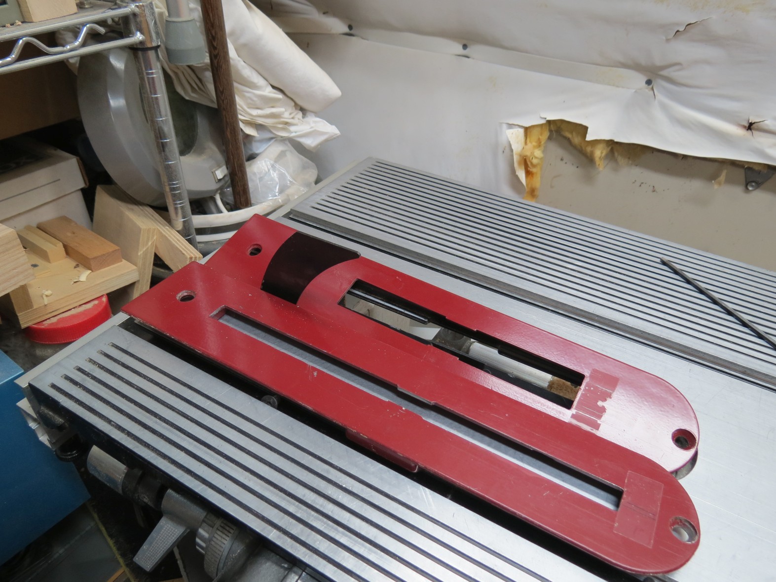

OK here is the story sad as it is. Starting with the stock dado table insert. You can not mount the riving knife with that insert. The opening is smaller and unless you have modified yours it simply can't fit. Here is a picture showing the knife in position and the standard saw insert in front showing the cut out goes far enough back to allow the knife to fit. The dado insert is not even close.
So you have to make your own insert. Sure that can be done but don't get your hopes up as it gets much worse.

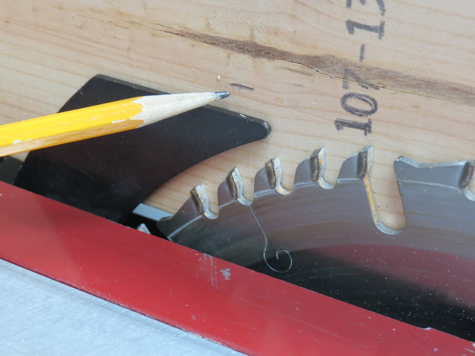

Here is the standard 10" blade with the riving knife mounted. I didn't actually measure but I'd guess at the knife being about a 1/4" shorter then the blade and that is fine as the blade is taller and so no issues. Here is that picture:

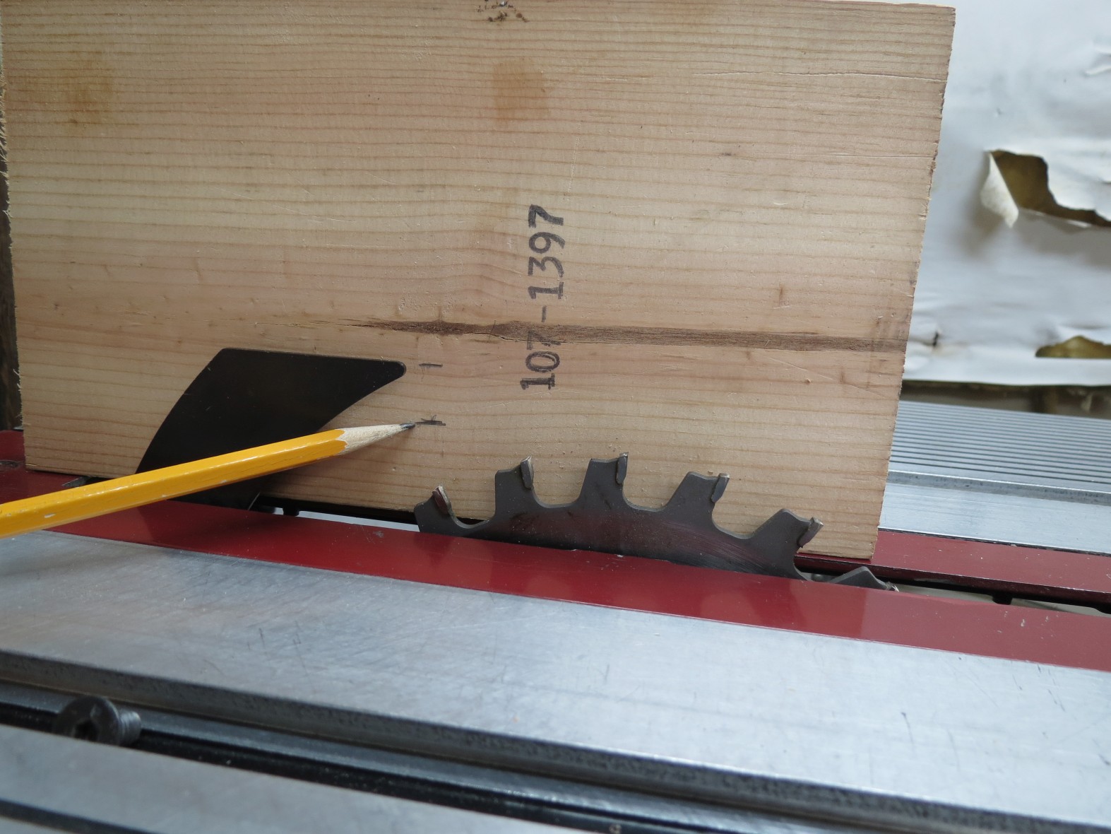

Now lets see what happens when you mount an 8" blade, like a dado blade. The riving knife remains at the same height but now the blade is an inch short(2" smaller diameter, 1" smaller radius).
Now the knife is about 3/4" taller then the blade, makes for a pretty hard non through cut!

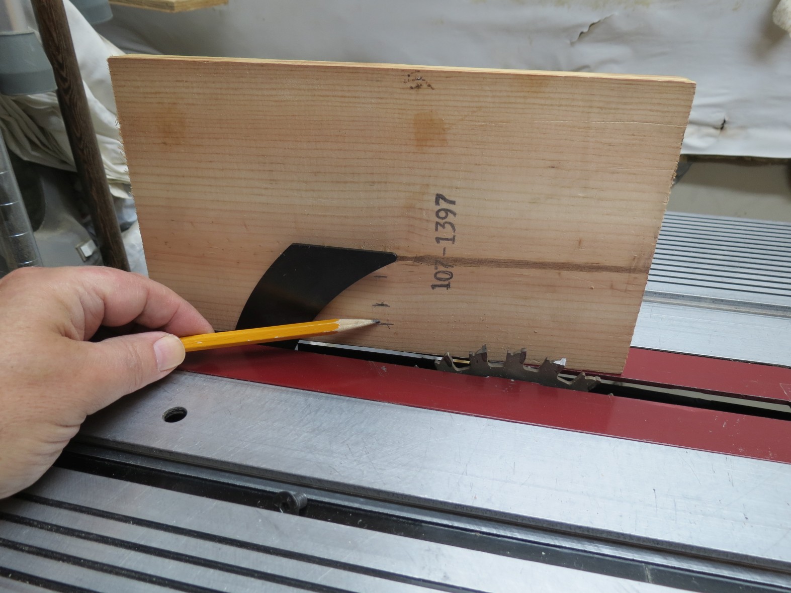

Now what do expect to see when we go to the 6" size blade that shopsmith sells? The knife is still as tall as ever and the blade has gotten even smaller.
Now unless some magic is involved I think we can conclude that this is not for non-through cuts unless you have a 10" dado blade set and make your own table insert.
