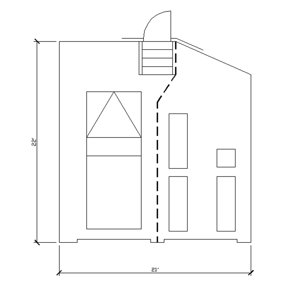

Wow, you've got a lot of equipment! I count three full size Shopsmiths, 2 planers, 2 belt sanders, a bandsaw, a jointer, a couple of vaccums, as well as the usual garage stuff! I tend to visual "in plan" ... is this a fairly accurate plan of your garage?
Sazerac81 garage.jpg (72.65 KiB) Viewed 15361 times
Did I guess right on which sides are 21' and 22'? Are steps to house "centered" on wall between doors? Looked like in the pictures one wall is angled ... assumed steps project into garage about 4' and angled wall is splayed about same amount. The three rectangles on the shop side are 24" x 72" footprints for three Shopsmiths. Square is 24" x 24" footprint of freestanding planer. Maybe you can print this out to some sort of scale and try re-arranging your equipment on paper.
For the mini-split system, why can't it go on splayed wall, and refrigerant lines run along wall or ceiling to get to outside wall?
The dashed line down the middle is possible plastic divider. I would limit access between 2 sides just at base of steps.
I second suggestions to use that additional space up high for storage. Any chance of an outside storage shed to get some seldom used things like garden tools out of the way?

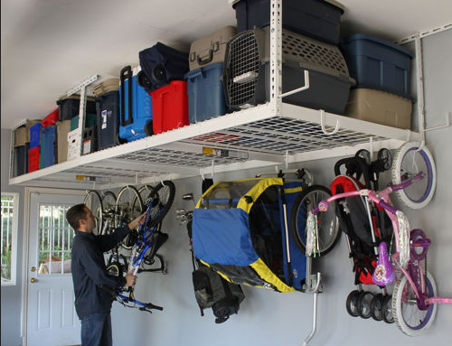

I would start with 4 of these, Costco has a two pack for around 250 bucks when they go on sale and they work awesome. I have 2 in my garage and they are way better than trying to build a loft due to cost and ease of installation.

superpop wrote:I would start with 4 of these, Costco has a two pack for around 250 bucks when they go on sale and they work awesome. I have 2 in my garage and they are way better than trying to build a loft due to cost and ease of installation. 2017-03-05 14_45_24-costco overhead racks - - Yahoo Image Search Results.png
With apologies, I am not trying to hijack this thread... :o :o
How is the 4' depth for access? I considered them but it seems like a long way to reach in to pull something out that isn't at least 36". Costco does have ones with 36" and 24" depths, they appear very stout.
Thanks for any info and again sorry about hijacking this thread.
I think one of the big problems is the slanted front of my garage and height. I would need the support struts to come down about 6-7 ft to support. Do they sell versions with longer support struts and a roof slant?

Access is fine and they do extend down to give you about 4 feet of clearance. I use the big plastic totes to store stuff in and they go about halfway back and then another one goes in front of that. Works fine. I would think 2 of them in the OP garage would be fine. You can also hang things under them with bungee cords.
