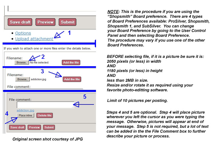

Spencerb wrote:... Picture didn't work, too big....Yada yada, I give up. Will see what comes in the mail...
Hopefully the parts you ordered will fix your problem, but I hope you didn't order the parts without fully understanding what needed to be replaced, because if so, you may be in for an unpleasant surprise, if in fact, you need more parts.
This forum is a very useful resource with information available for every level of experience and mechanical ability ... the trick is the patience to read and follow the leads until you fully grasp how something works. The "search" feature will at times turn up exactly what you need, but often the phrasing of the search will make a big difference. Different terms are often used to describe or name various parts, which makes a verbal description sometimes hard to follow. I too am one who prefers pictures whenever possible, and offered these tips to help get past the picture posting limitations.
How To Post a Pix.jpg (116.63 KiB) Viewed 12027 times
