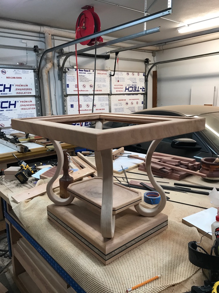

Posted: Mon Aug 28, 2017 6:37 pm
by masonsailor2
Managed to get the inlay done on the small table this morning. Now for the difficult one.

Posted: Tue Aug 29, 2017 11:23 pm
by masonsailor2
Got a while in the shop today. Finished the inlay on the table. Now a long day of sanding.

Posted: Wed Aug 30, 2017 10:01 am
by rjent
Wow ....
If you had planned to do this from the start, would you have cut the inlay parts before assembly? Just curious
Looks amazing! :cool:

Posted: Wed Aug 30, 2017 10:42 am
by masonsailor2
No because it would make assembly of the sides too difficult. Usually impossible. Trying to align the mitered corners is difficult enough without having to align the dados for the inlay. Much easier to do after the fact because then the inlay dados are perfectly aligned. Also I find it easier to size the dados to the inlay rather than the other way around. There is very little chance of tearout when routering the dados if you have the cutter fully enclosed and clamp a follower onto the piece to protect the exit of the bit.
