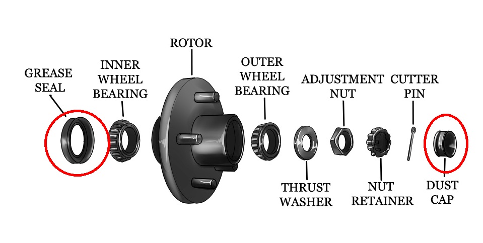

jsburger wrote:
Hobbyman2 wrote:I use to service semi trucks ,years ago I was taught when greasing a bearing you squirted grease into the bearing until it came out clean and wipe off the dirty stuff, now you are taught to give them 1 squirt and no one wipes any thing..
Please correct me if I am wrong. Vehicle wheel bearings were not sealed in any why. We took them out, washed them in solvent and re=packed them with grease. Hardly the same thing as sealed ball bearings that for the most part don't need to be lubricated.
It was the drum/rotor assembly, not the bearings themselves that were sealed. Rear seal and a dust cap on the front. They were grease-capable.
Everett
Expanded diagram of a rotor with a hub and bearing assembly.jpg (83.65 KiB) Viewed 8391 times
Hobbyman2
Posts: 2673
Location: Ohio
Re: Best Bearings Available
Post by Hobbyman2 »
Good picture .
adding bearing buddies helps keep the bearings greased , race's are a pain to split off the spindle.
