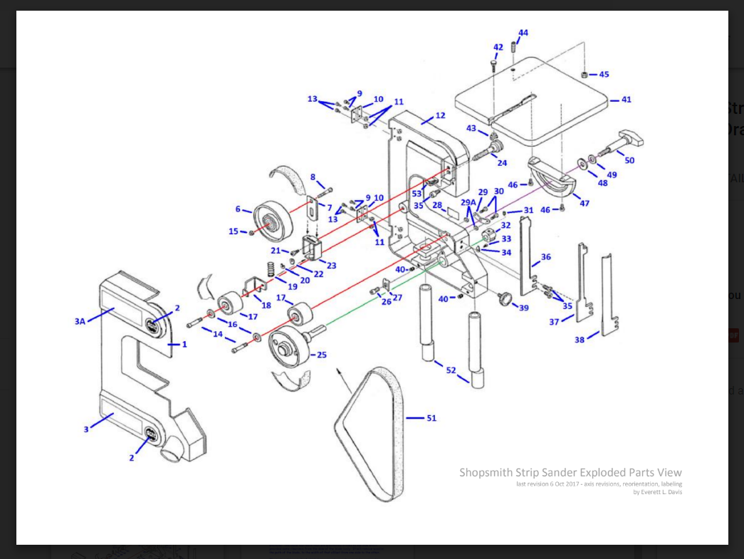

Belt Sander and the Strip Sander are now included. Each have new large drawings as well.
Everett
