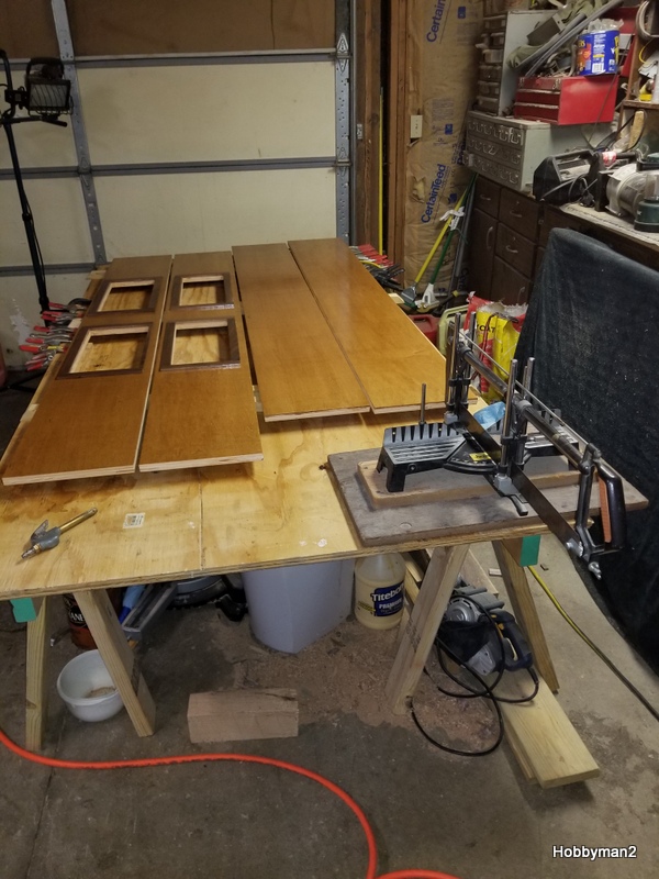

It split because it shrank more? Gotta wonder about the grain direction.Hobbyman2 wrote:You are 100% correct ,, they do that from humidity from my knowledge , when the board absorbs humidity it grows, when it dry's it shrinks, since 6% is about a low as it can go,,,, fingers crossed it will be good ,,,,,I got into a rush years ago making a raised panel cabinet door out of a mix of woods,, ,, I was 1 piece shot ,,so I put in a piece of wood at 8% moisture and the rest were around 6% ,even though the door panel was floating,, no glue,, the board split after a coupe years .

Could be , none of the other 3 doors had a issue though . my guess was it dried out and split.

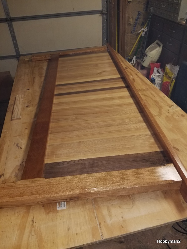

getting there
Re: bed build
Rails next? Looking good so far!

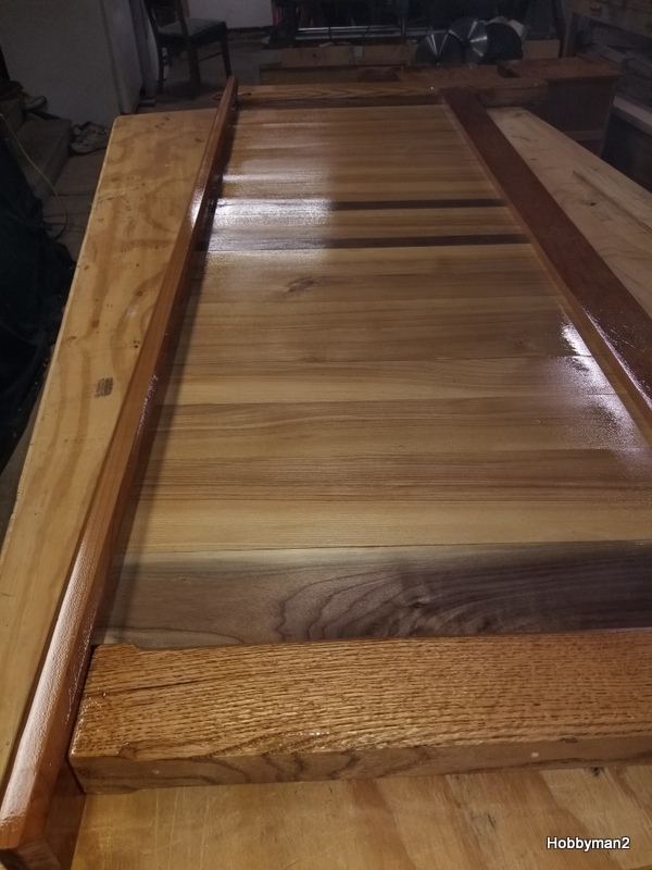

Building a box that will resemble a water bed frame.,,, better half wants drawers in the bottom that her dad made nearly 30 years ago.

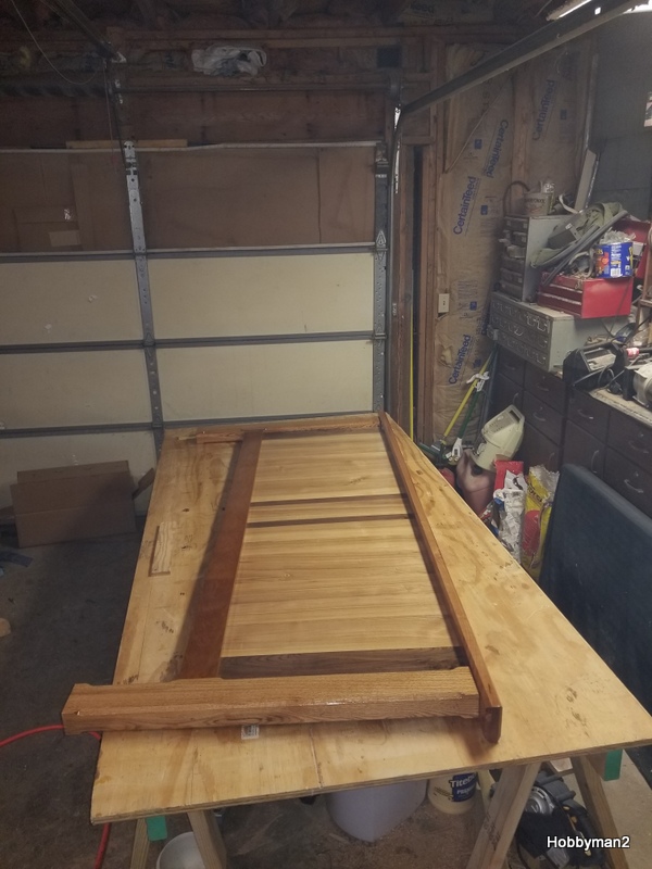

the frame for the drawers is almost complete ,

Looking very good !
