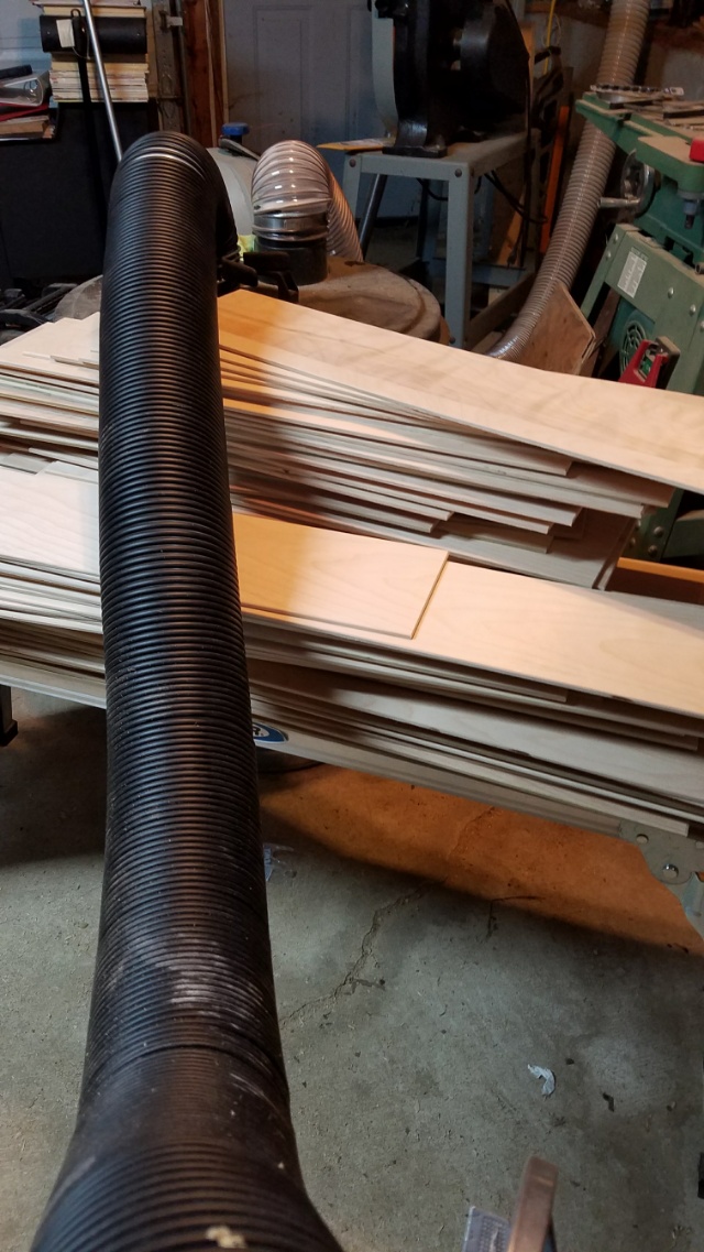

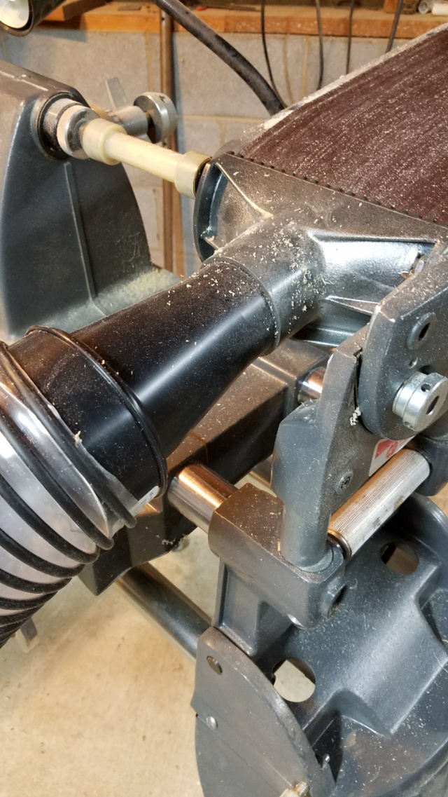

Figured I'd post this since I am using wall mount HF DC that vents outside. Two stage and works remarkably well I thought even with the belt sander. I started without using anything, just a mask, then went to woodcraft and got a proper fitting. Awesome. Waaaaay better than the SS DC I had.

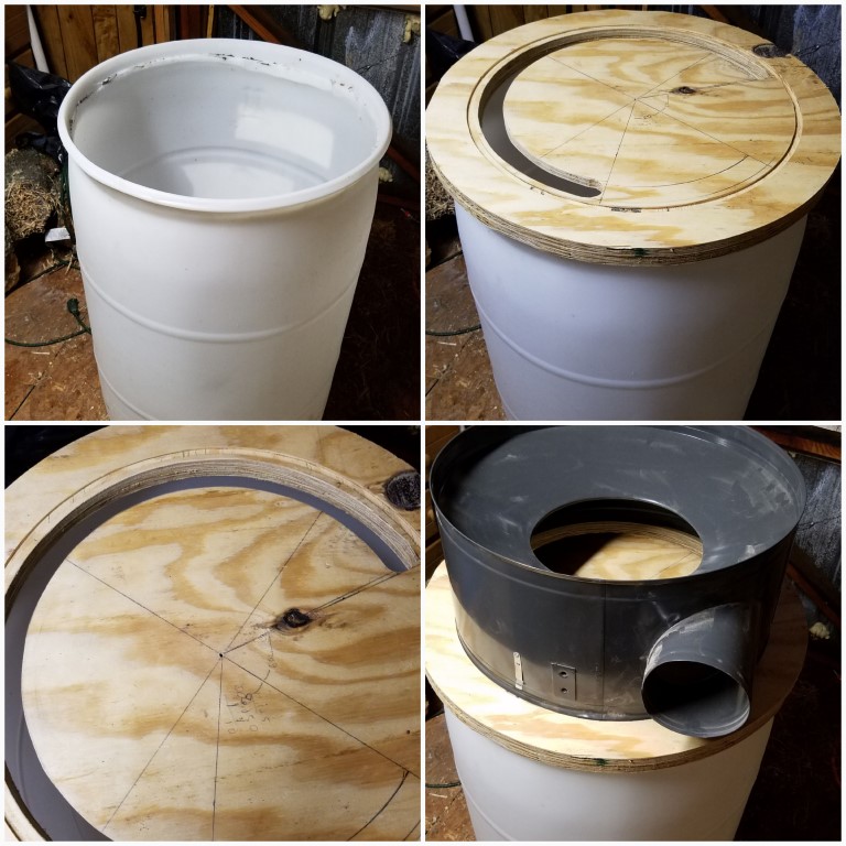

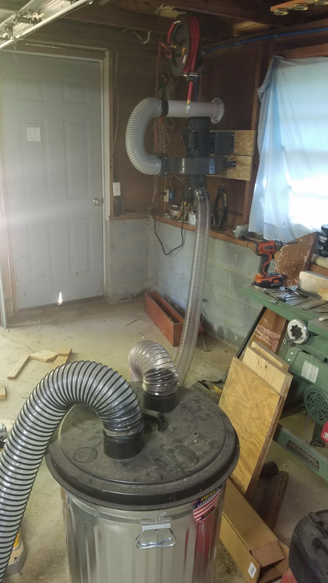

I finally picked up the HF dust collector a couple weeks ago. It sat in a box until this past weekend when I was finally able to get to doing something with it.
I assembled it as designed stock to give it a good test. My test wasn't so great because I don't have any 4" flex hose to connect to the inlet. So I 3D printed an adapter to connect my 2" Shop Vac hose to one of the inlets. That significantly restricted the airflow and it didn't generate the "cyclone" effect in the bag, but it still performed better than the Shop Vac and was enough to help clean up. I could tell the top filter bag was useless.
So yesterday I set about modifying it. While I'm doing some of the details a little different, conceptually I'm following this instructable, using the same style of plastic drum, putting the separator with a Thein baffle on top of it, and the motor/impeller on top of that and venting outside: http://www.instructables.com/id/Making- ... t-collect/
After a late start, some trial and error with the circle routing jig (neither the drum nor the separator were perfectly round), I only got as far as getting the separator/baffle on the drum.
I could have gotten further, but I mainly didn't want to walk through the rain to the storage shed where another piece of plywood was at. And I still need to get some hose and pipe to fully implement it. I still have a long way to go, but I'm glad to finally be making progress.
I also had another idea. Instead of a separate "air cleaner", build a box on my ceiling with some vents around it and pipe the dust collector to draw from it. When I'm using another tool, just close the blast gate to it, when I'm not, open its blast gate. It may not be perfect, but it's at least worth testing out.
