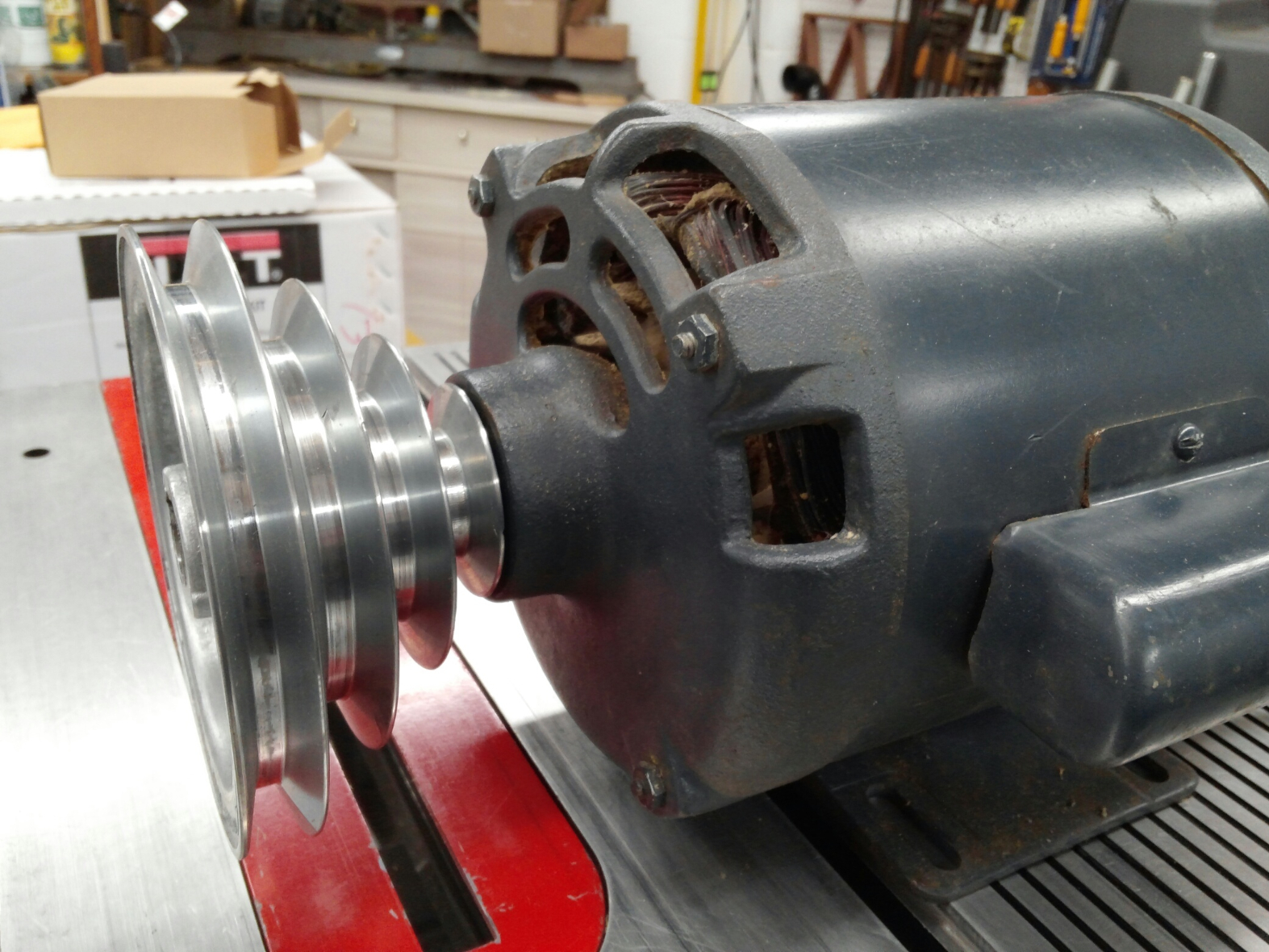

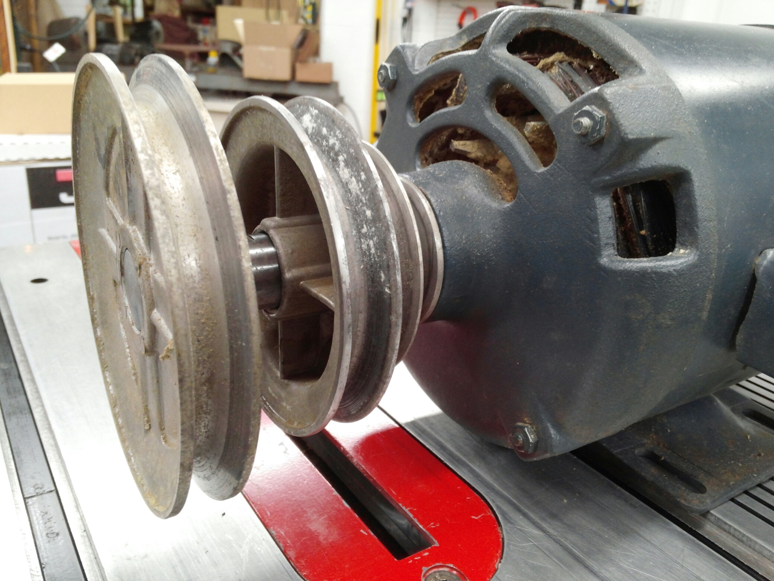

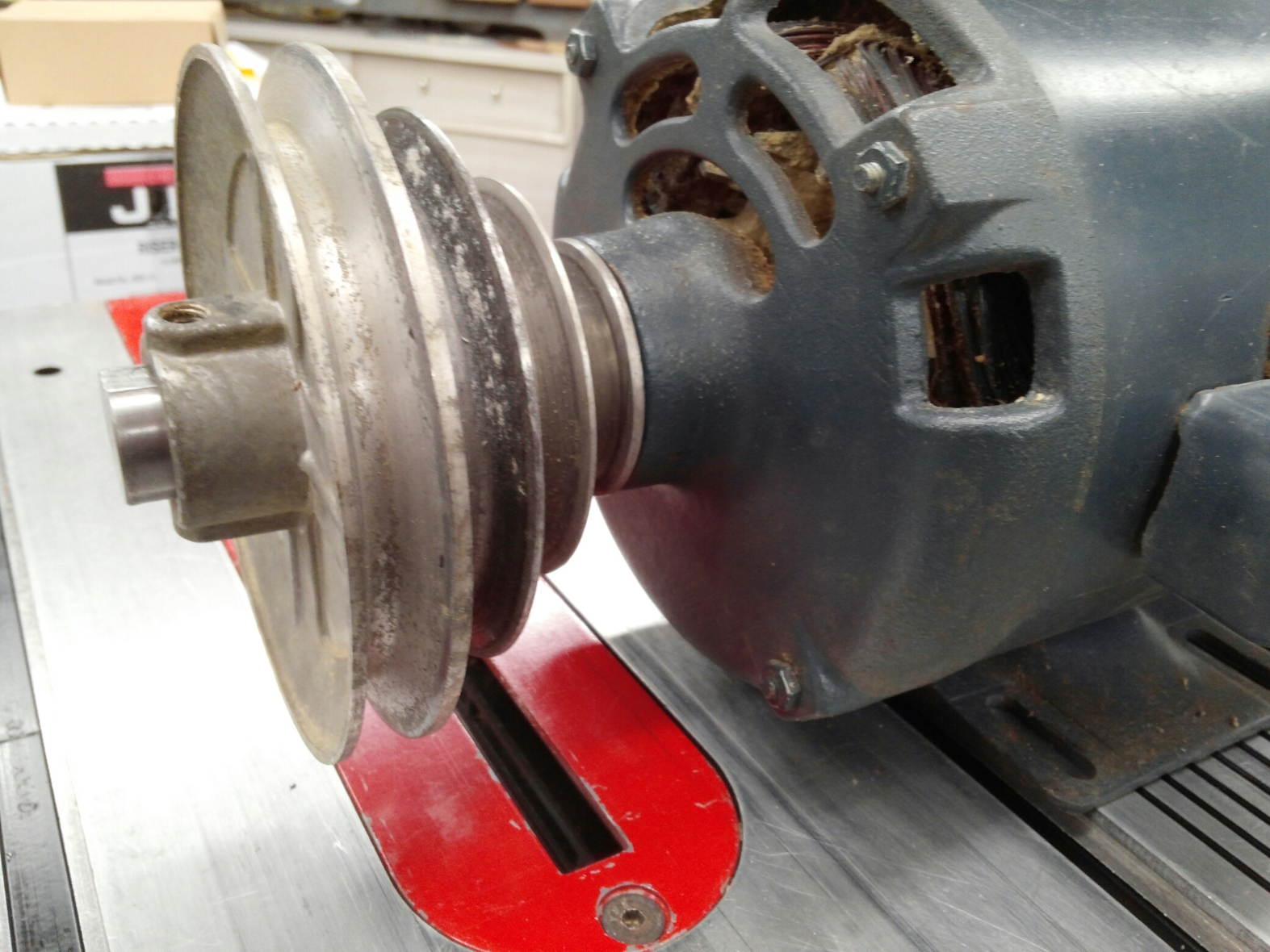

Based on the 5" pulley spacing options, and especially given that I have a speed changer, I'd buy the 10ER motor drive adapter from Skip too. I didn't even know that he sold that adapter setup. But for the record, here's what I found when I compared the Congress Drives pulley to my original 10ER pulleys.jsburger wrote:I am pretty sure it will. Also see Skip's picture on MKCTools.com of his jointer motor pulley. It is at least an inch away from the 3 step.BuckeyeDennis wrote:I noticed that too. But what I don’t know is if the headstock pulley can be reversed, instead of the motor pulley. It might interfere with the pulley guard.jsburger wrote: If the diagrams (not picture) in the Magna jointer head rest manual are correct as to the pulley spacing your pulley should work without the speed changer. It will not work with the speed changer because with the speed changer the three step motor pulley is installed reversed.
First, here are the original pulleys, mounted as I received them -- I checked the original Craigslist photos to be sure. I can't say for certain that they're mounted correctly, as my machine is still dismantled and awaiting restoration. But without a speed changer, it does match the illustration in the 4E jointer mounting instructions.
Next, here's the new Congress Drives pulley, mounted directly on the 5/8" motor shaft. The geometry is identical, and the pulley runs perfectly true. Grainger sells the exact same pulley for $70.
And finally, here are the original pulleys again, but with the 5" pulley reversed and mounted outboard. They look a lot like Skip's setup that way, and would indeed give you some flexibility in headstock positioning when using the jointer.
