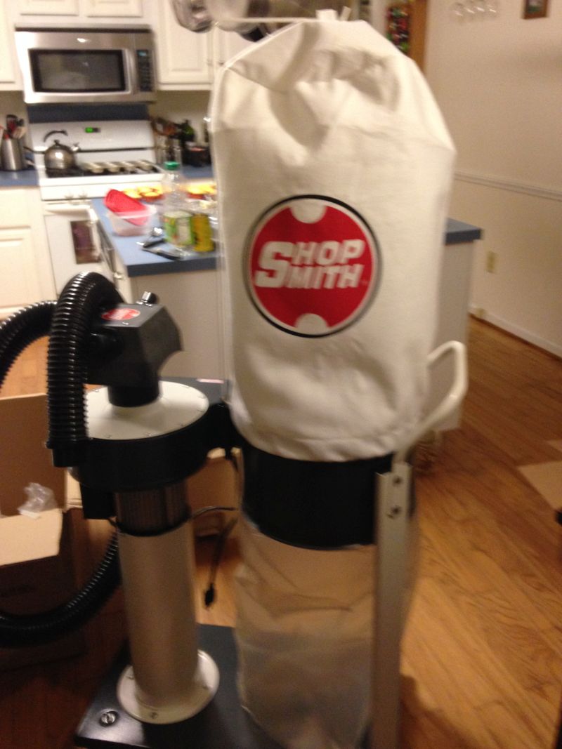

I received my DC330L yesterday afternoon. I hope everyone is familiar with the realtor that says I have this cute house on Maple Street I would like you to buy. Read she couldn't unload it on anybody else. That's how I initially felt after putting together the new dust collector.
To be fair to Shopsmith though they know their market and have purchased a dust collector that will be very suitable for the person with one Shopsmith and a couple SPTs. It comes in two boxes. The main box proudly states Made in China. The second box has the instructions, three way adapter with plugs and the hose. The bag has the Shopsmith logo.

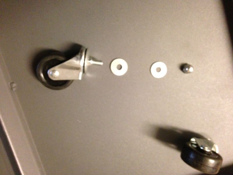

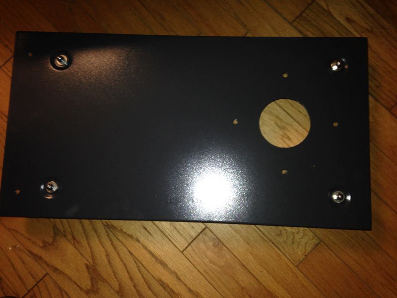

While the caster has a nut to hold it while tightening there is not room for my metric wrench to hold it.  I had to hold the outside of the caster with channel locks to install it.

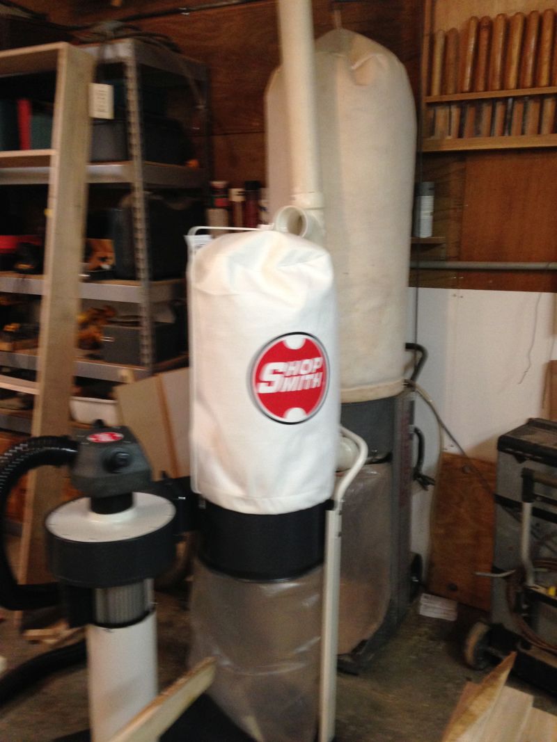

I have no means to check cfm but I tried picking up a scrap of wood with the DC3300, it did, and the DC330L would not pick up the same one.
Cons: The dust collector has a smaller collection bag at the bottom. Edit: Added bag sizes DC3300 30 gallon and DC330L 16 gallon.
There are no clips to hold the plastic bag up while installing the strap.
Really poor instructions. Missing six nuts and two washers. Of course they were metric so I had to get some standard bolts and nuts out of the shop to put it together.
Pros. Just under the Shopsmith adapter the inlet was divided to stop large items from getting into the vanes. May also be a con. A prior brand I had was built similarly and planer shavings would plug it up.
I haven't measured the footprint yet but it is more narrow.
