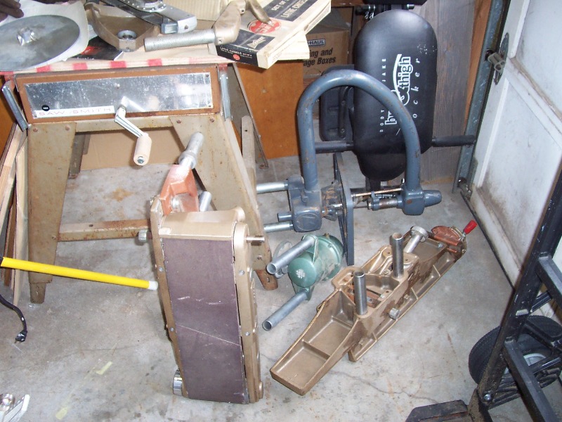

The pix below was originally posted by JohnMcCrossen to show the 'original goldie color scheme(s). It also shows that goldie vintage spts came with STRAIGHT tubes.
[ATTACH]3308[/ATTACH]
- goldie tubes.jpg (153.39 KiB) Viewed 3424 times
