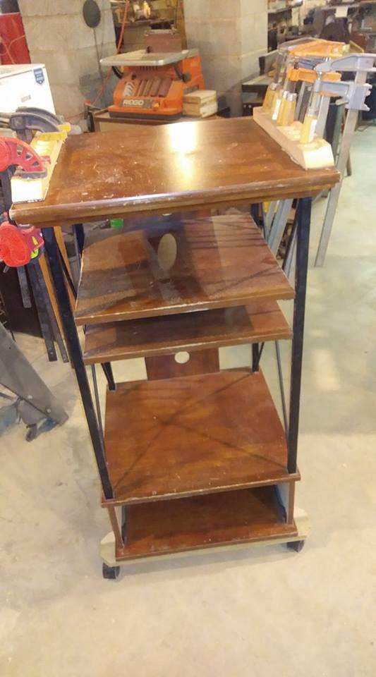

I'm in the very early stage of converting an old but sturdy electronics stand into a mobile woodworking clamp rack. Lower center will be drawers and bins for C clamps, spring clamps and several other types. A row of Pony pipe clamps will mount across the back. This is a stand I picked up at a yard sale for a buck or two some time back with the intent of making a router table out of it before I changed my mind and decided to use a Shopsmith base instead. It is remarkably sturdy with a steel frame and steel "X" braces in each side.
The two upper side strips (a couple of brick mold scraps) have 1" holes drilled in them 1.25" apart for the clamp handles to drop in and I will add a notched lower rail for the lower end of those clamps.
I cut a couple of scraps of rough sawn tulip to make caster supports. I didn't bother to run them through the planer since they were short but they were uniform size so I just ran them over the jointer. I like to crowd casters out a couple of inches on such things for a bit of extra stability.
Before I go any farther on it I need to do a clamp round-up... I think there is a couple in the work van and I know there is still a batch in the farm shop. And maybe... :o :)
The paint I bought for the woodshop is a light yellow with a darker more gold yellow for most trim I have a light gray for an accent color. I may use some of that light gray to paint this rack.
I considered just starting from scratch with all new material but that just isn't me. I really enjoy adapting and modifying stuff. :cool: To me it's more fun than just making something. :)

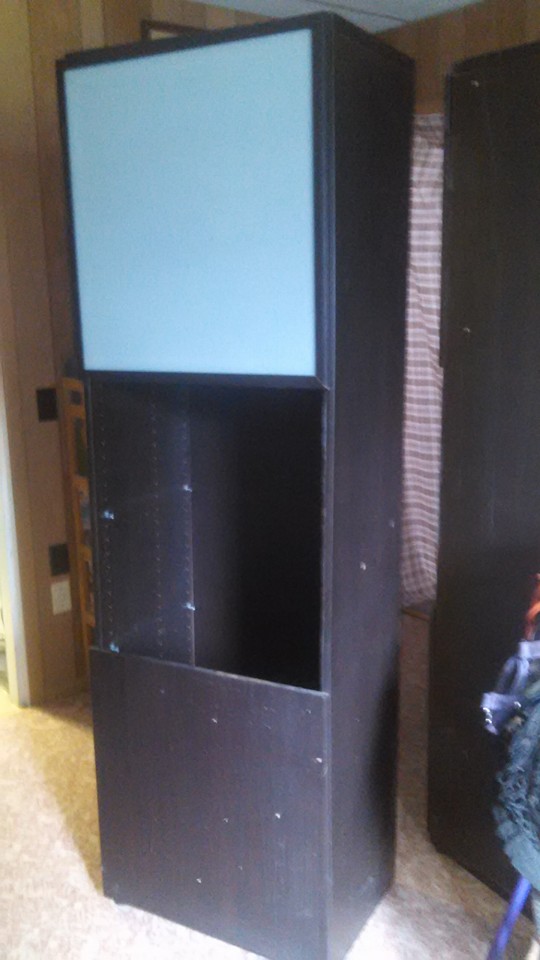

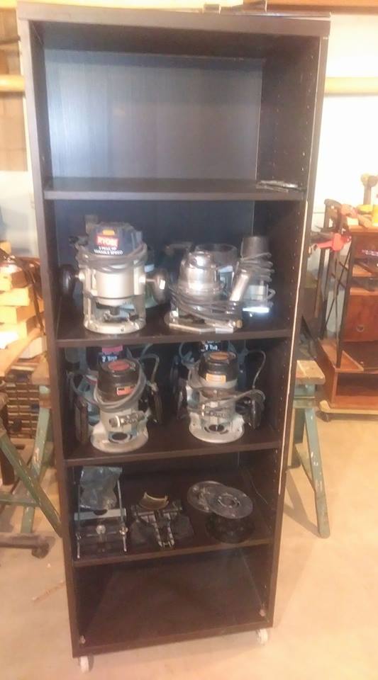

As I flit from project to project I'm doing a router tower from an electronics cabinet. This will follow the router table around wherever it happens to sit. This started life as one of a pair of electronic component shelves with a frosted glass door at the top and another solid door at the bottom. I cut it down in height about a foot and put it on casters.
The top shelf is for router bits. in trays with holes. I'll leave the bottom shelf empty and let the shop elves fill it up. :D
I figured that the black finish would suck up light like a black hole and it does. I'll probably paint it a light gray I have like the clamp tower.
I don't want any doors on it but I might find another use for the doors? (shrug).
Note that the camera angle made the first picture look like the cabinet is bigger at the top but it isn't. It's all just straight.

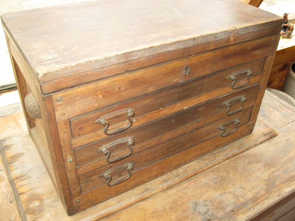

Here is a picture of my grandfather's first machinist box. I should probably make one like it before I do the Gerstner style. BTW, if you do a Google image search on
Gerstner machinist box
you can see the style. Most of the metal ones I have are the basic 7 drawer style.

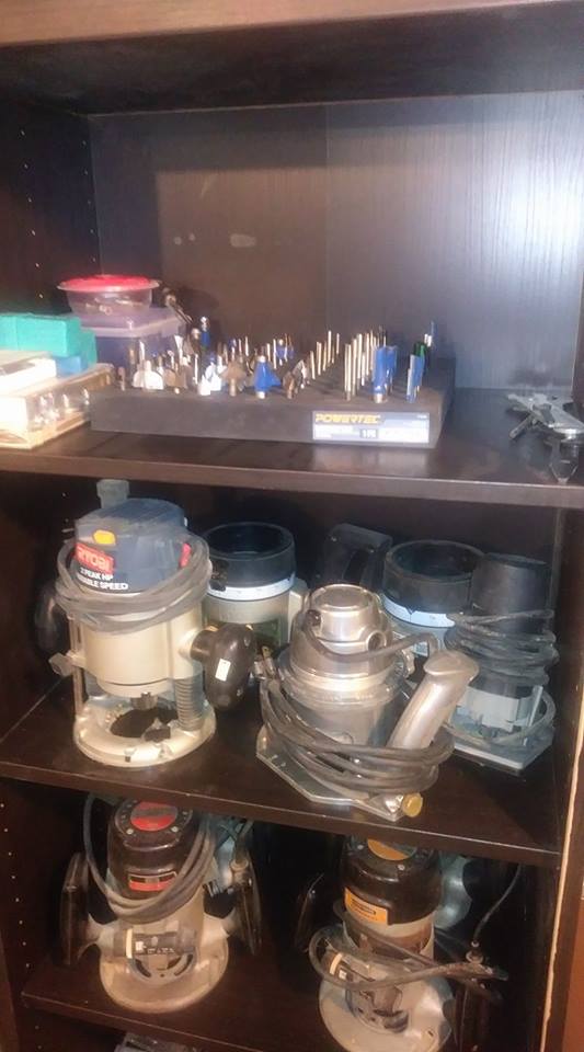

Here is another shot of the router tower I'm working on. This shows the foam bit holder I bought from Amazon. It will hold 60 1/4" shank bits and 50 1/2" shank bits. I don't have a lot of 1/2" bits nor a lot of large bits. For larger profile cutters like matched rail and stile, T & G and cabinet lip and others, I had bought shaper cutters instead of router bits. I also have a decent batch of molding cutters.

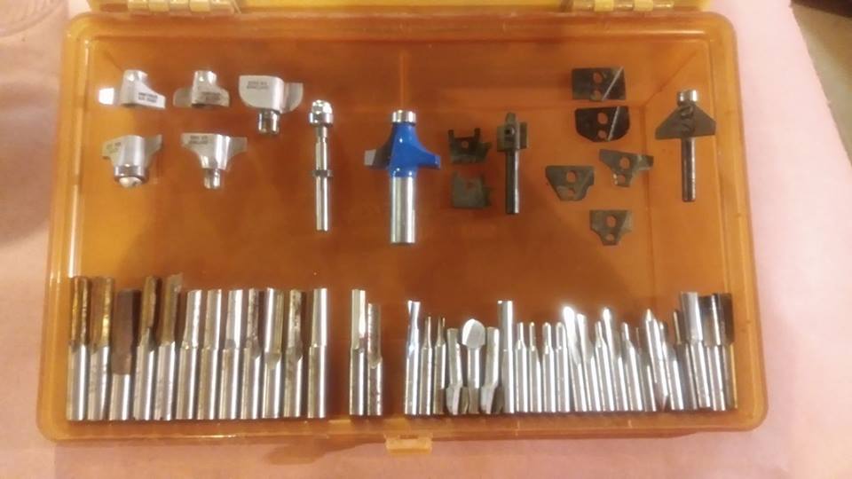

This second pic is a bunch of bits that I have not "homed" yet. I tend to think of router bits as either 1/4" shank or 1/2" shank. The dozen bits at the lower left are 3/8" shank and the 2 in the center are 5/16" shank. I see that I can buy a 3/8" to 1/2" adapter for about $10. I could make one but by the time I dug out the metal lathe in the farm shop and got everything sat up I would probably lose a day. The larger blue bit in the center is 1/2" shank and I just stuck it in there for scale. Five of the 3/8" shank bits still have the protective goop on them.
