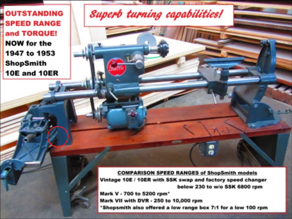

I just noticed in one of these videos he has the new 4" jointer with rod mount casting mounted to a 10ER 4E headrest. If you look closely at this screenshot you can see the beefed up area (which I previously called "tabs") on the headrest casting where the jointer contacts it. I've circled it in red. My headrest does not have these, the legs are the same thickness all the way down.
Here is a link to the video I grabbed that from: https://www.youtube.com/watch?v=-Zk51fhHq-0
edit: Everett, I just noticed your "Dropdown Jointer 10ER.png" on your Google Drive is cropped out of this same photo. Do you know whose machine that is?

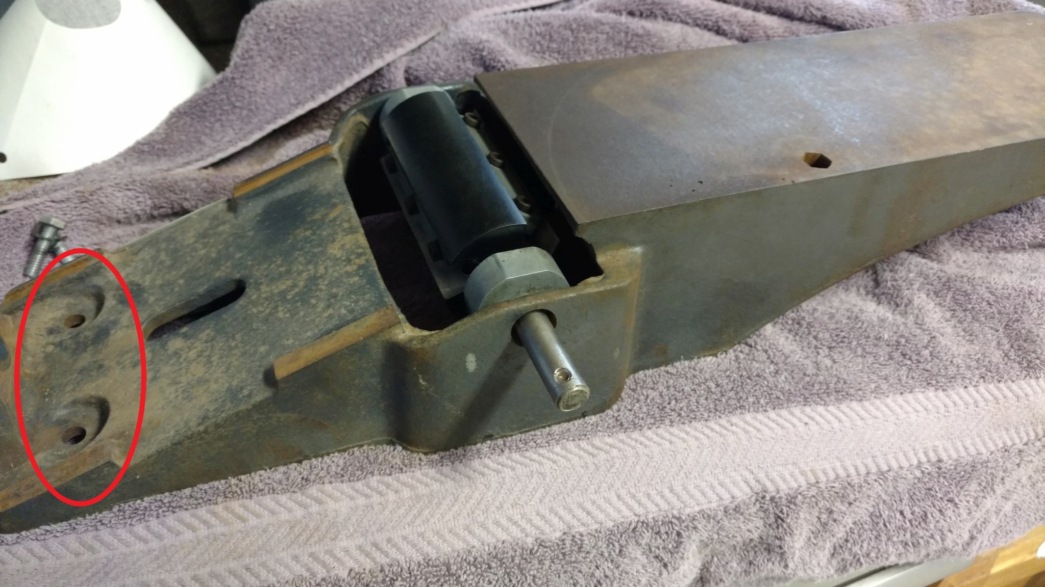

Also, what would the jointer mount to using the cast mounting holes circled in my picture below? Was it ever intended to be run from its own base and motor?

It is the same sort of view of a machine, but it is not the same machine photo. I think I got the original photo from the late Bill Mayo back when I was working on restoring an original owners guide.badtheba wrote:Does anyone know who used to own shopsmith10er.com? It is a placeholder domain now so they either let it expire or a speculator grabbed it up, but the old owner has a couple Youtube videos I've saved.
He snagged it somewhere else for me when we were discussing the 10E / 10ER models, at a time after he sold that segment of his business to Hog Winslow some time before.
Everett

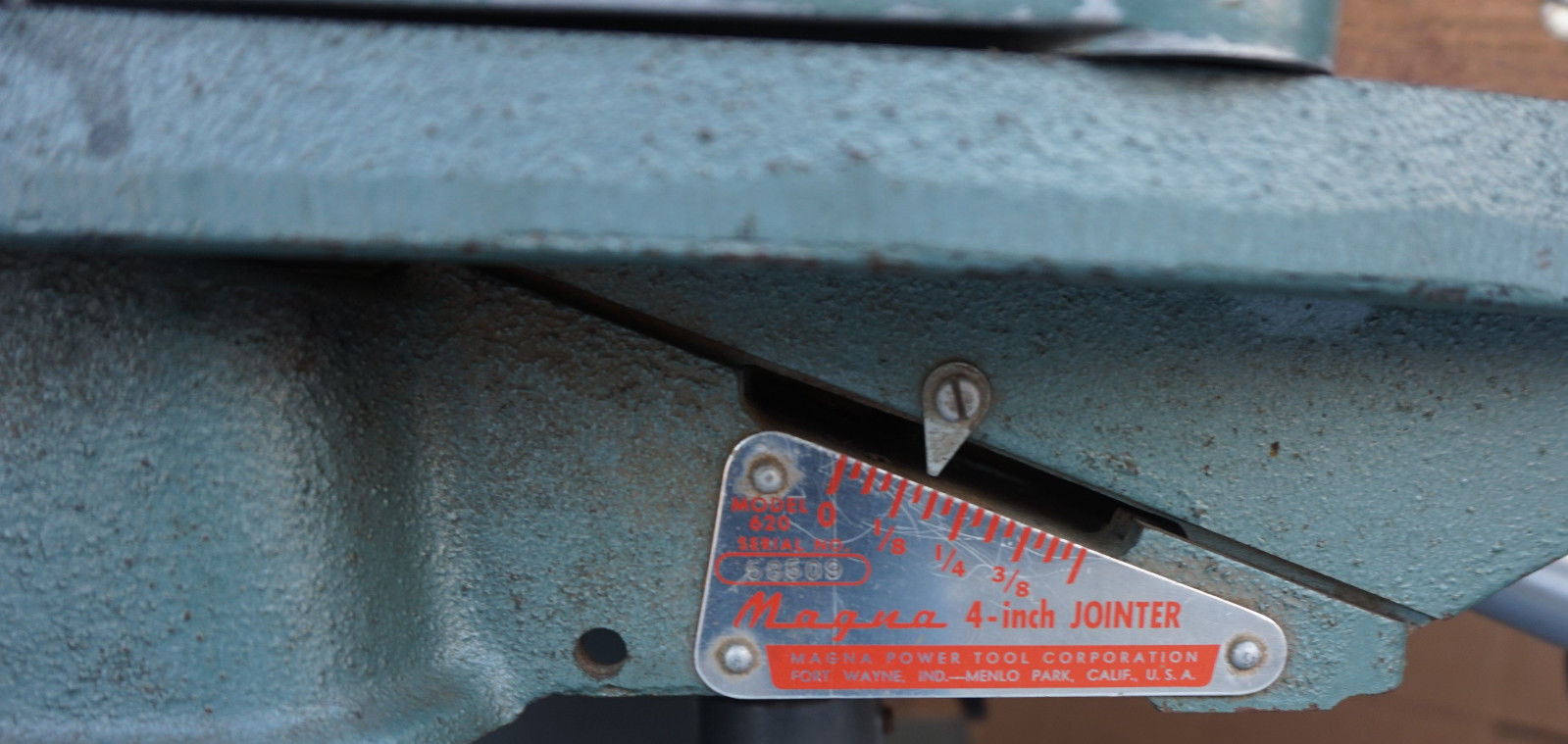

The 4E Jointer of course had the holes for mounting it to the Model 10 Jointer Headrest since that was the only way to attach it. The Model 620 Jointer, like Scott Grune's Model 620 Jointer shown previously, added the SPT mounting posts but still had the holes for mounting it to the Model 10 Jointer Headrest. In the photo is a 620 Jointer from 1957, notice the hole next to the plate. When the 620-C Jointers came out Magna had discontinued the Model 10 Jointer Headrest Mounting Holes. The Base/Out-feed Table is the part that changed between the Model 4E and Model 620 Jointers adding the SPT mounting posts.

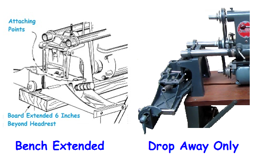

The holes circled in the picture could be used along with a third hold on the other side of the cutter head underneath the table to mount the Jointer to a home-made bench.
Of note: the 4E Jointer with drop down headrest comparison.png from Everett above is not a picture showing a 4E Jointer but a 620 Jointer mounted on the Model 10 Jointer Headrest.

badtheba I agree with you that the cropped picture Everett is using is from the one of the Model 10ER with a Jointer that was identified as Scott Grune's. Notice the part attached to the motor mount at the pulley end, not a stock item. You have a good eye for details.
Re: badtheba has discovered something we didn't know existed
Yeah I thought it was the same image, only stretched a bit and the background edited out.chapmanruss wrote:badtheba I agree with you that the cropped picture Everett is using is from the one of the Model 10ER with a Jointer that was identified as Scott Grune's. Notice the part attached to the motor mount at the pulley end, not a stock item. You have a good eye for details.
