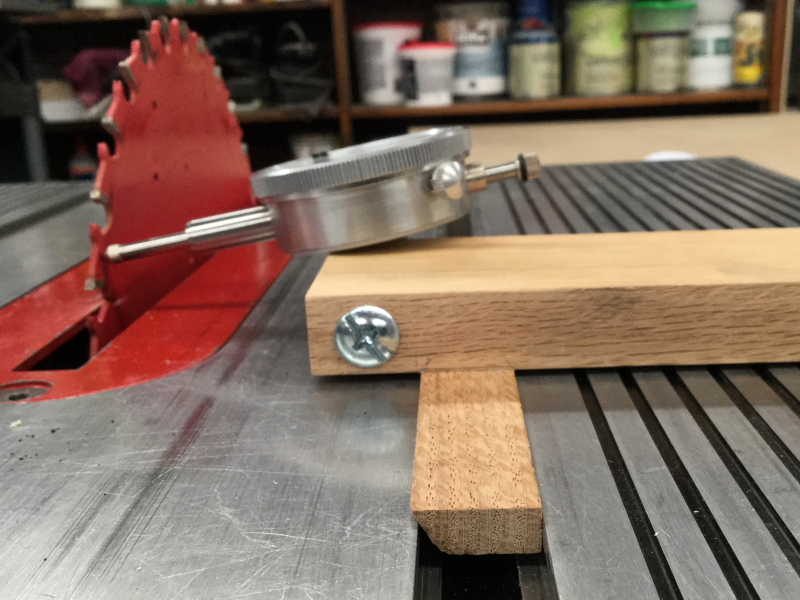

I like shiny too. So I just might spring for one of those A-Line It tools, if I can get the half-price deal from Peachtree. I signed up for their email specials today after seeing John’s post, but so far they haven’t emailed me that special. And their website still shows the regular price.
But as a practical matter, my home-brew hardwood alignment jig works perfectly. I cut the back side of the “miter bar” square. But the front side is cut on about a 30 degree angle, so gravity shoves the square edge back firmly against the side of the miter slot. There is absolutely no slop, but it still slides freely.
Gauge 1.JPG (454.31 KiB) Viewed 15303 times
Gauge 2.JPG (422.58 KiB) Viewed 15303 times
