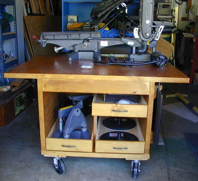

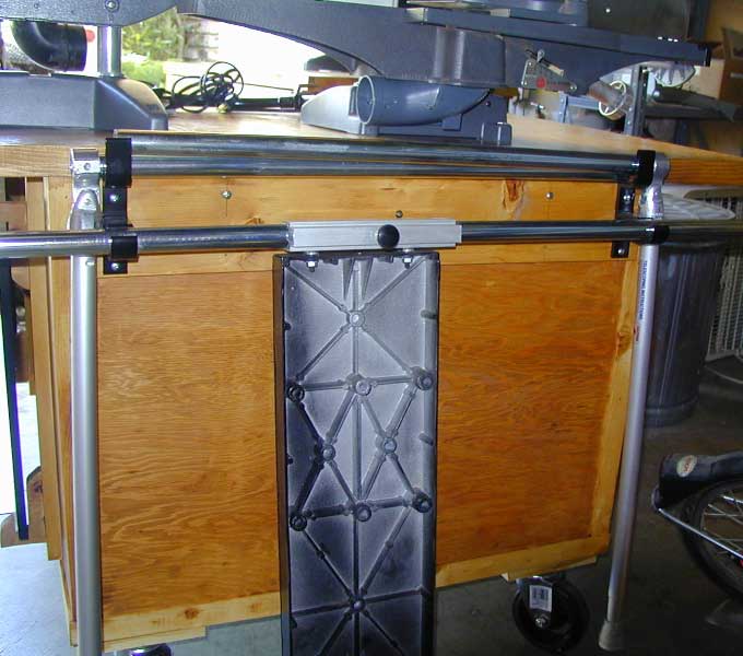

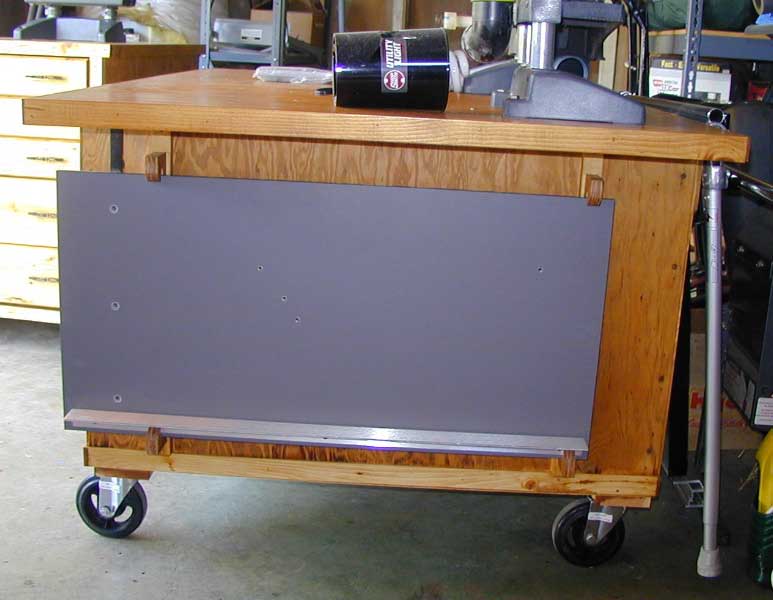

Many years ago, I was getting pretty frustrated with not having any place to store all the SS parts and accessories. My four walls in the garage were/are already filled up. My frustration maxed out when I purchased the connector tubes, tables, and crosscutting sled. I just had to come up with "something" because I was now running out of floor space.
The answer came to me when I was looking at my "Four Walls"! I decided to build, out of scrap wood, a torsion table top, with "four walls" on wheels! One wall holds my cross cutting sled, another holds my connector tubes, tables,etc., the third wall holds all my saw blades, and finally the fourth wall is "open" to hold my lathe accessories, fence accessories and anything else that will fit in the opening.
The below pictures taken during the construction phase only shows three sides of the unit. The side not seen is the saw blade side. The torsion top now holds my Jointer, Belt Sander, and Strip Sander, and still has enough space for one or two more tools. The entire unit can be easily moved around because it is on wheels.
I also built a second cabinet on wheels, using basically the same method,.....torsion top, on wheels, and room for future "purchases", that consists of drawers, and currently holds my bandsaw.
My scrap wood was put to good use, and my space problem was somewhat solved!
Best to All!

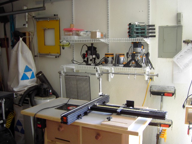

Just one more storage option. I opted for the closet type (wire) shelves because they wouldn't collect dust like solid shelves and the clothes rod holder would handle the aux. tables and legs. I think I will add a third rod holder for the middle to keep from bending the pole.
