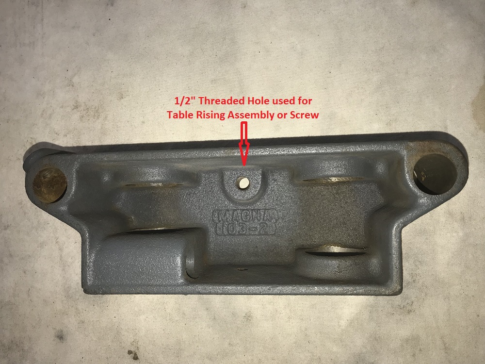

They had to have plans for some kind of accessory to attach in the 1/2" Threaded Hole in the carriage since it has been part of the Carriage casting from the beginning. Below is the Carriage from S/N 1077.
103-2 marked.jpg (347.46 KiB) Viewed 22127 times
The 1/2" bolt for attaching the "first" Table Raising Assembly may be overkill but not for the Crank Screw that raises the Arm that attaches to the table post in the more common Table Raiser. Now it has me just wondering about their thought processes.

chapmanruss wrote:They had to have plans for some kind of accessory to attach in the 1/2" Threaded Hole in the carriage since it has been part of the Carriage casting from the beginning. Below is the Carriage from S/N 1077.
Which is all why I questioned the order of release. Here is a list of what I think is questionable.
1. All carriages have 1/2" holes. As you say it is the right size for the crank but I think it is way over kill for the other table raiser. So why was such a large bolt used for the non crank table raiser if it came first? If it didn't come first it was there so they used it.
2. The table raiser brochure mentions eliminating tedious cranking. Why would you mention that unless you were talking about your own product. It does not make sense to me that they would be talking about some unknown machine by some unknown manufacturer.
3. Why mention in the brochure that the table raiser mounts to the 1/2" drilled and tapped hole that all Shopsmith carriages have if that hole was put there in the first place to attach that table raiser.
But there is a fly in the ointment. Your point about the part number is a very valid one. It could be that the table raiser was an early design improvement that got assigned a part number and never got produced until later and the part number was never changed.

You wrote commenting on my previous post about the 1/2" threaded hole being there from the begining
We will probably never know.

My thought on your item #1 - Is it possible that both systems were in planning when the first 10E's were being made requiring something on the carriage for them?
