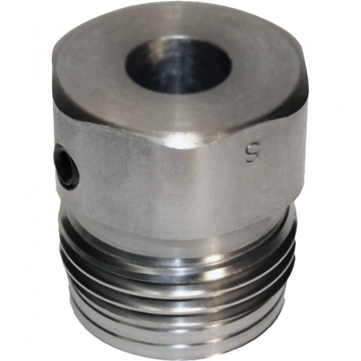

If your chuck adapter comes loose, there should be enough depth in the setscrew hole once you bottom out the setscrew on the spindle bevel, to add a 2nd setscrew as a jam-nut against the first if they are short, with loctite vibration thread sealant.
Make sure the 2nd setscrew has a flat bottom so as not to distort the hole of the first.
Put a drop on both setscrews, then let it dry before inserting them.
I got my Nova adapter from Rockler and haven't had it come loose yet.
Everett
Nova Lathe Chuck Insert Adapter from Rockler.jpg (30.99 KiB) Viewed 12399 times

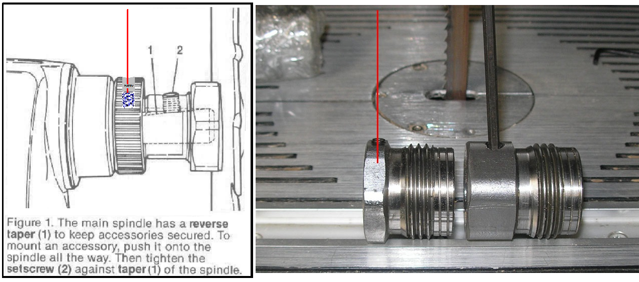

I realize that we have drifted off the original subject after the poster resolved his initial problem, so I will add this last piece of info to the altered topic, and changed the title in it.
I finally found a post I was looking for relative to 5/8" NOVA Adapters that illustrated a key point in those designed for Shopsmith 5/8" Spindle's Reverse Taper from forum member bobgroh posted Jan 10, 2013. I knew I had seen it before, and it took me a good bit of time to re-locate it. Reference: http://www.shopsmith.com/ss_forum/viewt ... 51#p135951
Also reference Figure 1 that illustrates the reverse taper on the main spindle. Note specifically that the bore of the setscrew and thread is perpendicular to the taper (not the adapter housing), meaning it is not bored straight in, but at the same angle to maximize the holding power on a tapered Shopsmith spindle.
Contrast the Type F Nova Adapter (left) and the Type S Nova Adapter (right) in the photo.
I added a red line to the original photo to better illustrate this issue, and added a setscrew covered with putty and red line to illustrate the contrasting straight bore for the Spindle Knob in Figure 1.
It is vitally important, and can help you identify a 5/8" arbor or adapter made for Shopsmith opposed to a plain 5/8" arbor or adapter made for something else.
Everett
Compare Saw Arbor to Nova Lathe Chuck Adapter.png (749.11 KiB) Viewed 12351 times

I agree with you Everett but we have been down this road before. AFAIK, none of the 10ER stuff has angled set screws. Also some of the early and later MK V stuff does not have angled set screws. I posted pictures in a thread a long time ago that shows that. I still have the pictures but the thread is here somewhere. Yes, I think they all should be angled but that is not an indicative way of telling if a particular arbor/adapter is SS or not.

Since there is no torque load on the collar, there is no requirement for the angled set screw even though there is a reverse taper flat that it tightens down on.
The tapered set screws are a recent change and I believe only necessary with greater torque loads(saw blade/chuck/steel sanding disc).

I would love to know more and see John's other thread. I can't remember who pointed the angled bore on the adapter out to me but I internalized it and it stuck in my mind.
There are flat set screws in angled bores and tapered set screws in straight bores that match the bevel? Is that what I should looking for?
Now I have to look at what I own to see what's there.
I am sorry if I made it more confusing. I heard it at a demonstration in the mall and never physically examined the topic much beyond that. Come to think of it I guess he might have been pointing out a change in design, opposed to how it's designed.
