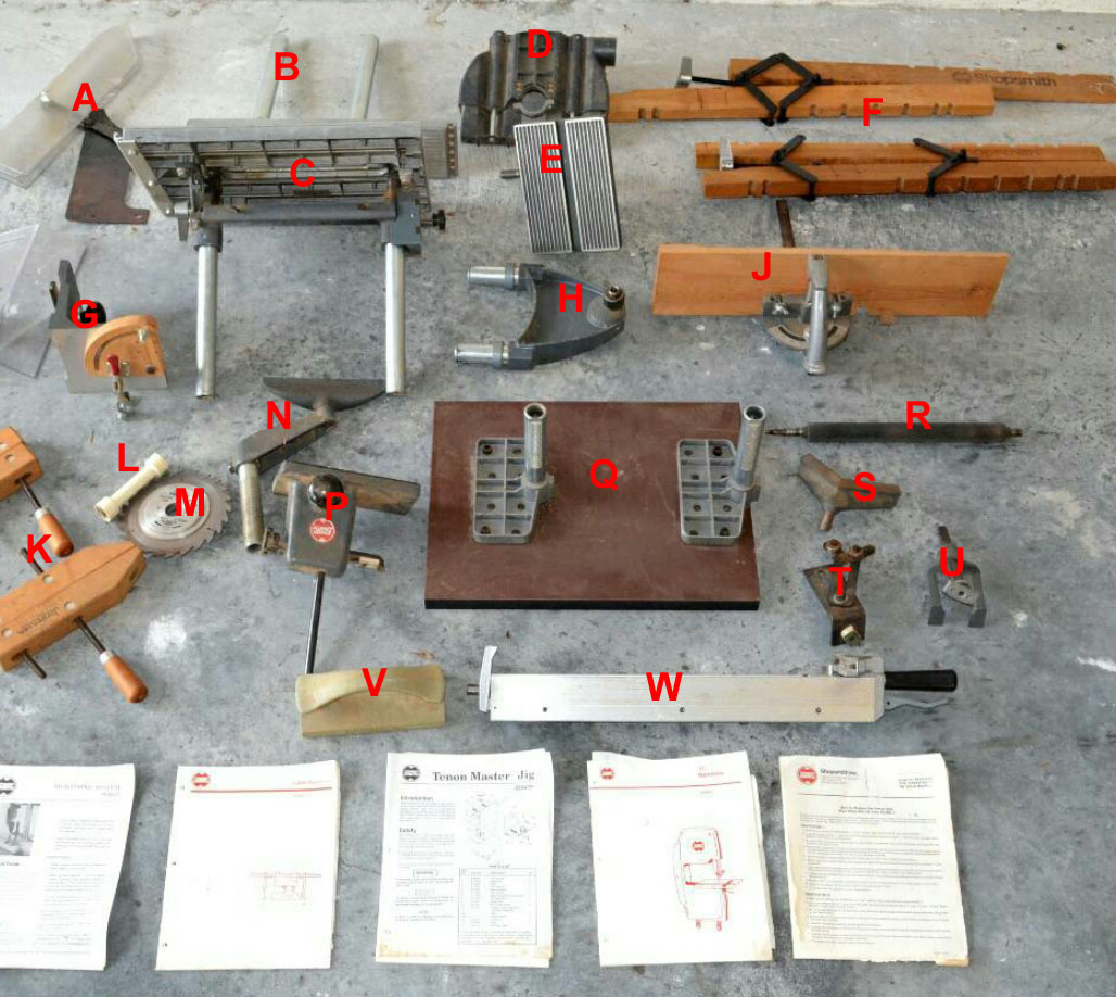

Very nice start! Your base machine is about the same age as mine (1980), maybe a little newer. The upper and lower guards on mine were metal, but I have upgraded the upper guard. To help make identifying your assortment a little easier, I added letters to your photo and will start off identifying those about what I am most sure. I'm sure others will correct me where I may wrong, and fill in the missing blanks where I am not sure.
A = Upper saw guard, but may be a for a 505/510/520, not a 500.
B = Extension table (narrow)
C = Main table, with bracket for attaching upper guard attached
D = Lower saw guard
E = unknown. This may be the non-Shopsmith part to which JPG was referring
F = Shopsmith Double Bar Clamps
G = Tenon Master Jig
H = Tailstock, with live center perhaps?
J = Miter Gauge with wood extension fence added
K = Clamps
L = Power Coupler, for attaching SPTs (Special Purpose Tools), such as Bandsaw, Jointer, etc.
M = Saw Blade ... can't tell what type. Maybe a wobble dado?
N = Lathe Tool Rest
P = Part of Lathe Duplicator
Q = Part of Lathe Duplicator
R =
S = Specialty Tool Rest?
T =
U = Mortising Hold Down
V = Safety Push Block
W = Rip Fence (upgrade version)

R = Planer feed roll(likely original that has been 'upgraded' ).
T = Steady rest(backup thrust bearings) for lathe duplicator.
E is non SS small table.
S is correct
S is correct

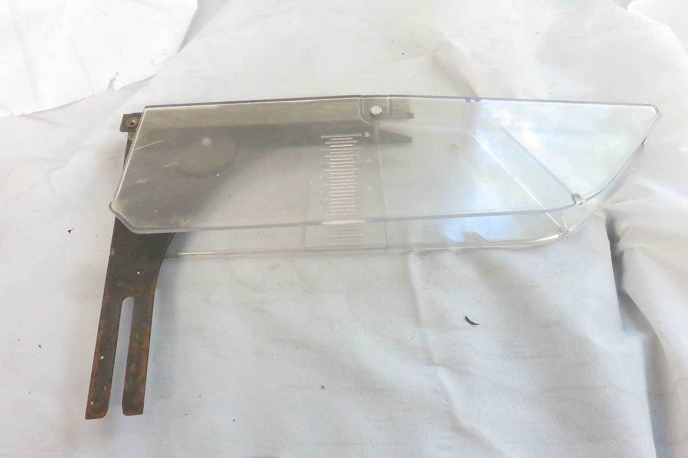

I've tried to identify the upper guard, and it doesn't look like the upgraded 500 version or the 505/510/520 versions that I have seen. Perhaps it too is non SS? However, the bracket on the back of the table looks like the piece to mate with the upgraded 500 version.
- Upgraded version of 500 upper guard
- 500 upper guard upgrade.jpg (139.63 KiB) Viewed 19914 times
- 505/510/520 upper guard
- 510 upper guard.jpg (100.41 KiB) Viewed 19914 times

Thanks so much! I was going to chime in on a few of the parts. But you guys have confirmed my suspicions. So several parts of the duplicator is mia... might have to fabricate some items vs buying. That kit is a bit outside of my current budget. I am pretty content with my purchase thus far, but time will tell. I need to get some time on the machine and learn a ton. Before I go out and start buying more parts. But I imagine that I may have to buy some replacement parts during initial PM.

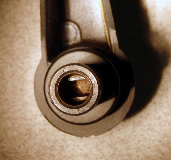

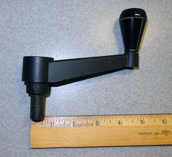

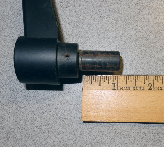

Looks like in transit, I may have lost the crank to the planer. Is this SS specific, or is there a hex key or socket that fits it? Or is $40 my only real option.
- Posts: 645
Re: About to take the plunge. . .
Shopsmith specific, as far as I know, but you might could make one. Here's what mine looks like. The earlier version was like a small steering wheel on top, but the drive end was the same. You might want to check ebay and other sites for parts like this that you need too ... planers and their parts do come up occasionally.
