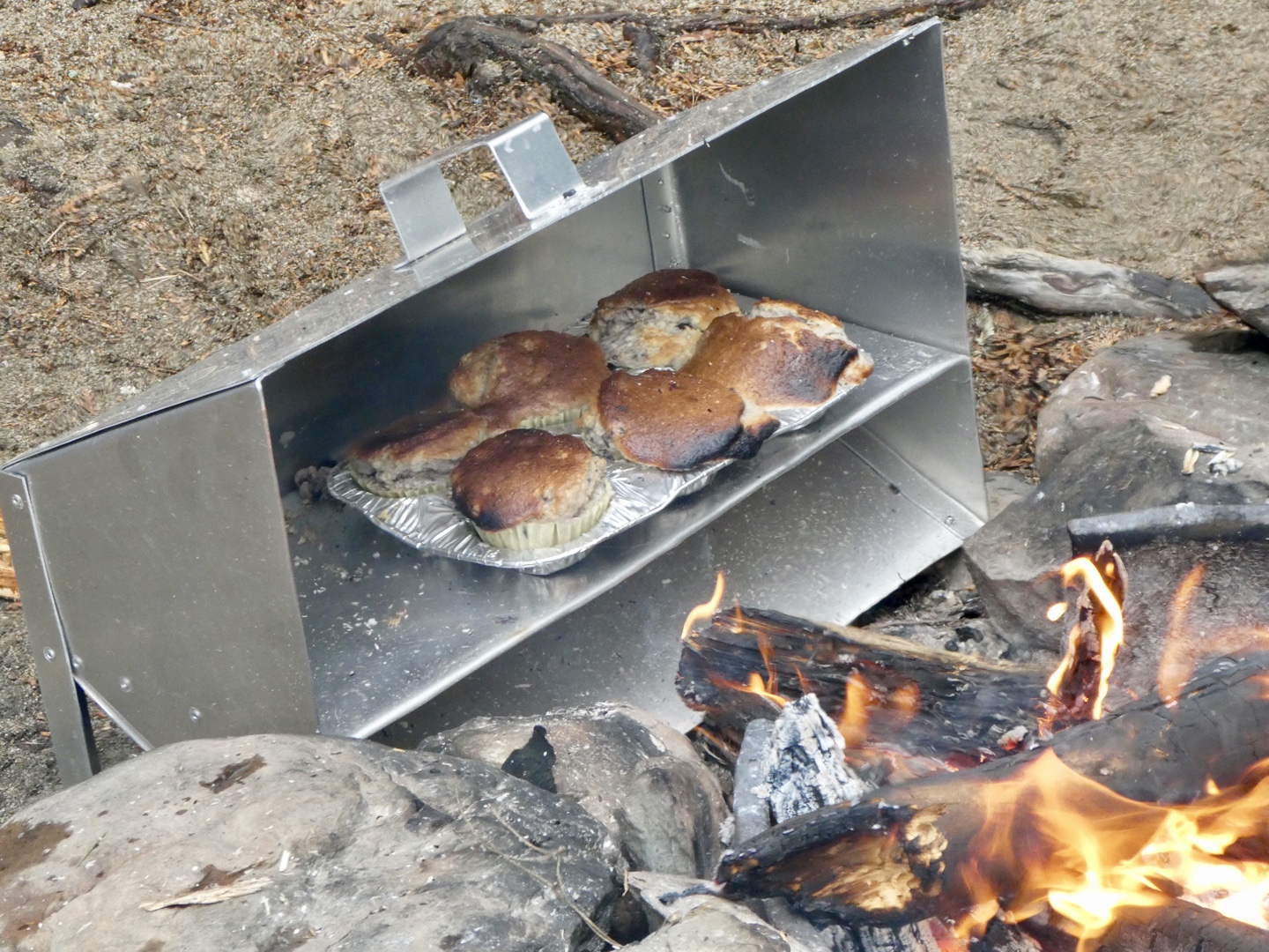

Incidentally, the reflector oven worked. Had blueberry muffins two days and biscuits another. Here blueberry muffins are cooking in front of the fire.

My brother and I howl with laughter when we remember my Dad talking about "roasting biscuits" instead of "baking biscuits." The comment took place in the house, but his mind may have been elsewhere on the Old Trail...
Then I had read a book about Axes, and just a few weeks ago read this... "Alder sticks have been called biscuit wood for instance, because their quick blaze 'lasts only for a batch of biscuits'..." .
Nice project!
