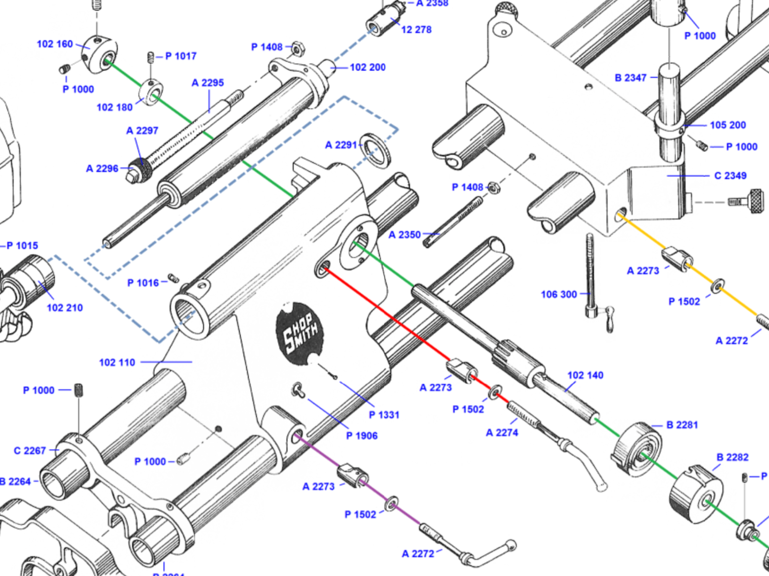

Posts: 3814
Re: A lot of general set up maintenance questions
See if the illustration below sheds any light on the subject. It’s from the 10ER owners manual, restored by Everett Davis.
Everett has restored and shared a wealth of vintage Shopsmith documents. To access them, just go to this post, and follow the “My Google Drive” link.
Sgray0090
Bronze Member
Posts: 7
Joined: Wed Feb 27, 2019 9:51 am
Post by Sgray0090 »
Yes. I am missing part 1502. It's a 7/8 inch od, 1/4 id washer. I literally just got done searching the web. Closest thing i came to was a brass cupped washer with those exact measurements. Fingers crossed and see what happens. Now what I am worried about is i took a flat washer and put a bend in it. It did not seem to make any difference. I placed it exactly where the illustration shows its suppose to go. Now I'll see if i can find that by part number. Thanks for this it is much appreciated.
