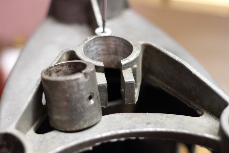

Have you discovered the pointy set screw that positions the bearing within the eccentric?

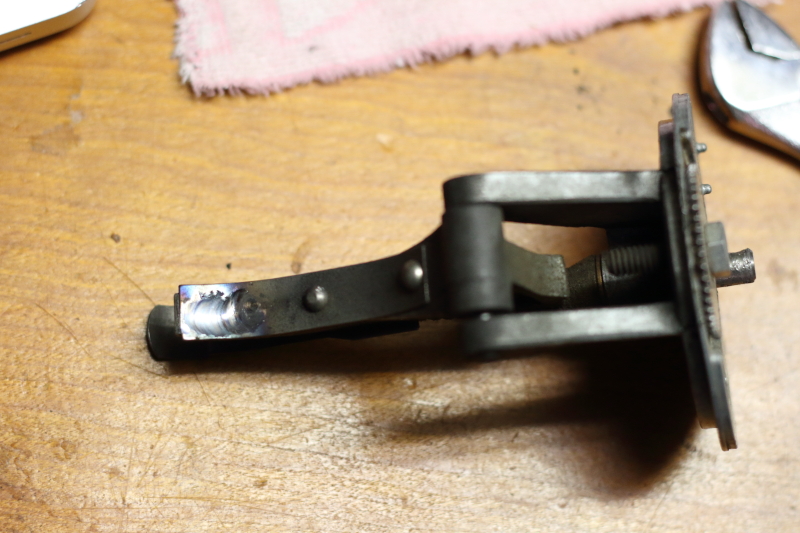

15 - the speed assembly has a badly worn metal sleeve that looks like it should be replaceable but isn't...

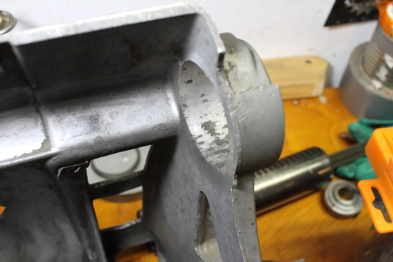

16 - eccentric looks like it was beaten inside and out, maybe to get better traction since they positioned it at 2:00? Idler pulley bearings are crunchy anyway, so new eccentric and idler

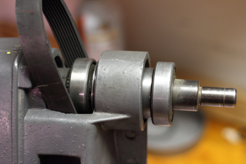

17 - two bearings on the upper assembly. Are these the bearings that SS doesn't sell? They need replaced. I was unsure how to get it out from here - do I take the bearings off or just continue to press it out?

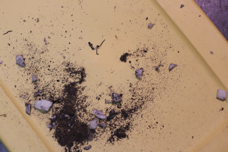

19 - the dust and pins from inside the case. Unfortunately it all went in the trash. I can dig it back out, but they appeared mangled. I needed these to re-use the eccentric and idler shaft?

- speed assembly worn?
- shopsmith-mkv-15.JPG (365.95 KiB) Viewed 11622 times
- eccentric and seat both look beat.
- shopsmith-mkv-16.JPG (287.15 KiB) Viewed 11622 times
- upper assembly bearings need replaced
- shopsmith-mkv-17.JPG (312.2 KiB) Viewed 11622 times

- debris including some pins from inside the case
- shopsmith-mkv-19.JPG (443.52 KiB) Viewed 11622 times

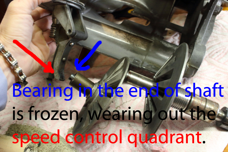

I would replace the entire speed control, but keep the old one for spare parts. The damage to the quadrant gear is because the bearing loop(yes you did find what was left of it in the motor pan as well as the missing roll pin) went south and allowed the center race and pin on the control sheave to rotate against the wear plate('sleeve'). The pivot legs are splayed as well(fixable for use as a spare). The knob shaft is boogered and IIRC you stated the shaft is also bent.

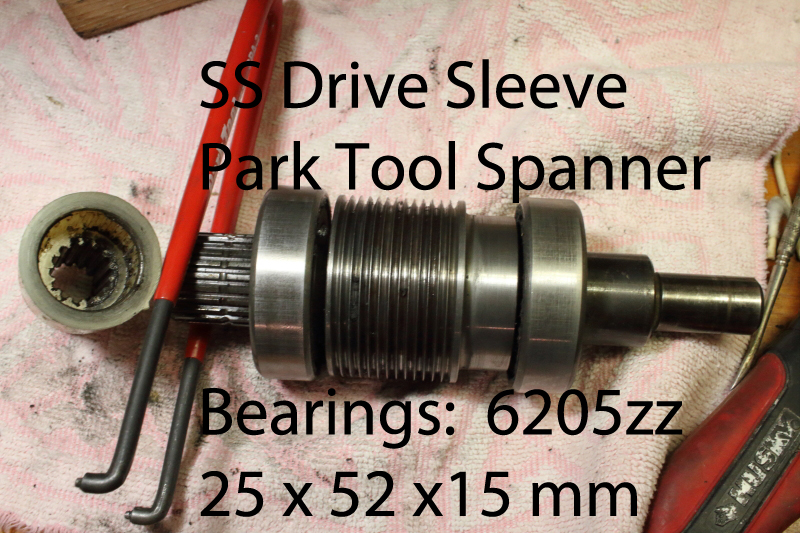

SS only sells the drive sleeve assembly as a unit. The bearings are however replaced(easy if you have a bearing puller...) Yes it 'slips' out completely, but you have to overcome crud and misalignment.

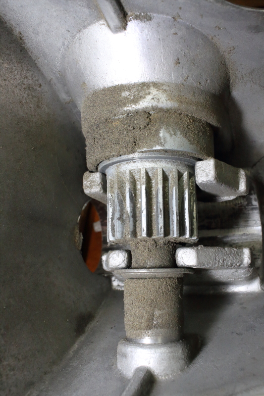

The crud in the quill rack is typical. Best to clean it out occasionally. I would only use powered graphite on any internal gearing or threads. oil/grease is a dust/crud attractant.
I think(IIRC?) the loop and pin are available separately and you MUST have them. Do check the control sheave bearing. Available also from SS only as part of the control sheave. Take a hard look at the key on the shaft for wear. Consider the idler shaft to be a Chinese puzzle re removing the key and idler sheave.

Lastly, the drive sleeve bearings are both 25 x 52 x15 mm (6205zz) I recommend the rubber seals.

20 - I see what you are referring to now. The bearing is seized at the end of the sleeved
21 - I used a Park Tool spanner wrench to separate the plastic sleeve from the splined shaft. The bearings are shot as expected.
I also measured the single bearing quill play at 3mm on the splined shaft, which was about 0.6mm at the chuck side, and probably 1.2mm at the end of the chuck, etc. This system surely counts on the other two drive bearings and the fit of the sleeve and quill shaft, but it's time to think about the total cost of this vs a new headstock.
22 - the quill drive gear is slightly chewed up.

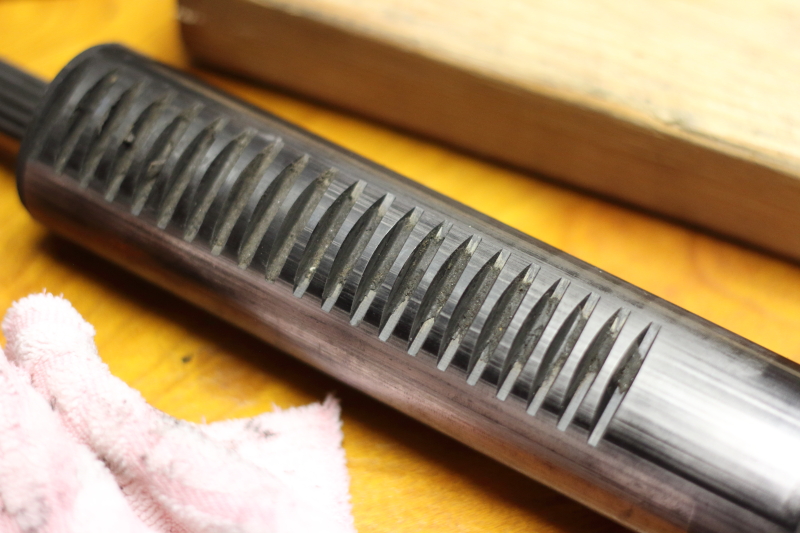

23 - Runner sleeves of the headstock are striated, packed with belt dust.
- 20 - frozen sheave bearing, damaged quadrant
- shopsmith-mkv-20-frozen-sheave-bearing.jpg (404.81 KiB) Viewed 11592 times

- quill drive gear
- shopsmith-mkv-22.JPG (401.13 KiB) Viewed 11592 times
- head shaft sleeves
- shopsmith-mkv-23.JPG (332.4 KiB) Viewed 11592 times
