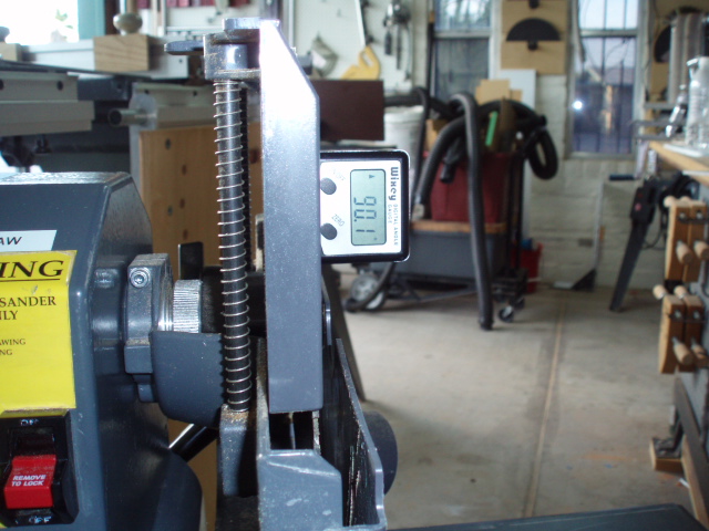

I got the Crafter's Station back in service. The problem was caused primarily because the top surface upon which the transmission mounts was not perfectly flat. I've incorporated a fix (kludge) that seems to work. Only time will tell.
A gasket was cut and placed under one edge of the transmission to reposition it.
The following pictures tell the entire story, I think. I have two tool tots to build for the grand daughters. I'll use the Crafter's Station and we'll see.

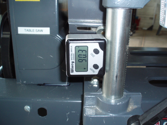

This error (90.1 degrees) is a function of the gasket. It shall remain for the time being.
[ATTACH]2006[/ATTACH]
This error (90.3 degrees) can be corrected by alignment. The allen head screw in the first image is the point of adjustment (one on each side).
