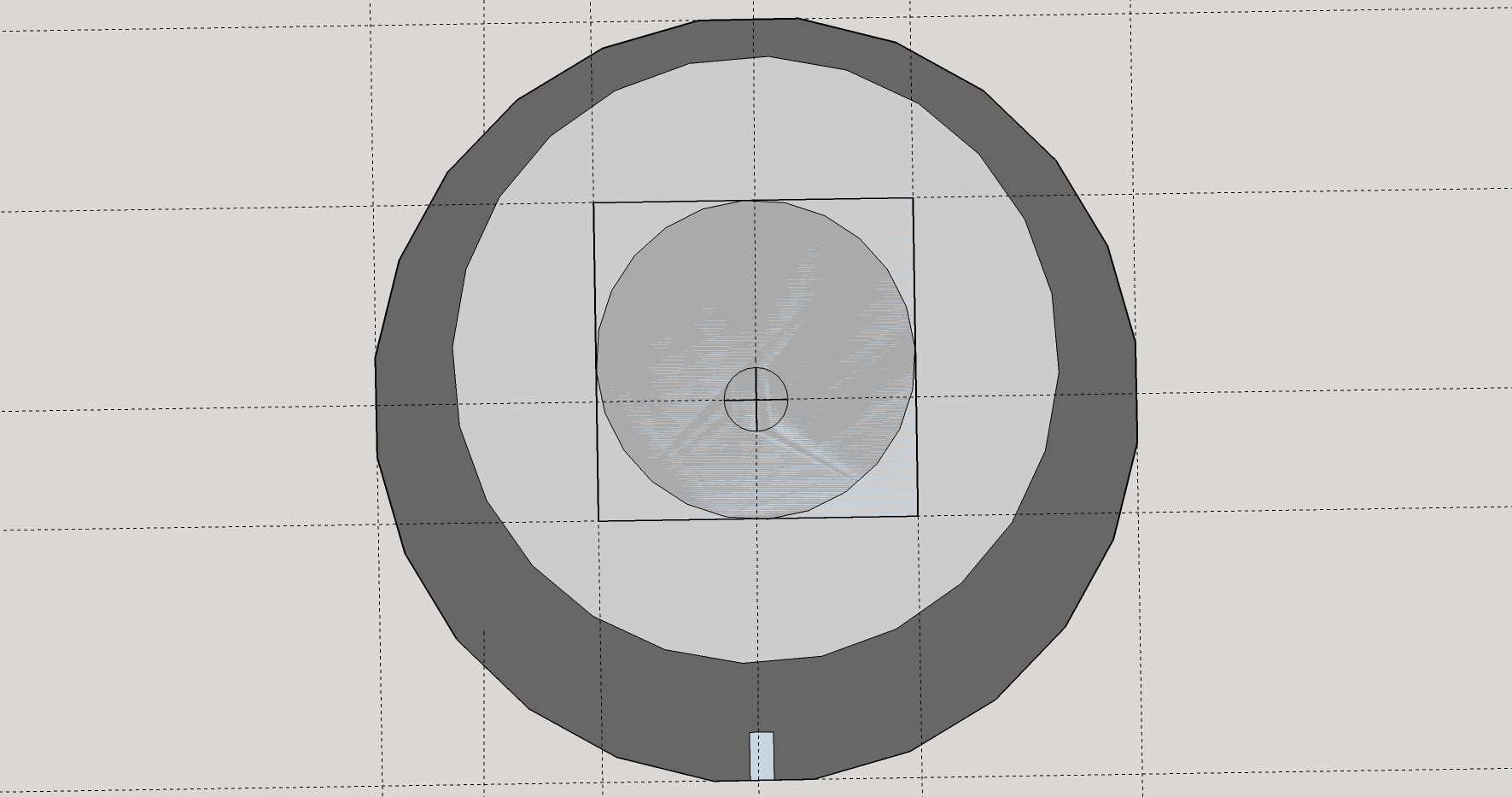

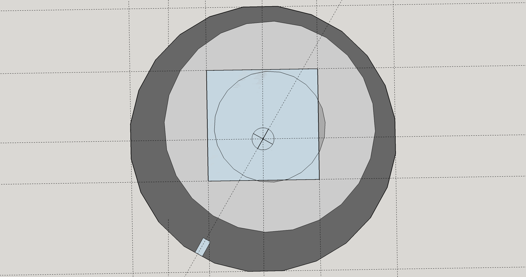

JPG wrote:The effect on shaft positioning is mostly vertical with some sideways positioning as well. The extreme vertical positions are 6 and 12 o'clock of the slot and 9 and 3 o'clock for the horizontal positioning.
The Mark 5/V uses the vertical movement to control Poly-v or Gilmer belt tension. The horizontal positioning is a byproduct and not intentional.
The Power Pro uses both, but is essentially a tension equalizer between the two poly-v belts.
I have to see in order to understand so I created these sketches to show (me) how the eccentric adjustment effects belt tension. The area of the circle that is "outside" the square box is where the poly-v belt moves to as the eccentric is adjusted. I have shown 6, 10 and 12 o'clock positions. The 12 o'clock position represents maximum tension on the poly-v. You can take it from there. That is a downward movement of the drive shaft of 5/32" as the eccentric is turned. I had problems envisioning this for awhile until I realized that the physical position of the eccentric is held constant and the shaft moves as the bearing runs around the inside of the eccentric.
It seems to me that if the eccentric is at "high noon" you are far over due for replacing the poly-v.
Minimum Tension
Minimum Tension
Eccentric at 6 o'clock (minimum tension).png (51.02 KiB) Viewed 13103 times
Eccentric at 7 o'clock.png (44.6 KiB) Viewed 13103 times
Eccentric at 10 o'clock.png (54.89 KiB) Viewed 13103 times
Maximum Tension
Maximum Tension
Eccentric at 12 o'clock.png (56.34 KiB) Viewed 13103 times
The area of the circle that is outside of the square (left and right) represents lateral movement of the drive shaft.
The cross in the center represents the axis of rotation of the eccentric.
Remember: _ The other shaft and pulley (drive shaft) is above the eccentric.
