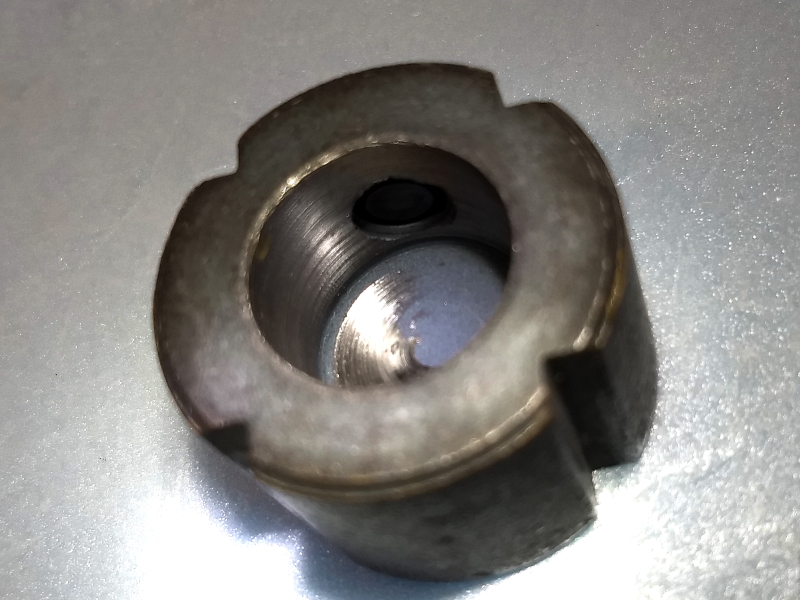

That's a good question, Dusty. My auxiliary-shaft coupler clearly has a somewhat larger ID than my collets & arbors, as it will fit onto that apparently-oversized idler shaft. But a coupler doesn't really need tight tolerances. If it fits on a spindle loosely, the set screw will draw it over to one side and lock it down. That will cause runout, but those long plastic couplers can tolerate a lot of runout, so it probably isn't a problem.
I just put your question to the test, by trying out several couplers on that idler shaft. The aux-spindle coupler from the same Mark V did not fit onto the idler shaft. But I tried four or five couplers from other machines, and the rest of them did fit. So then I inspected the coupler that came installed on the idler shaft, and discovered that it has apparently been modified. As you can see in the pic below, the ID was re-bored after the coupler had been black-oxide coated. That was not the case with any of my other couplers. So now I'm suspecting that Shopsmith got in a batch of oversize idler shafts at some point, and simply modified the couplers to fit.
Modified coupler.JPG (354.72 KiB) Viewed 18137 times

Given that you and Ed can fit chucks onto your idler shafts, it appears to me that mine is simply oversized. I'd bet that Shopsmith got in a batch of these, and just made them work instead of scrapping them.
