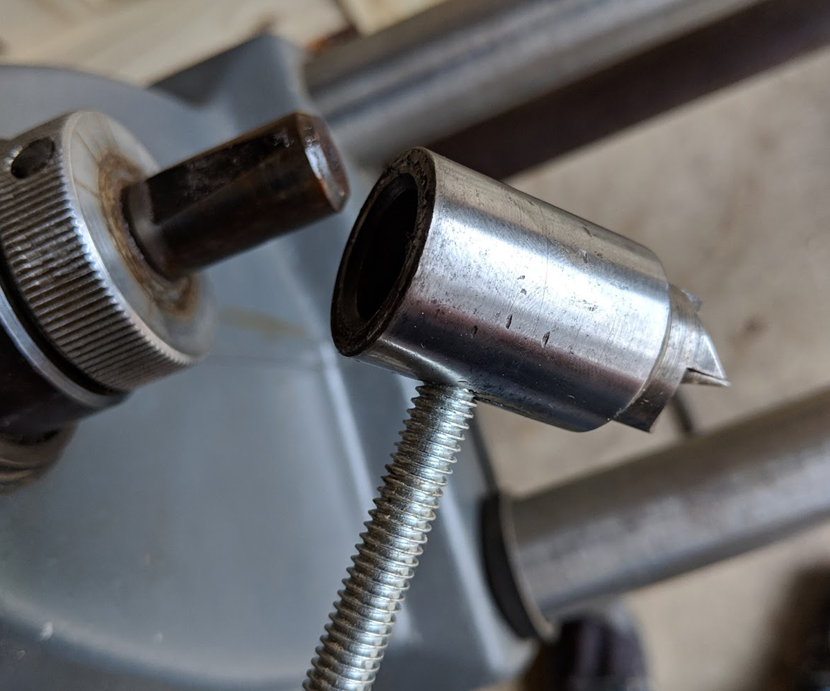

Recap:
After the soak in the PBblast / ATF It didn't seem like a whole bunch had changed, but after chucking up a scrap 4x4 post and letting it spin itself for a while on low speed (definitely shaking a bit, not exactly an evenly weighted piece.)
After taking that off, I noticed I could slip the chuck back and forth maybe 1/32 of an inch or so.. but progress is progress!
It didn't really go anywhere, but I wanted SOMETHING to go my way - so I just ended up sanding / polishing the lathe center to get a win with the machine. While working on it, I had one of those let your mind wander moments and remembered I had two pieces of threaded bar stock sitting in my backpack from my 3d printer.
I threaded it on just a bit, got some purchase, and got a little more play in it. With a bit more PB Blast and a tap from a hammer parallel to the direction of the quill - She popped off!
It took a lot of tinkering, but it's finally free and clear. Thanks everyone for the help!! I was able to the shaft up, chucked a few of the rustier pieces, cleaned/sanded/polished/waxed the drill-press chuck, the sanding disk, and a rust lathe plate as well. On to the next project!!

Great news!!!!
Apparently there were sufficient threads to make the earlier bolt suggestion work(no hammering
Quill looks undamaged. Not sure rust was the culprit. Very little apparent in the pix.
BTW congratulations on getting pix uploaded very early in your experience with this forum.
One caveat - abrasive cleaning of black oxide parts removes the black oxide.
Your spur center is an example.
