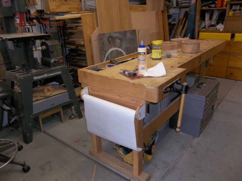

edflorence wrote:RPD...really like that English style bench...would enjoy hearing your comments on how it works for you. Always thought I would like to have one...Until that day, here is what has worked for me for a long time.

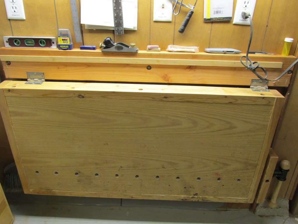

Here are a couple of pictures of my small fold-down workbench.

Hi Ron;
Thanks for the follow up.
How to hold down work while planing has been a challenge for me as well. I drilled a couple of rows of dog holes in my bench top and have a variety of devices that fit them. Sometimes I will pinch a board between the dog on the face vice and a dog on the bench top, but that will usually also require that the work also be clamped at the front edge of the bench to keep it from lifting. One of the rows of dog holes lines up with a dog in the end vice and is used for longer work. I use the Veritas planing stops and the Veritas Wonder Dogs and also a simple bent metal hold down. All of them require dog holes in the bench top, but usually some combination will work. The simple old fashioned bent metal hold down really is effective...always surprising how much clamping power it has. I have seen a lot of different designs for bench dogs but have found that the plastic dogs that come with the Workmate folding bench work really well. I also have some simple wooden pegs with wide tops that I use. The plastic and wood dogs are nice because you don't have to worry if the plane runs into them.
I also have a row of dog holes drilled into the face of the front edge of the bench to support short lengths of 3/4 inch dowels that serve as board jacks for narrow work.

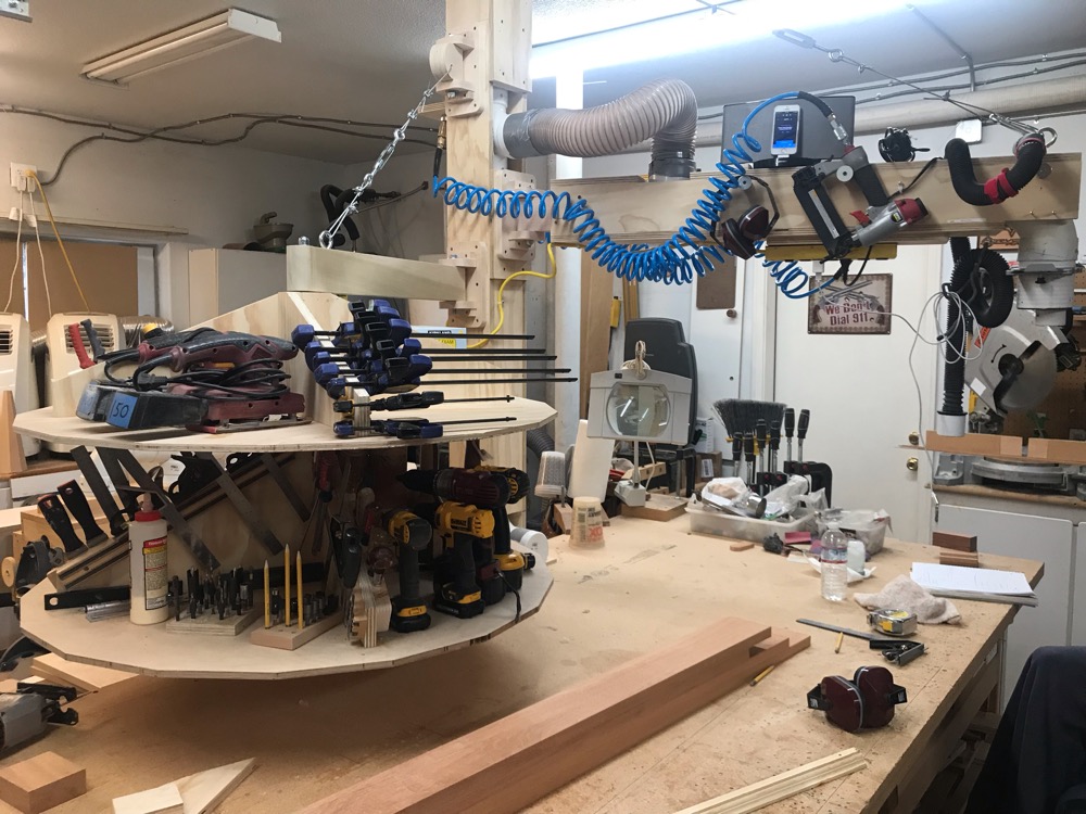

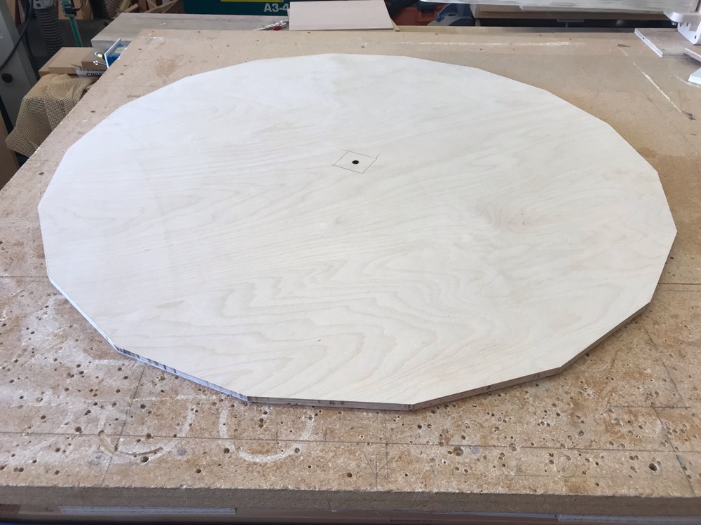

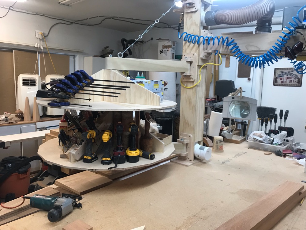

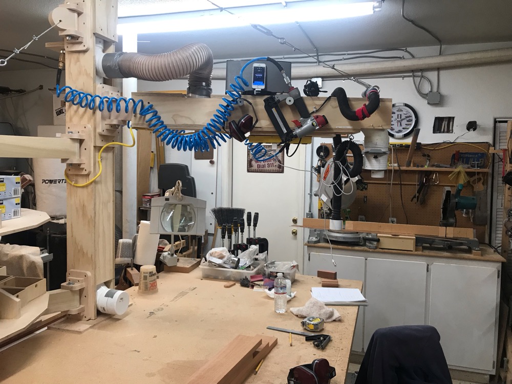

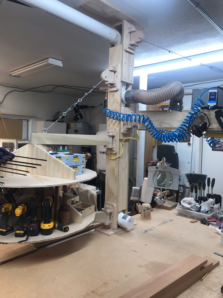

I finished my bench addition today. It’s something I have been meaning to get done for some time. It’s a combination of a dust collection boom and a lazy Susan for the tools. So far so good. All seems to be working well. It will be nice to have the tools closer and eliminate the walking over to the wall to get everything. The dust collection boom also has allowed me space to put the pneumatics and stereo etc. The lazy Susan swings out of the way to allow for full use of the bench.

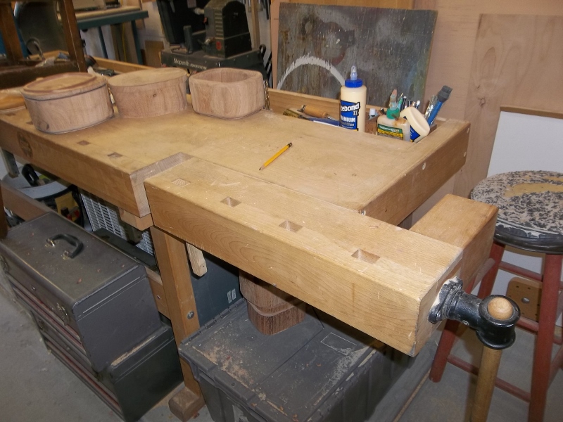

I found an old Shopsmith Bench at a Thrift store in Tucson for a $100 no way one could be built for that. I was surprised one of the Arizona boys didn't snap it up.
What I like most is the tail vice it works well an is surprisingly universal. What I don't like about it is the tool tray. I have wasted more epithets on that &%$@###! tool tray than I can count.
