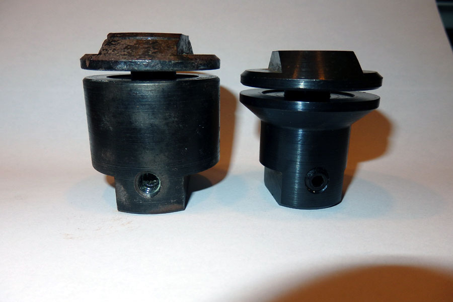

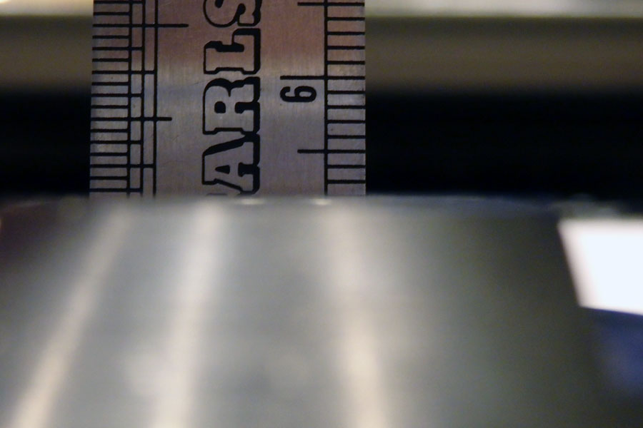

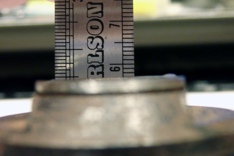

Re: Spring Purchase - Height of 500 vs 505/510/520 Arbors
My first 5/8" arbor that I bought was actually for a 505/510/520 system. At the time I bought the arbor, I was unaware of the dimensional difference. It works on my 500, as long as I adjust table carriage and quill positions accordingly. I have since bought a 5/8" arbor meant specifically for a 500, and is about 5 mm shorter. Any arbor meant for a blade with an 1-1/4" diameter hole will be shorter. I estimate the longer 505/510/520 arbor for a blade with a 5/8" hole to be 57 mm. Don't make any drawers for storing blades mounted on an arbor too tight of a fit, as blade thicknesses vary too.Spooner wrote:Another question. If i was to put an arbor in a saw blade and lay it flat in a drawer how deep would my drawer need to be for that arbor to fit?
- 5/8" arbors: For a 505/510/520 on left vs for a 500 on right

- 5/8" arbor for 505/510/520
- PA072605resized.jpg (79.65 KiB) Viewed 16547 times
- 5/8" arbor for 500
- PA072607resized.jpg (72.44 KiB) Viewed 16547 times
- Posts: 35457
Re: Spring Purchase
The difference is 3/8".
The overall length has nothing to do with the mounting hole size.
However some older arbors have nuts and have threaded posts that are longer.
57 mm is about 2 1/4".

Re: Spring Purchase
Soooo Arbor with Blade we're looking at 2 1/4"? Correct?
