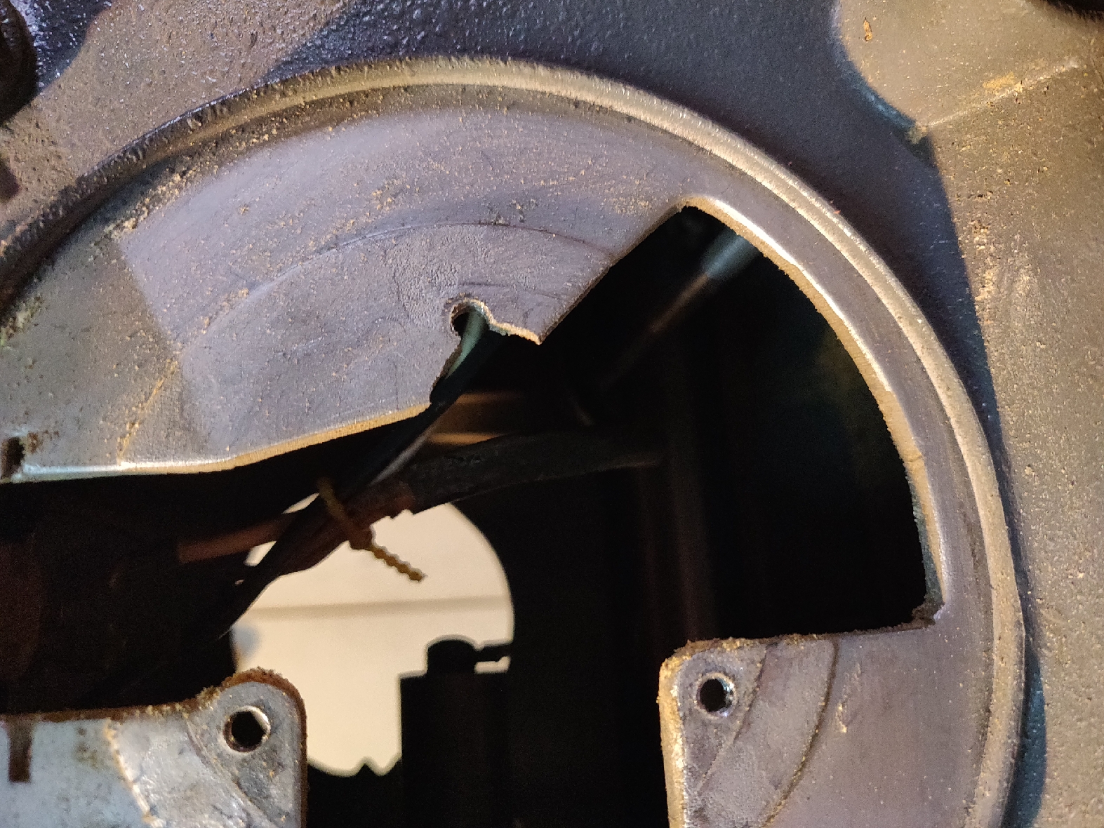

So, because I didn't want to wait another 3 weeks to get it there and back again, I took matters into my own hands. My very inexperienced hands by the way. I was able to free the cog insert from the housing on the back of the dial. Not sure that was supposed to happen. But oh well, sue me. Using 4 different drill bits, I was able to size the hole in the cog just right.
Then.......
I decided to follow up on something "JPG" mentioned. The screw holding the spring clip under my speed control dial was loose and wouldn't tighten. So when he pointed that out as a bigger problem, I looked inside the headstock to try to find the reason.
Well, the casting on the headstock was broken. At this point I'm about to start burning some sage. Maybe that will drive out the shop poltergeist who has obviously takin up in my shop. It may also drive out the smell of me.....bonus. (I didn't burn anything. It's over 90° in my shop as it is) This break by the screw also explained why my control knob was canted. The pork chop was pushing hard enough against it to force that side out.
I made a little workaround for that, but I won't bore you with the details of that.
So now that's all be fixed, cleaned lubed and re-assembled.
And now it's got a loud metal sound about 10 seconds after I turn it on no matter the speed. I am tired, so I'm going to give it a rest. But does anyone have advice on my next steps for the metal on metal noise?
Thanks!
Peter

Thanks for the re-cap, and yes, the road to learning is often full of potholes. You've done great so far, don't give up hope!
This website does not support large attachments like a video file, but others have posted YouTube videos. If you are good at making YouTube videos, you might try recording the sound and posting.
If you are not (like me), a simple video with sound could be uploaded to a photo-sharing site (such as Dropbox), and then a link created whereby anyone could view it.
One other comment ... the wires to the switch are a little too close to the speed control mechanism for my comfort ... be sure they don't contact any moving parts.

Re the noise, perform a high speed adjustment.

BTW, I LIKE YER BROKEN 'HOLE' FIX!!!

Thanks! I didn't know what I was going to do, I opened my hardware cabinet and saw that. I like that it lays flat, and it's long enough to have good contact.JPG wrote:BTW, I LIKE YER BROKEN 'HOLE' FIX!!!
There was mention by br549 about the wires. When I looked in, one in particular has started to lose it's insulated jacket. It looks like it is just breaking apart from age. I guess I will need to pull those out and tape up anything that looks bad. Then I can move them to a better spot.
Thanks
Peter

Well, I performed a high speed adjustment and now it won't move. Calling in the reinforcements again. I flip it on and it it's trains to turn, but doesn't. I quickly tried to turn the speed down to see if it would help, but no dice.
I had just finished rewiring to the terminals in the headstock(the wires were too close to the pork chop and the insulation was also disintegrating. That seemed to work.well when I turned it on. Oh well, it's been one thing after another.
I need a win guys. Haha
Peter

Is there any "noise" (motor hum) when you turn it on? If not recheck power connections. If there is noise, with it off put the Sanding Disk on and try turning it by hand.
