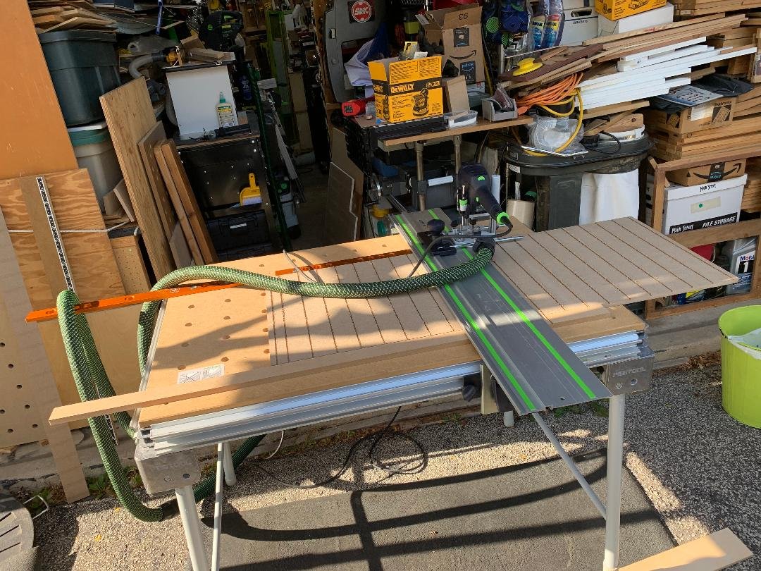

Just enough time today to cut the material to width for two more units. That amounts to 6 pieces of MDF and 6 of the std boards. Got to 41 degrees so I went for it since we have been below freezing since Sunday night.

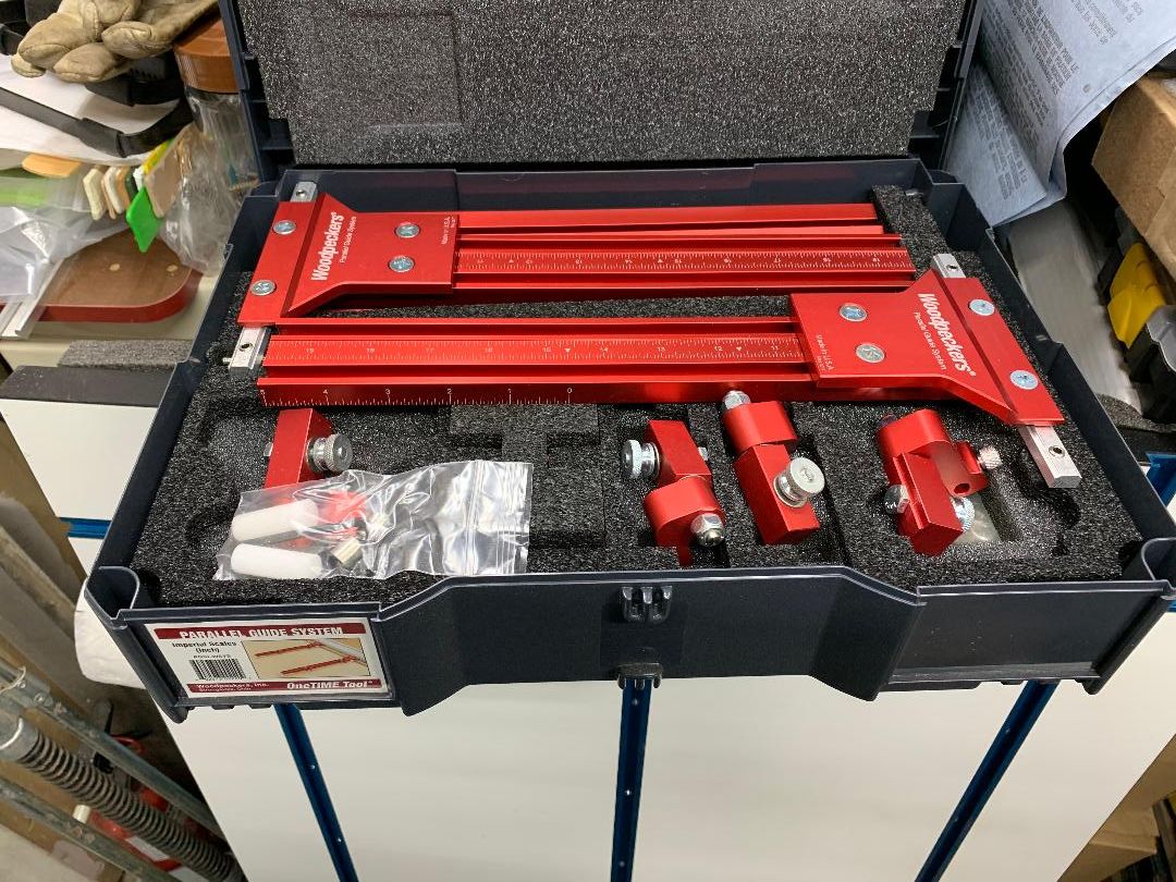

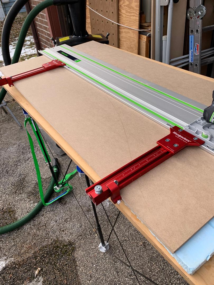

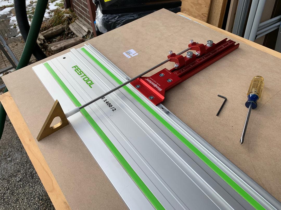

Today I went to the PGS or Parallel Guide System from Woodpecker. I'll show you a few details and if you are interested there are plenty of information out for you to find if you are so inclined.

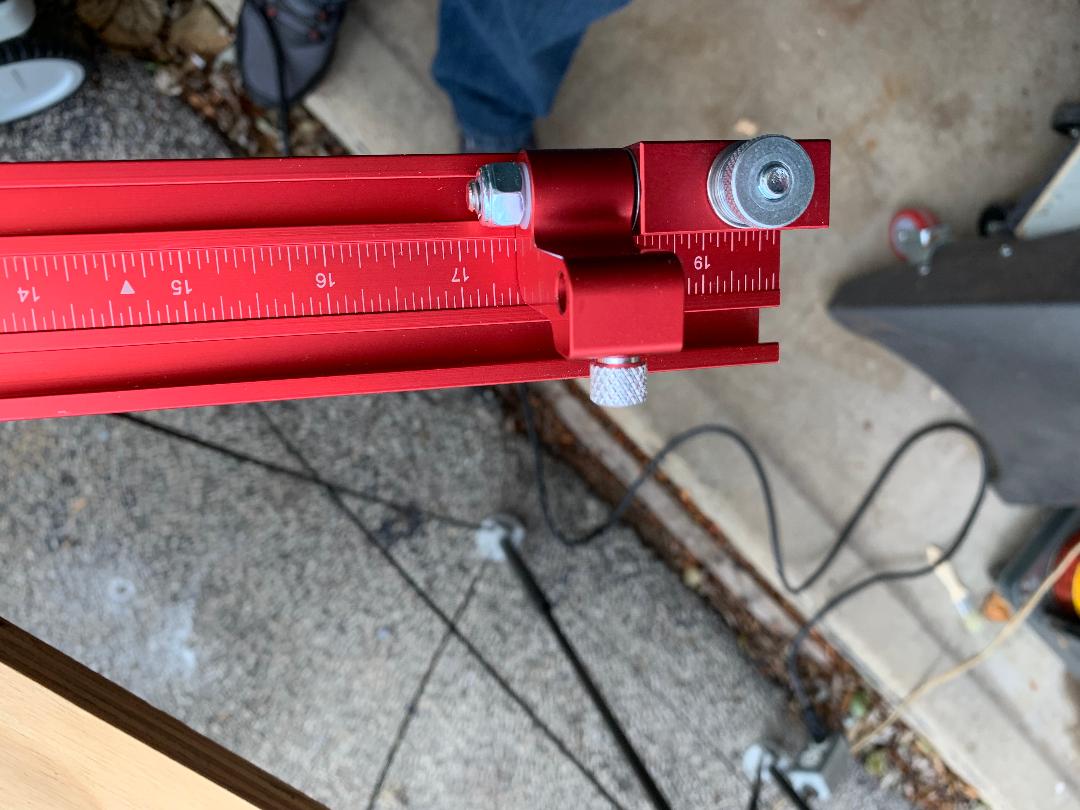

This is the system in imperial (I also have the metric tracks for it). They designed the systainer to require you to disassemble the main body brackets from the rails which then requires you to re-zero each time you put it back together. I have found it will sort of fit with out taking it apart each time, thus the reason it is packed as shown and not as intended.
Since it has been a while since I last used this and I don't recall which track it had been on last etc etc I did a quick check to make sure it still was aligned.
Then each of the tab stops are set to the dimension you want to cut.
Then you place the track dictated by the tab stops and start cutting.
I did check to make sure the cut was where I wanted it with a tape measure just as a second check.
For this project like a lot of this sort of work it doesn't really need to be "right" on, so long as all the parts are the same. Here one could be off by a 1/16" and it really wouldn't matter.

That is a very cool system. Everything they make is so well made. I am yearning for a set of their rules. The storage system is very nice also !

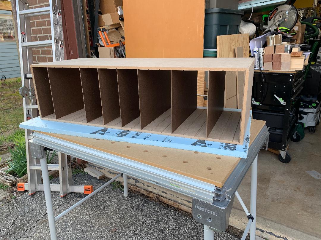

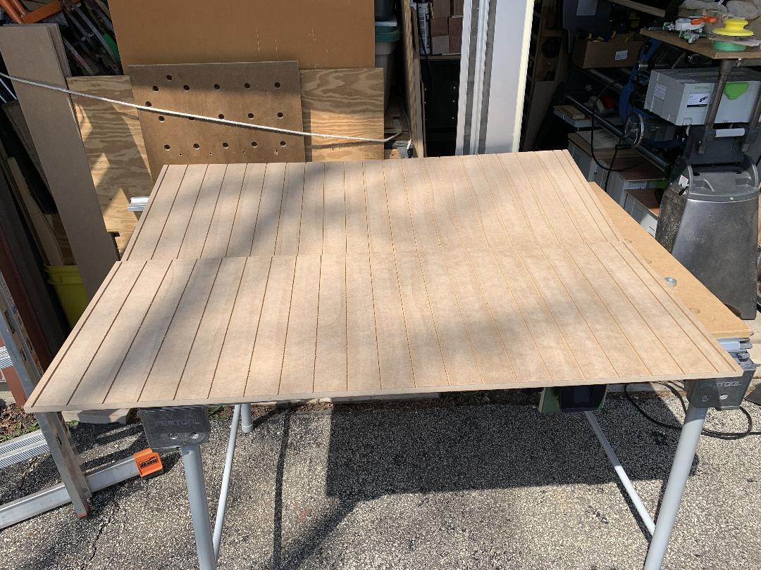

Had a little break in the weather yesterday and took advantage of it. I had cut the parts to width (or depth depending on how you look at it) previously so now it was just a matter of cutting to length. I had decided to make 2 more of these giving me a total of three. I will got from there depending on how well I like how they are working out. Something will just do better in a container while others will do fine in this system.
The longest part of the time is doing the dados, but I think I like the spacing idea so you do what you have to do. That means doing 22 * 4 dados (88).
I then did the 4 ends and another bunch of the uprights, 24 if I remember right.

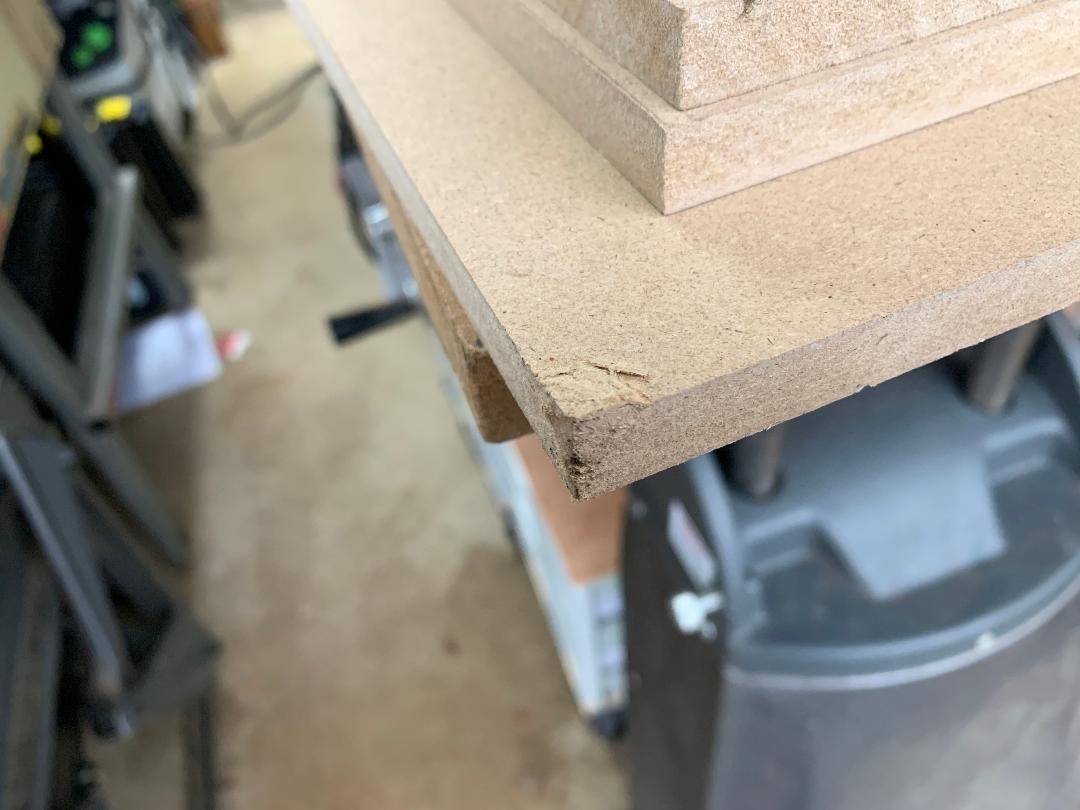

One of the ends slipped out of my hand, yea getting old I guess and of course landed on a corner.........
I could make a new part but hey this is a garage shelf project so I will make do with the damage, just stick it on the outside so it doesn't interfere.

With three of these in use I am even more convinced that this is the right idea for my shop. I just made a forth and expect at least one more, maybe two or who knows maybe more then that.

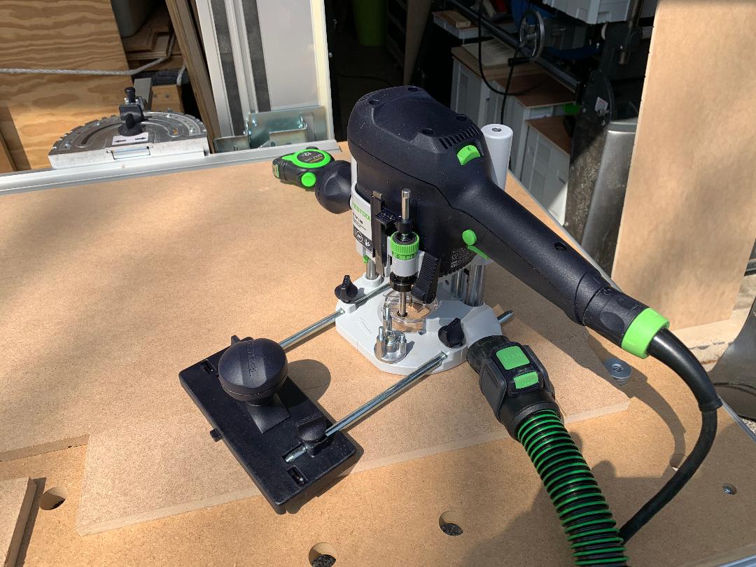

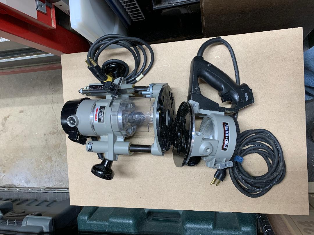

I was looking forward to trying out my new 1010 router. I found that I like it even more then expected. The downward force to plunge is less and I found that I could make a pass with just holding the plunge down rather then locking it. This saves a lot of time.
The attachment to the guide rail is different but worked just as well as the other system I have for the 1400.
This is still a bit of job doing all these dado's but worth it in the end.
I have not cut any new dividers, these are extras from the other builds. I have the material so it not a big deal but still another project I need to do to finish things up.
Right now the glue is drying. The bigger effort is cleaning off another shelf and dealing with that until things are back together. I still have things that were displaced from the other shelf units so this is an on going process.

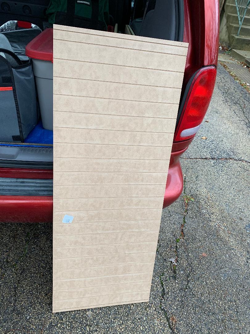

I don't recall mentioning that while the first unit dado's was done with an 1/8" bit I found it way to hard to slide some of the dividers in and out, well most of them. So the rest of the units I went to a 5/32" bit. They are a lot looser but at least it reasonable to slide them in and out with out the strain of the too tight fit.

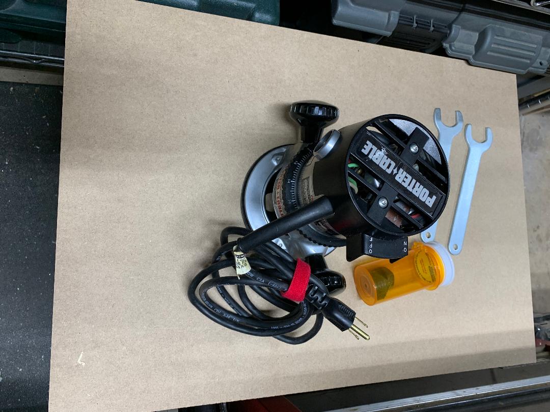

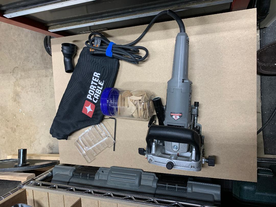

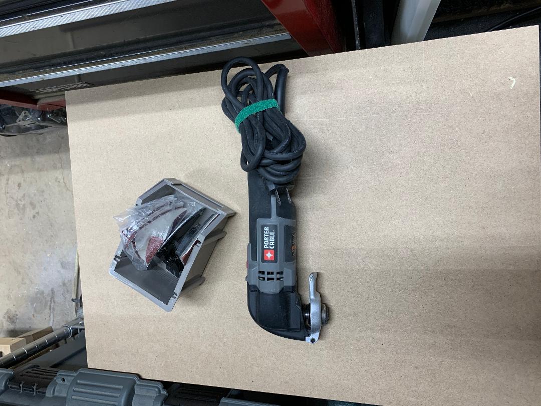

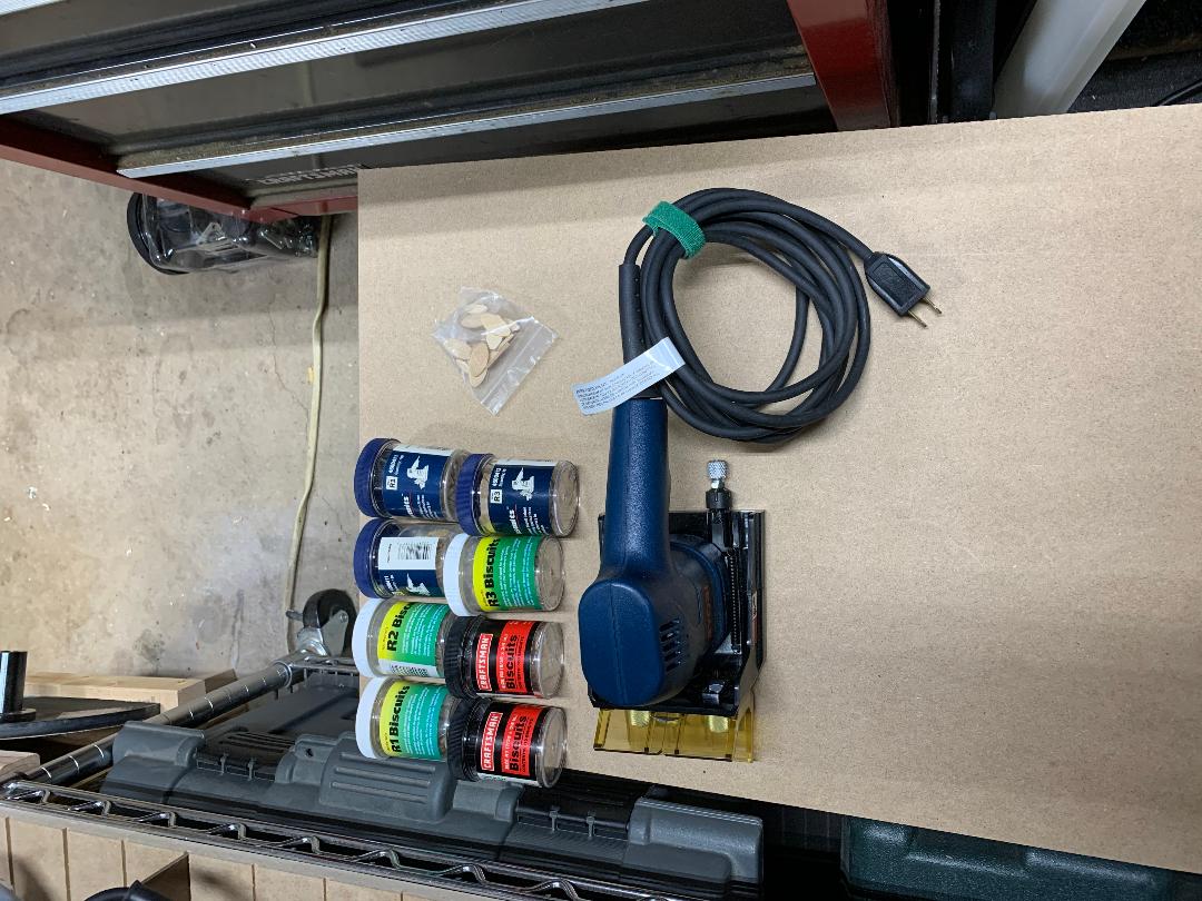

This is my first pass at how shelf 4 will be used. I will just post the pictures and if you want/need more details let me know. I just pulled the things out of the cubbyhole and shot the picture.

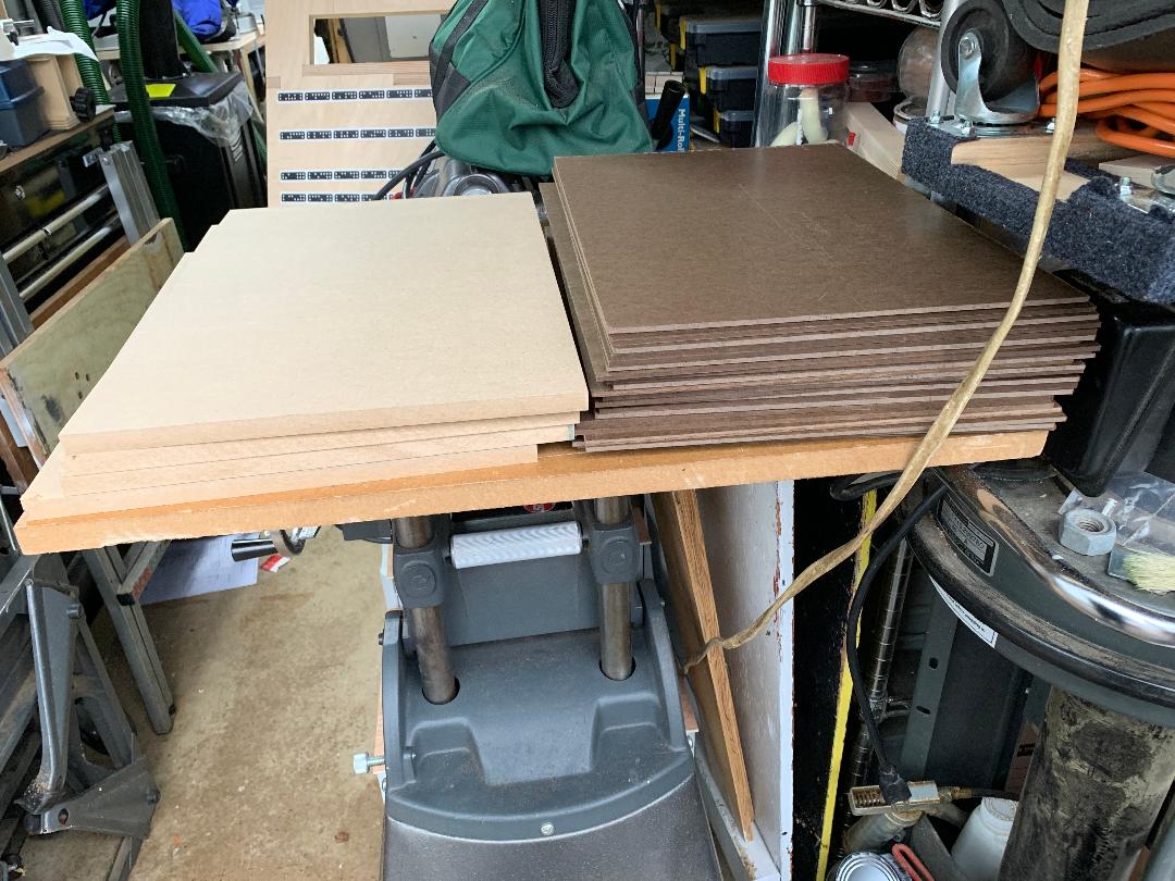

After making 8 of these I thought I was done. But then when is anyone ever done? So I now have number 9 cut and ready for assembly. And yes I have material for number 10 but that might be a ways off, like maybe spring time.
So far it has been a warm fall but weather or not that keeps going is any ones guess. Anyway I hope to have this put together and installed next week and then finish up a couple of other projects before November rolls around.
