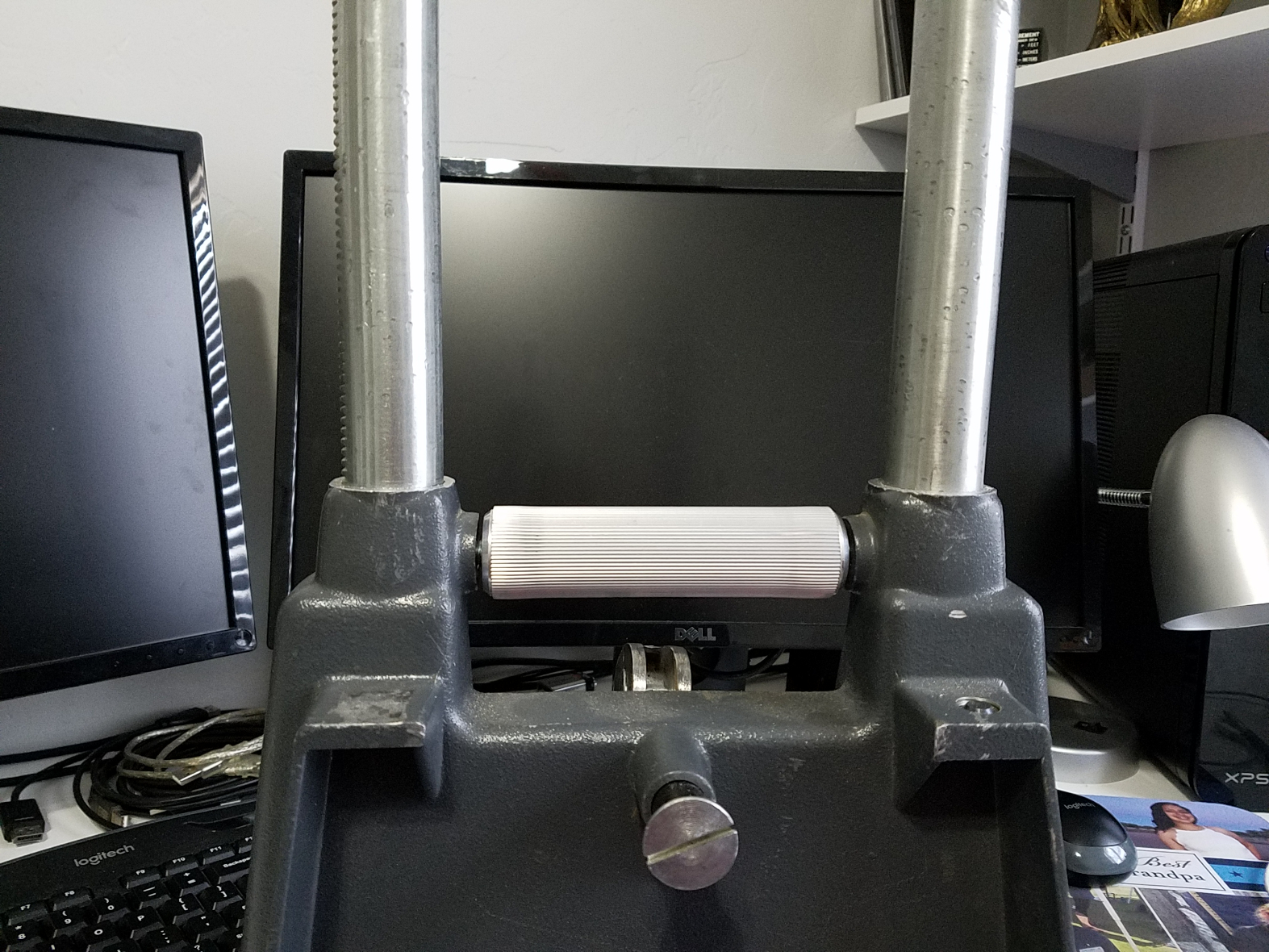

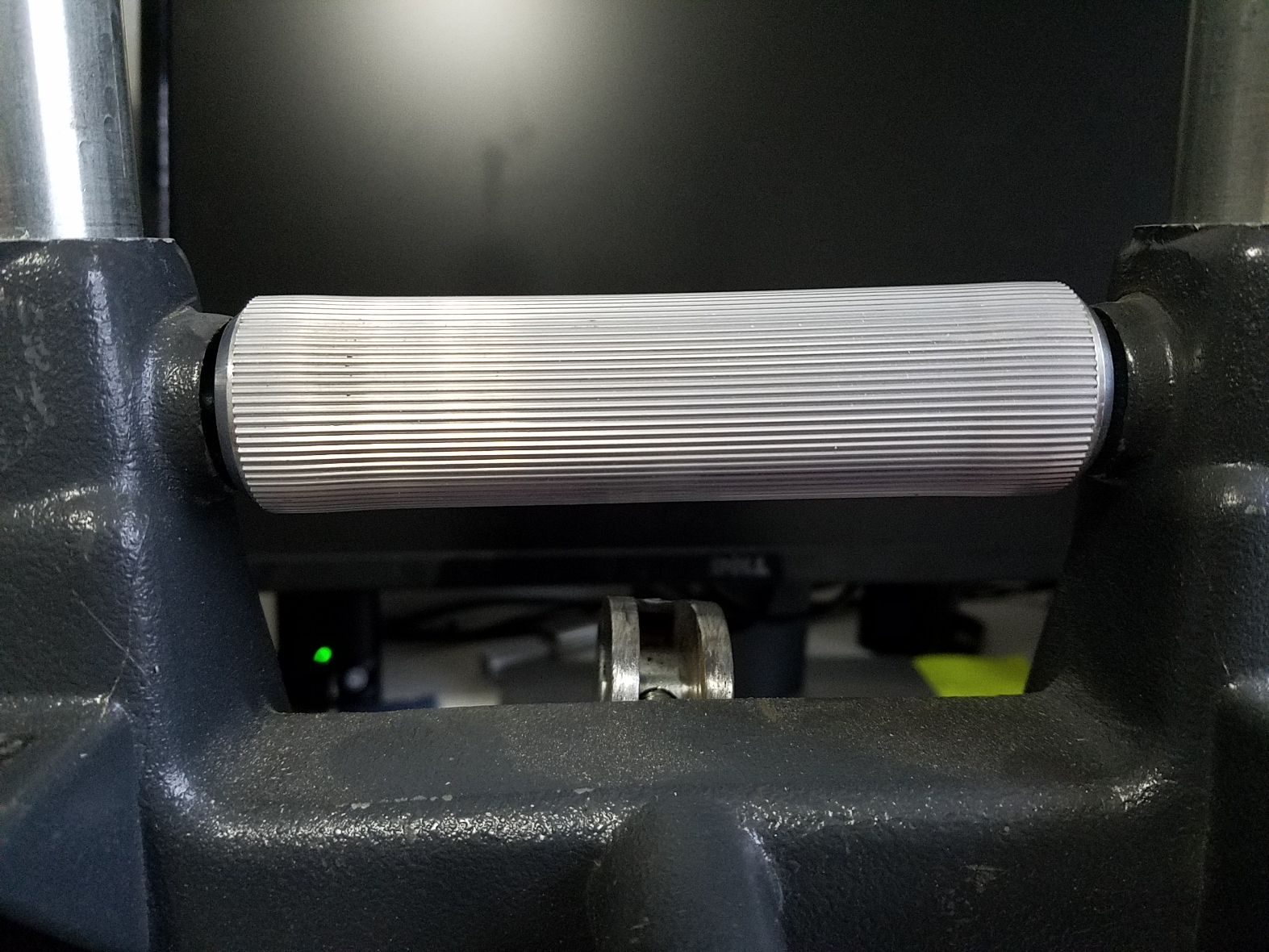

This setup clearly indicates that there should be virtually NO movement of the legs when inserted (2" here) and locked.
Main Table Legs in Headrest
Spindle Centered when Locked Locked

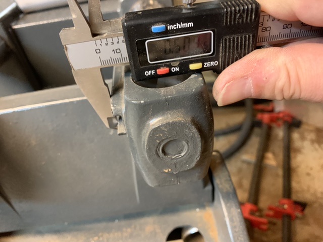

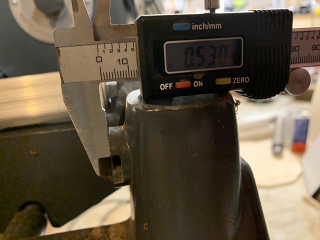

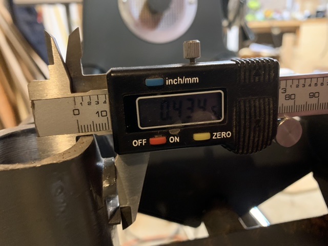

I began by taking measurements of how far the clamping mounts protrude.
Headrest end, left side as you look at it straight on from the end. 0.434 inches.

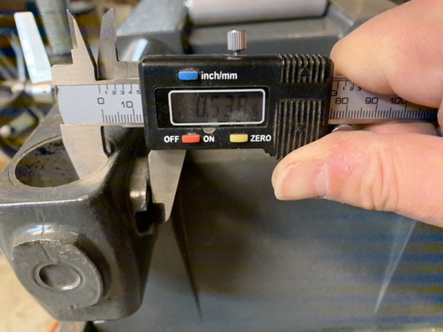

Headrest end, right side as you look at it straight in from the end. 0.530 inches.
Base arm end, left side as you look at straight on from the end. 0.538 inches.
Base arm end, right side as you look at it straight on from the end. 0.504 inches.

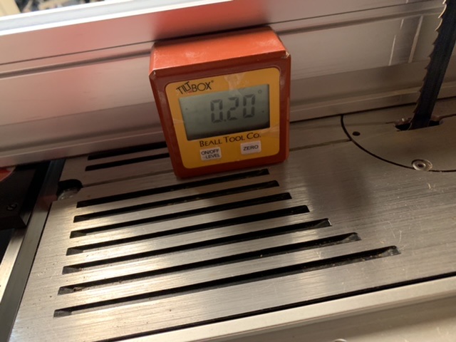

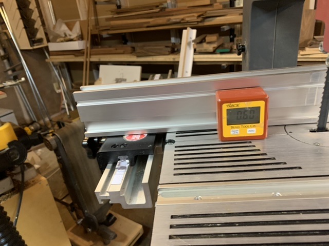

Next, I inserted the band saw into head rest end, with zero clamping pressure (the clamp was actually removed for this test. I placed the Wixey on the band saw table and against the fence and zeroed it. Then I put my hand on top of the band saw case and pushed as far inward (toward the headstock) as possible. Even though the travel at the top of the band saw seemed to be at least an inch, the Wixey only changed its reading by 0.60 degrees.

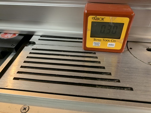

Staying on the head rest end, I adjusted the clamp to compensate for the mismatch of the depth the clamping nut must travel based on the measurements previously taken. After re-installing the clamp and applying normal hand tightening, I again zeroed the Wixey and again tried to push the band saw in. Less movement. 0.30 degrees per the Wixey.

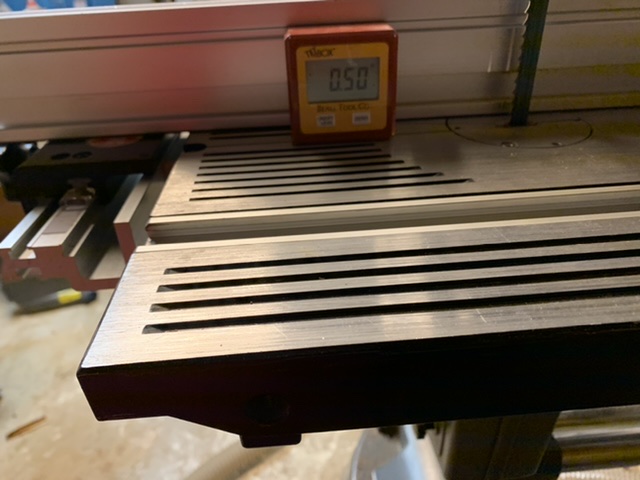

Moving to the base arm end, I repeated the same steps. Movement with no clamp. 0.50 degrees.
After adjusting the clamp to take into consideration the difference in the clamp mount depths, the clamp was tightened with normal hand pressure. The deflection post clamping was 0.20.

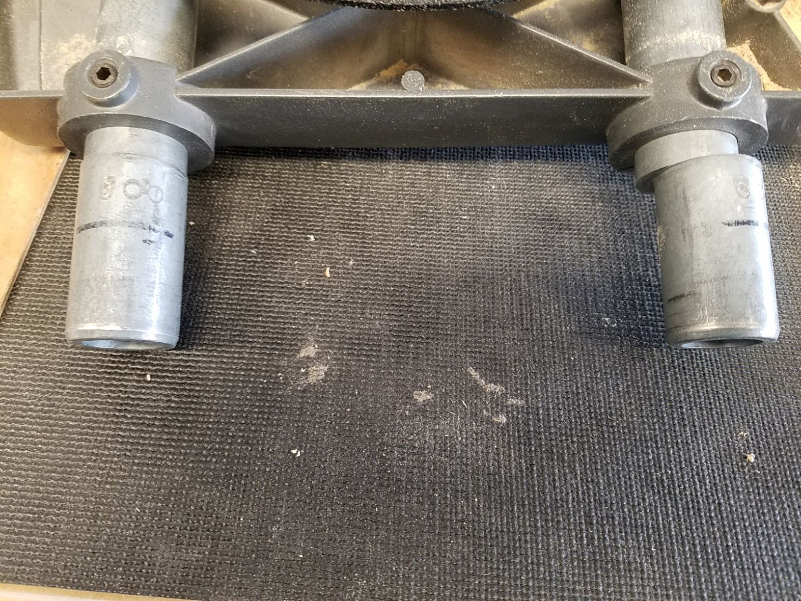

Are the tubes (straight or eccentric) inserted up into the bandsaw until they meet the mechanical stops and are the set screws tight. If yes, is there any unwanted movement of the tubes? There should be NONE. The tubes should be rock solid (with respect to one another.
If this condition exists, the wobble is not caused by incompatibilities between the tubes and the bandsaw.
If you now remove these tubes from the bandsaw and insert the other ends of each into the Headrest (or Base Arm Assembly) and secure the lock, they too should be rock solid
Eccentric Hard Against Mechanical Stop
Oter Eccentric Hard Against Mechanical Stop.
Eccentrics Secred in the Bandsaw.
